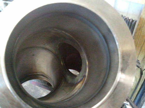

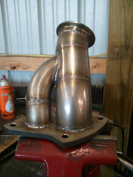

Don't forget you also ned a proper turbo flange. We had a guy in the area from the TDI crowds that I would have recommended to do your work, he was east of Lima. Welding and fab skill where top notch. He still does fab work, by day works for these guys,
Click to view attachment by night he'll do side jobs, but he's in Richmond Michigan now.
Click to view attachment And the inside, dudes got talent, my welds look like
to his.
