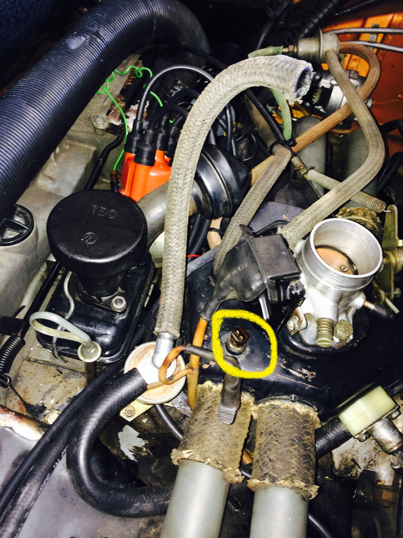

http://members.rennlist.com/pbanders/djetparts.htmThanks for the site link. It is indeed a great site. Here is a pic of the electrical plug on the plenum that is disconnected. If this is the Air Intake Temp Sensor, are these things available?
....and yes, I'm embarrassed that my engine is worn looking, but it is 38 years old!

In reference to your engine photo, trust me we've all seen much worse. That is the air intake temp sensor and I'm sure someone will have a good one if you post a WTB ad in classifieds here. I'm guessing that it's an issue in your wiring that's causing your problems. The wires and connectors all get pretty baked after all those years and Jeff Bowlsby makes great replacement harnesses for our cars. I believe the Anders
link has the procedure for testing that sensor to determine whether it's ok or not so you may want to do
that before buying another. For wiring, a quick thing to do is to check and clean all your connections and grounds and see if that improves anything.
