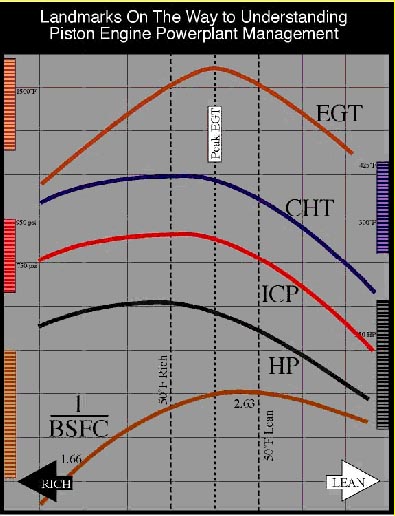

Avoid hanging out in the 14.7 - 15 - 15.5 zone (this is the death zone). One can go leaner when under part throttle cruise as high as 16-17 and see lower CHT's but only if your using a vacuum advance distributor. If your using a centrifugal only distributor shoot for 13.2 (+-.5) across the board.
This chart shows how CHT's and AFR & vacuum advance work. The dashed line in the middleis 14.7 stoichClick to view attachment
