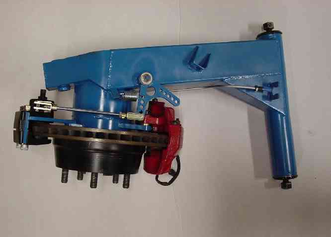

There are many ways to skin the cat.
Tangerine racing offers one way to do it in a complete package:
http://tangerineracing.com/brakes.htmI relocated the brake cable brackets on the trailing arm so as to have a straight pull on the bell crank. The bell crank pivots in a bronze bushing from Lowes inside a weld on bushing purchased from
http://www.aa-mfg.com/. This all slides onto a bolt welded to the trailing arm acting like a stud. I never took any measurements, but may have more pictures. One thing for certain, the block that the brake shoes rest on and the bell crank pulls against must be reinforced. Otherwise it will fail.

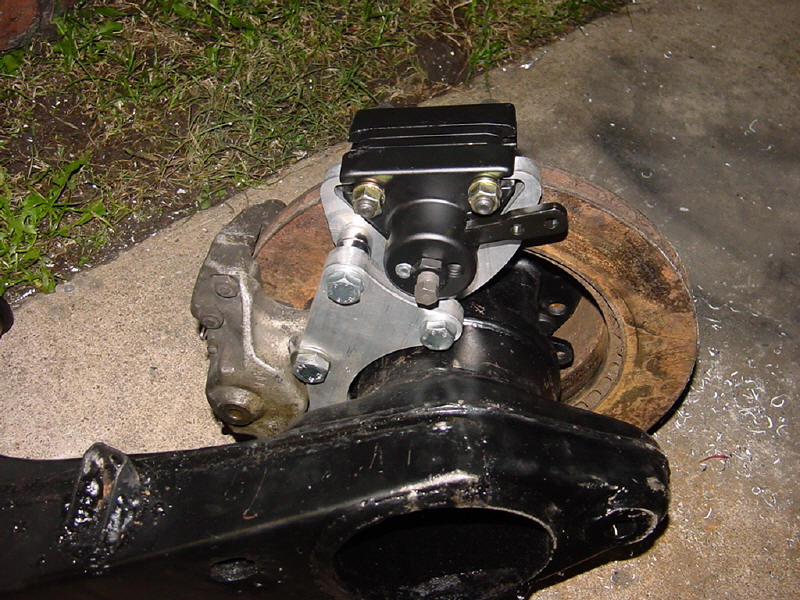

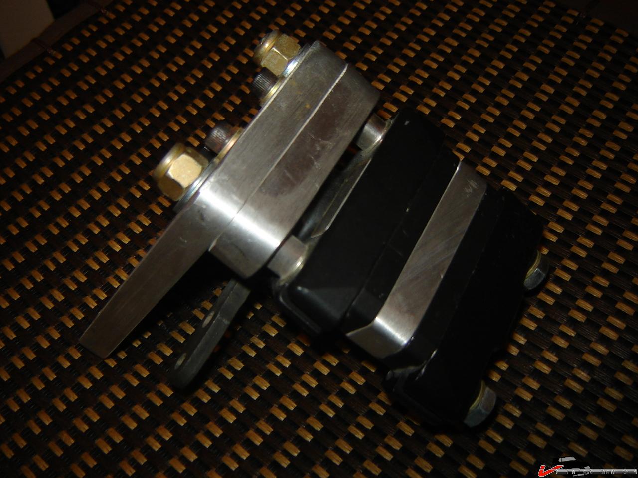

Use one of the Wilwood spot calipers and create a thicker spacer to accommodate your rotor. I've got a place near me that can waterjet a spacer in pretty much any profile.
tomeric914
Dec 12 2013, 01:18 PM
Stumbled across these images as well:
And this one with the wider spacer mod mentioned above. In this case it was for Corvette brakes:

ClayPerrine
Dec 12 2013, 02:12 PM
QUOTE(tomeric914 @ Dec 12 2013, 01:18 PM)
That first picture is mine. I have one piece of advise for you.
DON'T DO IT! I tried it, and Wes Hildreth tried it on a car owned by Mike Floyd here in the DFW area. We learned that if you set the park break with the rotor hot, you need a big assed hammer to get them to release. There was no spring we could find that was strong enough to pull the pads loose.
Wilwood used to sell that setup for their Ford 9 inch and Chevy 12 bolt disk brake kits. They have all been replaced with an internal drum brake like the 911 park brake. I called them and asked, and they had the same problem we did.
Click to view attachmentYES!!! That's what I need.

The second picture is of mine. I read about the sticking pad problem, but have yet to experience it....Knock on wood! I too called Wilwood, and the guy I spoke with heard of no such problem.
