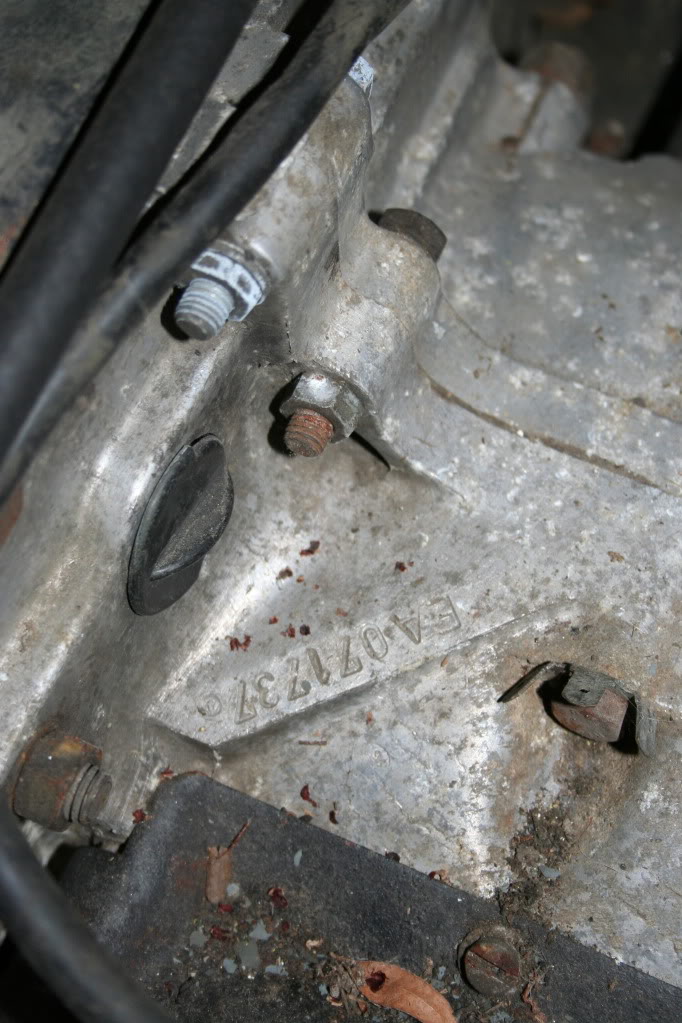

ky914
I thought I had a 2.0 since that was the badge on the back. However, I learned that I actually have a 1.7 from the engine number.
If the engine starts with W, EA or EB, it is a 1.7. EC is the 1.8. GA and GC are the 2.0 4 cylinders.
