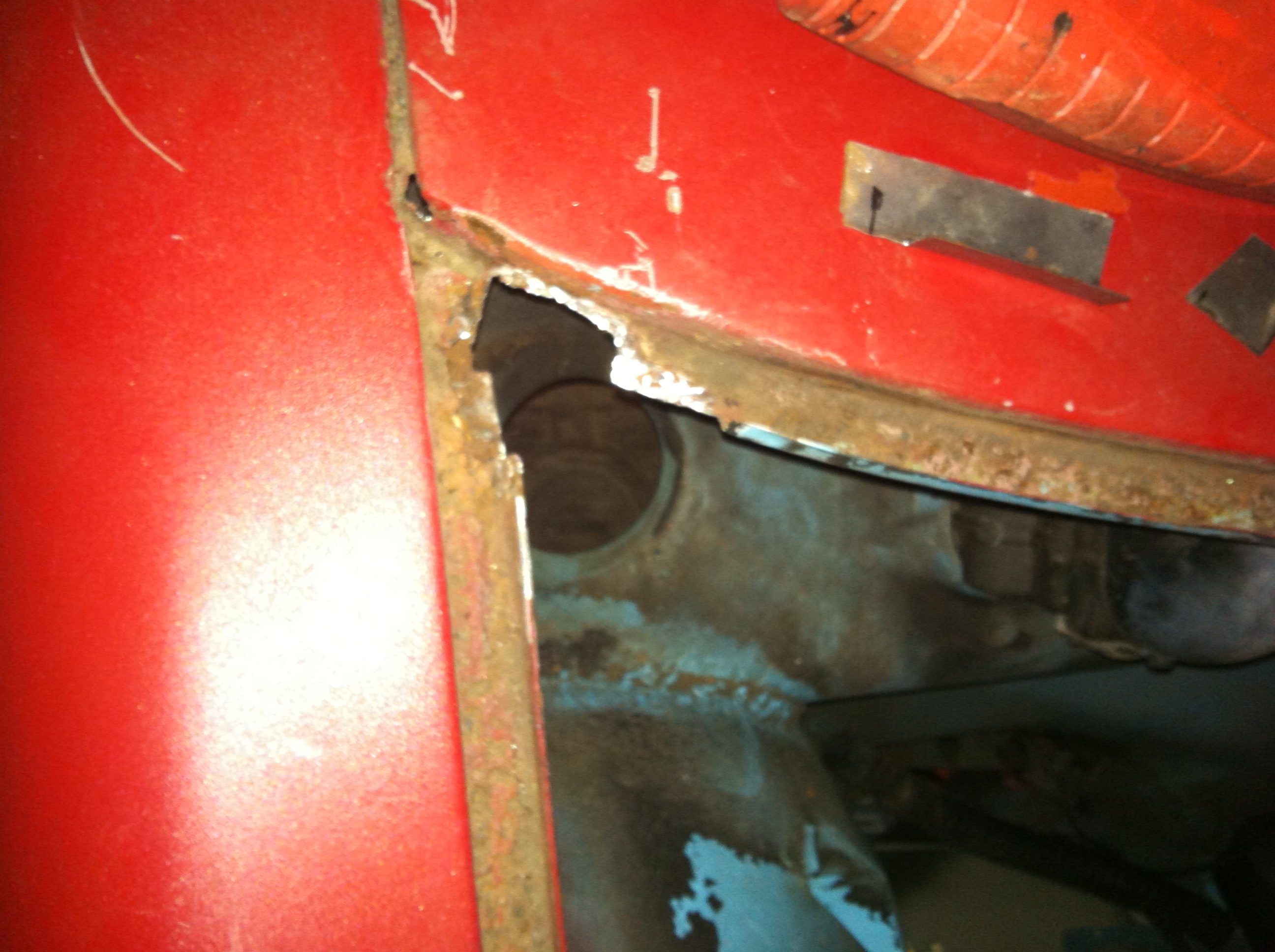

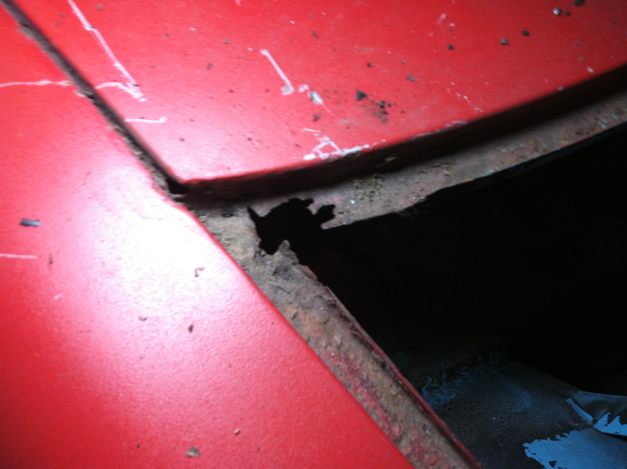

So my front trunk at the top corners has rust issues - go figure. Can someone please measure the vertical hight of the edge of the seal trough, on a car with one in tact, for me?
I cut out the rust, and I am not fabricating pieces to weld in, only my corners are completely rusted out and I am not sure how high to bend the vertical edgo on the trough.

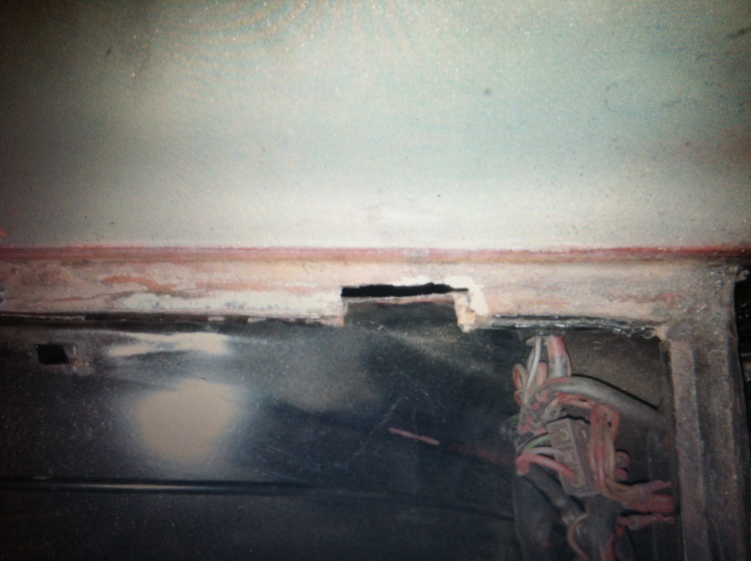

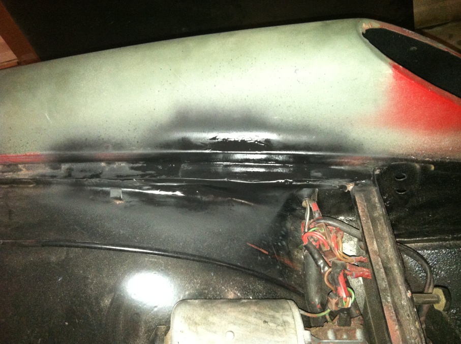

So I am happy with the results....

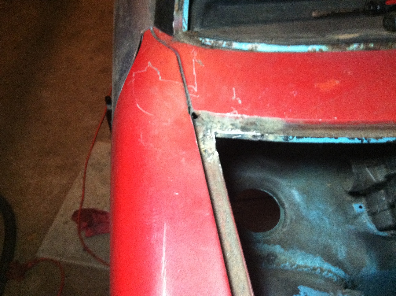

other section....I still have more sanding and primer to go...
