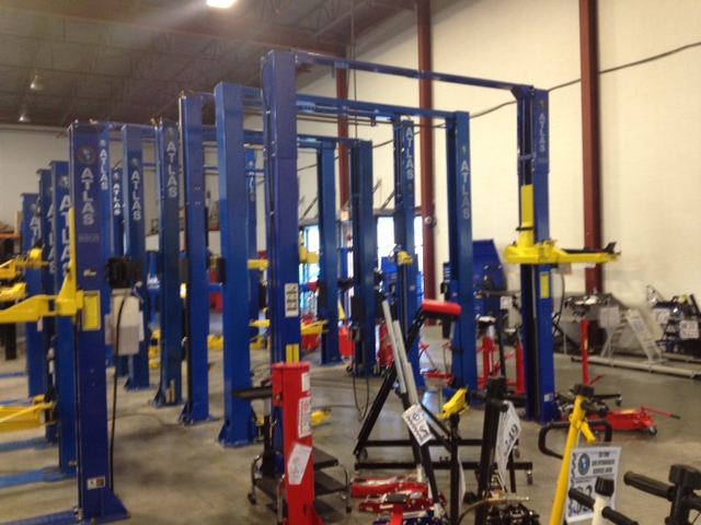

Okay, here we go. If you're a car guy this is "Lift Heaven", better known as the Greg Smith Equipment Sales, Inc. showroom in Delaware. This is where we picked up 2 BP 8000 lifts.

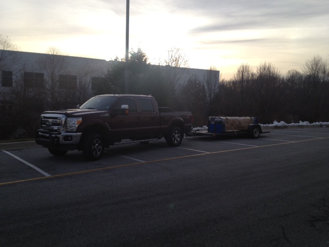

dcheek
Dec 27 2013, 07:32 PM

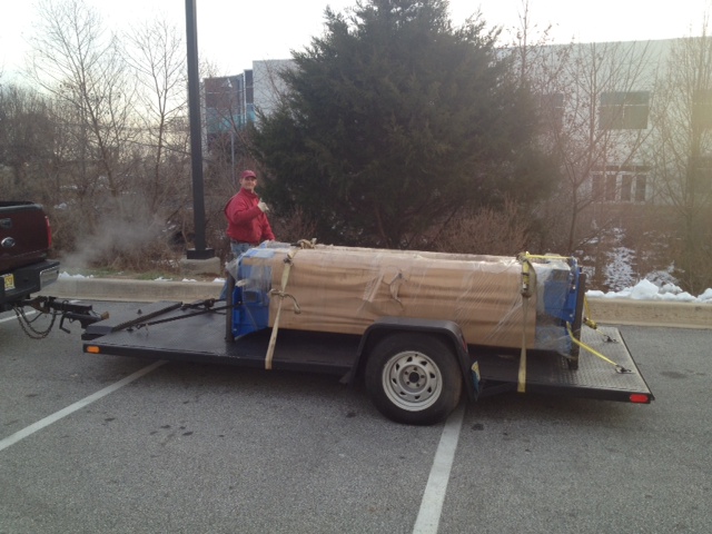

Here we are loaded and ready to go. They are VERY heavy, about 1300 lbs. each. The workers at Greg Smith expertly and carefully loaded them on a car trailer with a fork lift. It was up to us to secure them for the 2 hour trip back home. My good buddy "Popeye" offered the use of his F 350 Ford pickup along with his trailering skills, and another car buddy Humberto let us use his trailer. This project would have been a lot more difficult (and more expensive) without there help. Thanks guys!
Click to view attachmentClick to view attachment

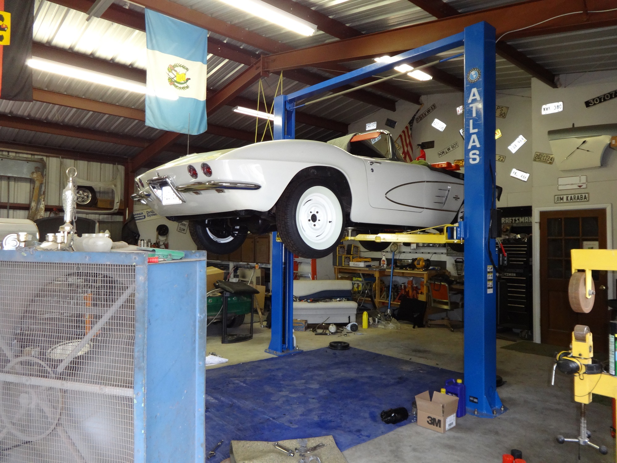

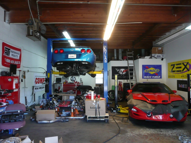

My Corvette bud (Kohle) just got one of those installed in his shop. Nice lift
EDIT: Snapped a shot today (12/28)

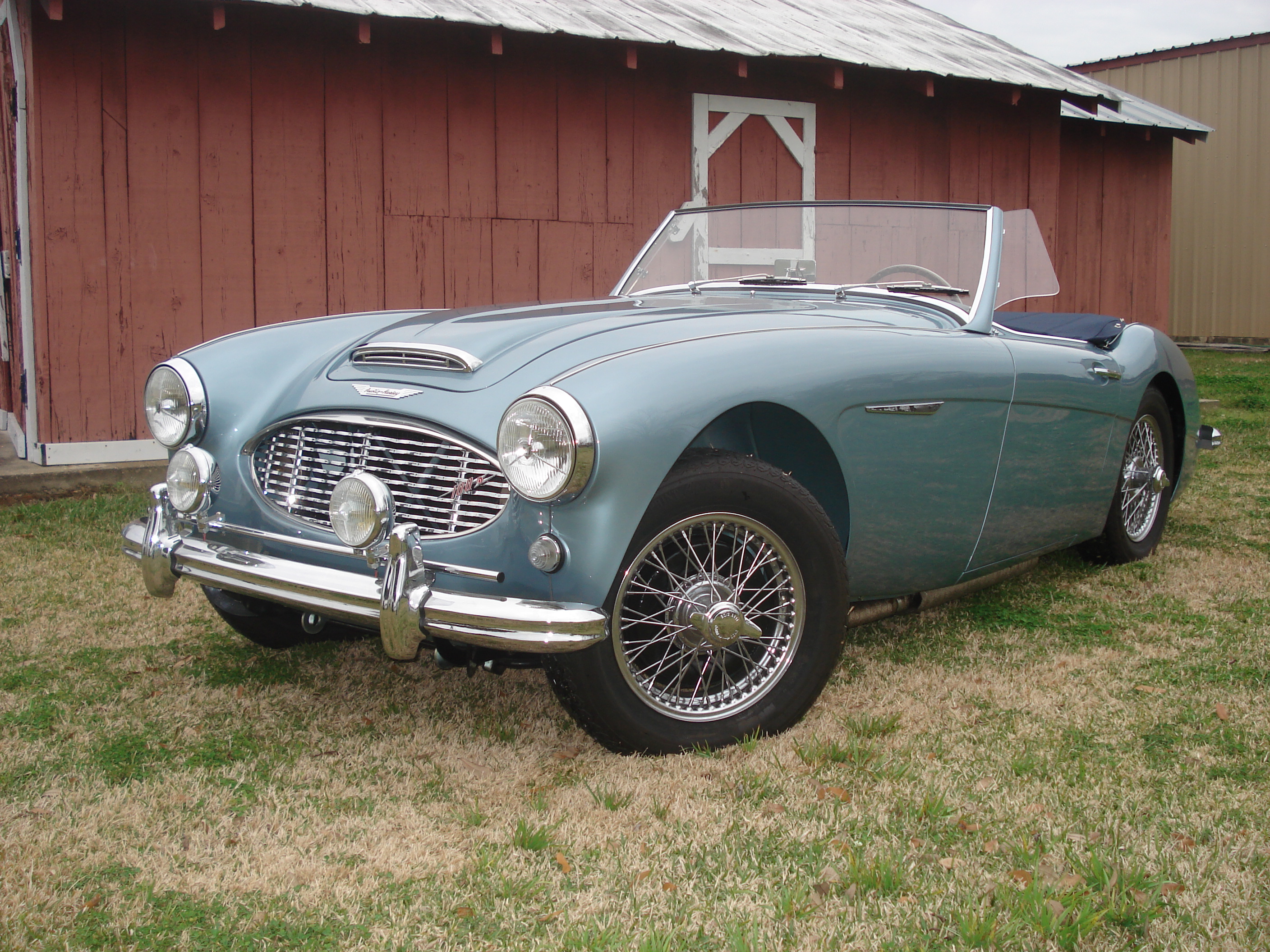

Dec 28 2013, 12:50 AM
Austin Healey clock?
zambezi
Dec 28 2013, 01:02 AM
Yup, my last one was the original door of my 1953 Pre-A 356, but I let it go with the car when I sold it because I felt it should stay with the car. This is the original front fender from this car I finished last year.

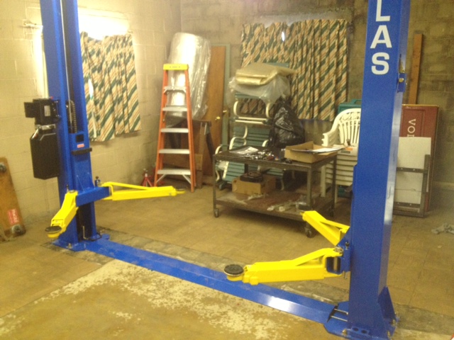

The lift installation is done. My electrician wired it up this week and I lifted the first vehicle Thursday night. Other than a few minor adjustments, everything went pretty smooth. As I might have mentioned before, the directions aren't that complete which added some time to the project. We installed another lift yesterday and it took only 2 1/2 hours, not counting the unpacking. You will need a minimum of 2 people, preferably 3, to hoist the posts to a vertical position. Anyone contemplating installing one can contact me with any questions.

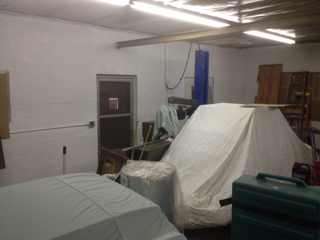

dcheek
Jan 30 2014, 02:50 PM
4 gallons of primer, 18 hours of wire brushing, vacuuming and application of primer. Now ready for finish coat.
