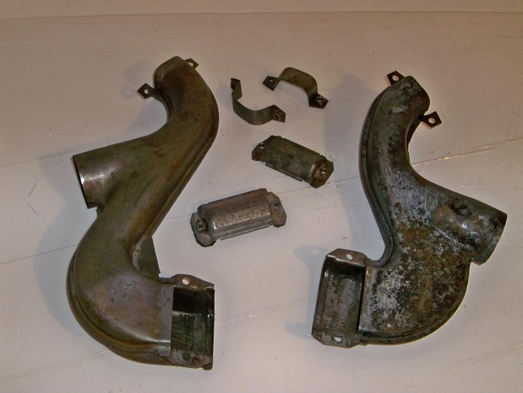

I am looking for a source of just the gaskets that go to the heater flapper bits.. maybe I will make my own.
As great as this picture is the gaskets are not clearly pictured in the photo. They go with the small rectangular flappers
and attach to the the "s" pipes ( "Y" pipes?) with the "c" shaped clamps.
Car is running real good, just need heat!
(btw, Photo credit and thank you to Rich in the PNW for letting me borrow your picture from a parts for sale/ wanted thread, Thanks Rich!)

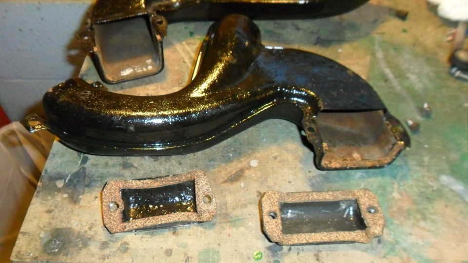

saigon71
I made my own out of medium thickness cork gasket material purchased off Ebay. They were glued on with hi-temp gasket adhesive. It took some time to get them right but they turned out nice. If there was another reasonably priced solution at the time, I would have bought them:
