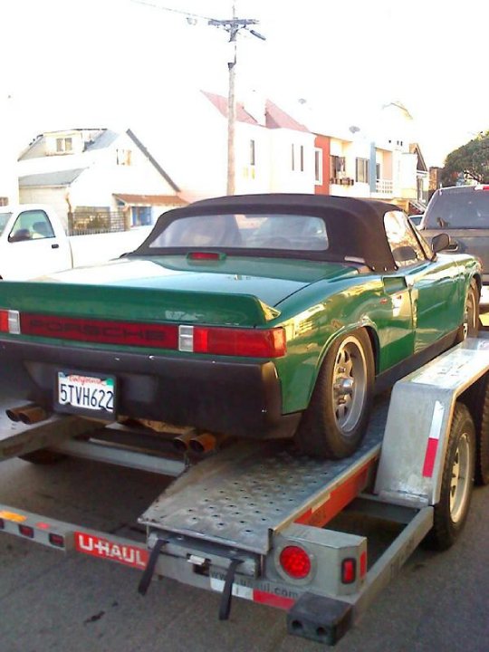

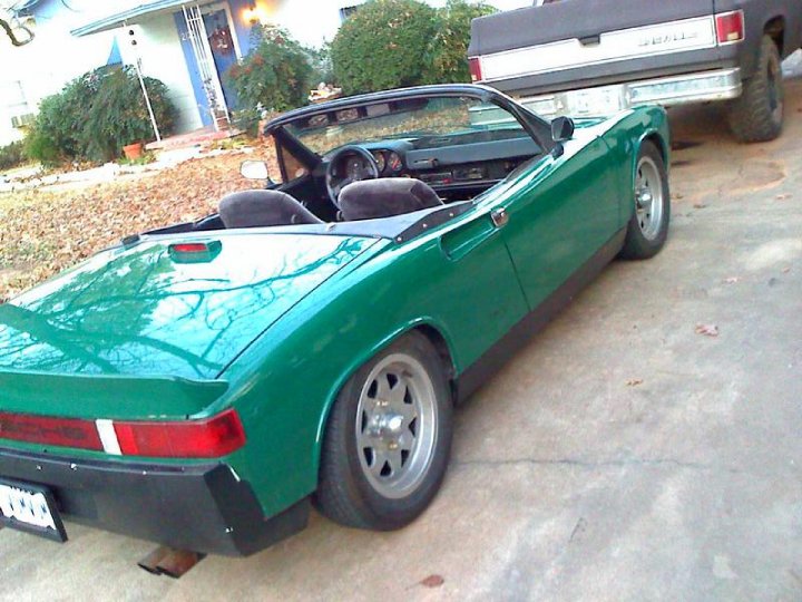

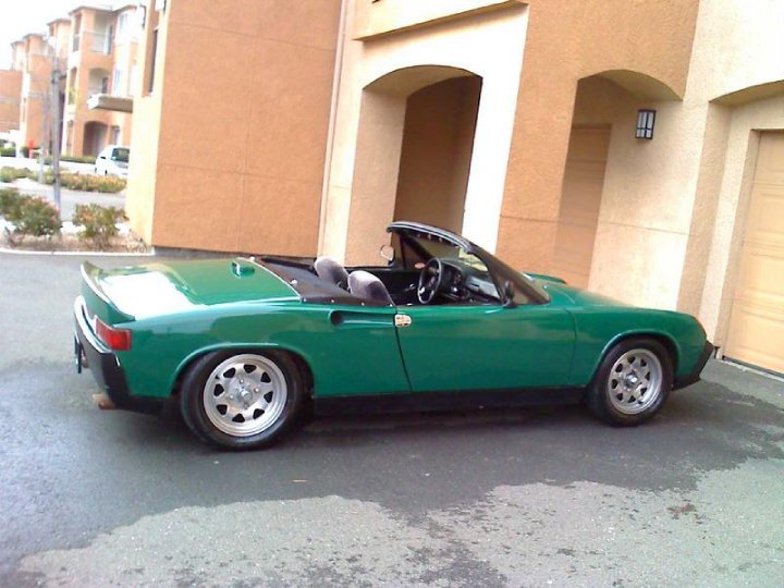

This is my 914. I bought it in San Francisco back in 09. I haven't been able to find any info on this convertible conversion and was wondering if anyone knows anything about the kit or if they recognize the car.
r_towle
Beach Boys Racing made a kit like that.

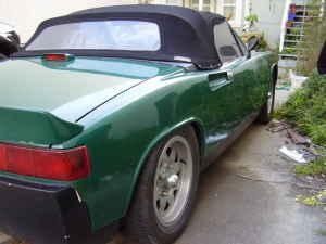

Im not home to get those pictures but it is very simple. there are 2 clips on the plastic behind the engine that the bottom bar of the top slides into. in front of the engine, beside the head rests are 2 bolts were the frame of the soft top pivots. and 2 tabs with quick pins on the top of the windshield. the deck lid is an insulated and carpeted piece of plywood held down with 2 allen wrenches. the top has to come off to access the engine. so being as I park it in my shop I leave the top off and drive it when the weather is nice.

if I remeber correctly the two tabs are bolted to the top of the window frame instead of welded. The forawd rod on the soft top has 2 pins on both ends of the window that slide through the holes on those tabs, then slide the quick pins on like you use on a 3 point tractor. the rear body work should be easy but im not sure how one would go about leaning the windshield back further. the soft top could be reproduced by anyone with a torch, conduit bender, hammer, anvil, some round bar, and sewing skills. I might be able to get you specific pics if I am able to go home tomorrow.

Those air scoops behind the door handles are very cool. Several years ago someone on The Club board was going to make them, but....

It's amazing how the look of the "boxy" 914 is transformed to a slick looking car with the loss of the targa roll hoop.

I have got some detailed pictures of we're the top connects to the rear and windshield. I also got some questions on the scoops. They are fiberglass and look very simple to make I didn't have a tape but looked to be about 1' 1/2" long and around 3-4" tall with a 2-3" inner hole. I need to fix the one on the drivers side but I don't have a problem reproducing any of these parts in future trade for parts or cash. I can reproduce the convertable frame and cloth top too. If anyone serious is interested let me know. I will post more pictures later tonight.
