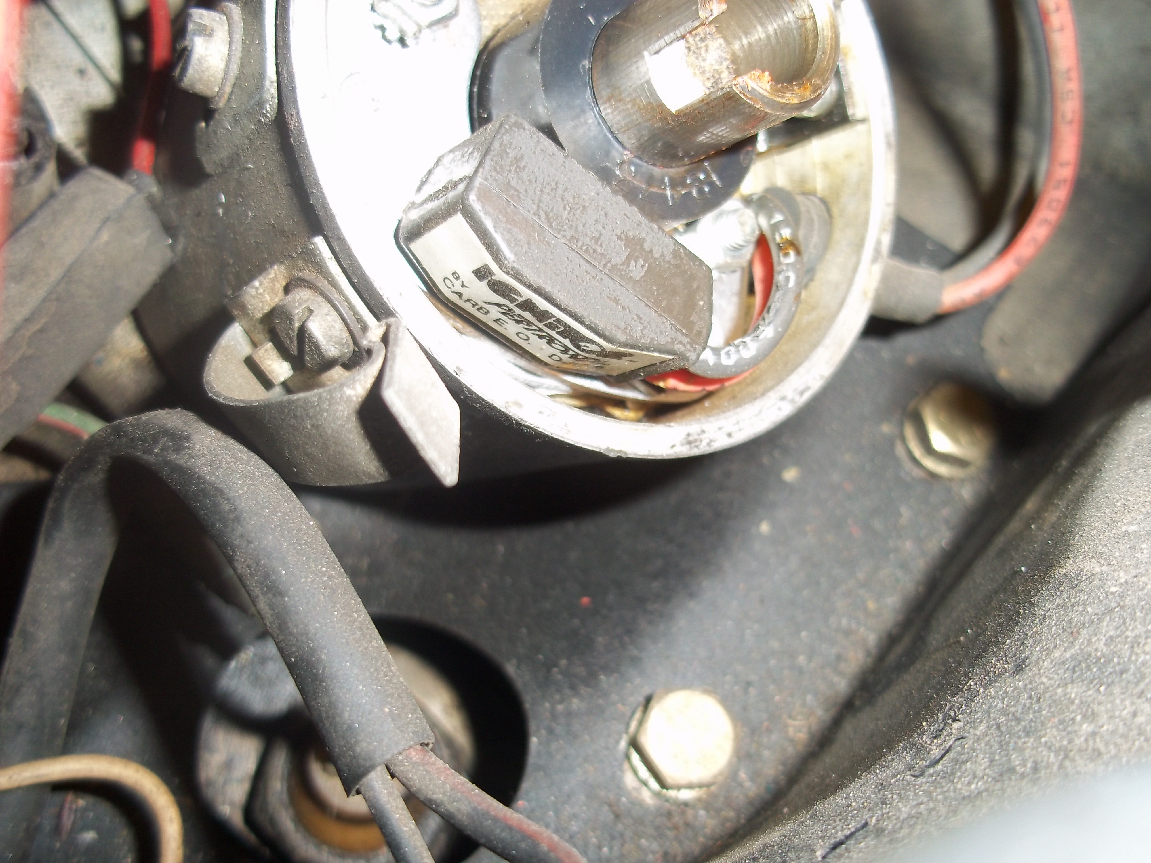

So tonight I had it running and took everything apart.
Replaced the points with the electronic ignitor and installed everything.
I have the red wire going to the + on the coil and the black wire on the - on the coil. I have the the live wire that goes from the relay for ignition live going from the relay to the + on the coil as well.

Nothing meaning no spark from the coil wire? If so, check and see if you really have 12v to the positive side of the coil. Disconnect the red and black wires for the pertronix from the coil. Using a test light, see if it lights when the wire on the test light is grounded, and the probe tip is touched to the positive side of the coil. Make sure the key is on. biggrin.gif

I had a similar problem with my Pertronix install that ended up being the points plate that the module mounts to inside the distributor. The plate itself was stuck and in the wrong position. Why? Because the points plate I bought was an AA special. Make sure that you can freely and easily rotate the points plate back and forth. It only travels 10-20mm I think..
In this process have you adjusted the timing or removed the distributor? Are you getting 12v measured from the red wire and chassis or battery ground. One other item: many have found that installing the magnetic pickup ring around the shaft takes a surprising amount of force to fully seat. I used a deep socket and lightly tapped it on with a small hammer. If it sits too high, it can't make contact with the Ignitor unit. Can you show us a photo of your installation?
One flaw with this Ignitor I module is that IF the rotor is pointing directly at one of the distributor posts AND you leave the keys in the ACC/ON position without starting the car (like listening to the radio while waiting for the AAA guy to arrive) the Ignitor will cook itself. That problem was solved with the Ignitor II (Part# 91847V). FYI.

Marcus makes some good points above, I noticed when I first installed a Pertronix that it will change your timing somewhat. You will need to reset your timing!
Also, in regards to tapping the magnet sleeve down, I've always been able to seat them by hand but sometimes it's maddening to achieve. Keep working it around until you find the sweet spot because sometimes they'll only seat in one specific position. I would only resort to tapping it down with the hammer if all else fails. I tried that one time and promptly broke the fiber washers in my dizzy shaft; ruined the dizzy!!

True. I can't stress enough that I used the tiniest amount of force with the tiniest hammer. A Playskool hammer if at all possible. Just very VERY light taps. And yes, the magnetic pickup is indexed.
