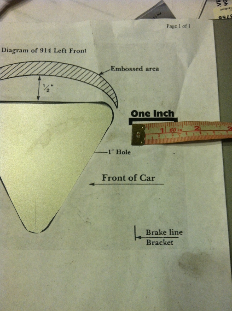

So I decided i would start drilling the holes for my Tarret front sway bar. I had downloaded the instructions from Pelican parts read through them a few times. I cut out the template and marked my holes. I drilled the bottom hole, and got the bright idea, that I would put bolts in the Tarret backing plate to verify and check my holes.
Much to my surprise my hole was wrong....then it dawned on me the Pelican parts instructions were for a stock sway bar...mine was Tarrett... headbang.gif
So now my 2 minute hole is going to cost me about 4 hours of welding and grinding to build a tiny plate to weld the hole shut.... headbang.gif
And all i had to do was match the template to the part and save me all of the trouble..... blink.gif

The template from pelican is larger - like a 1/2 in per hole, than the tarret parts I received. I will post pics tomorrow.

Bummer. Sounds like your template did not print to size. The Tarrett and stock factory mounts are the same dimension. The through body sway bars are all the same for 911, 912 and 914.

Ding ding ding we have a winner, the template didn't print to size. wacko.gif
I am really gald I checked the template with the backing plate before I drilled all three holes. I did see the 1 inch call out and it didn't dawn on me to check it....

More often than not, the default for printing mode is "Scale size to fit media" in which case who knows what size you'll end up with.
