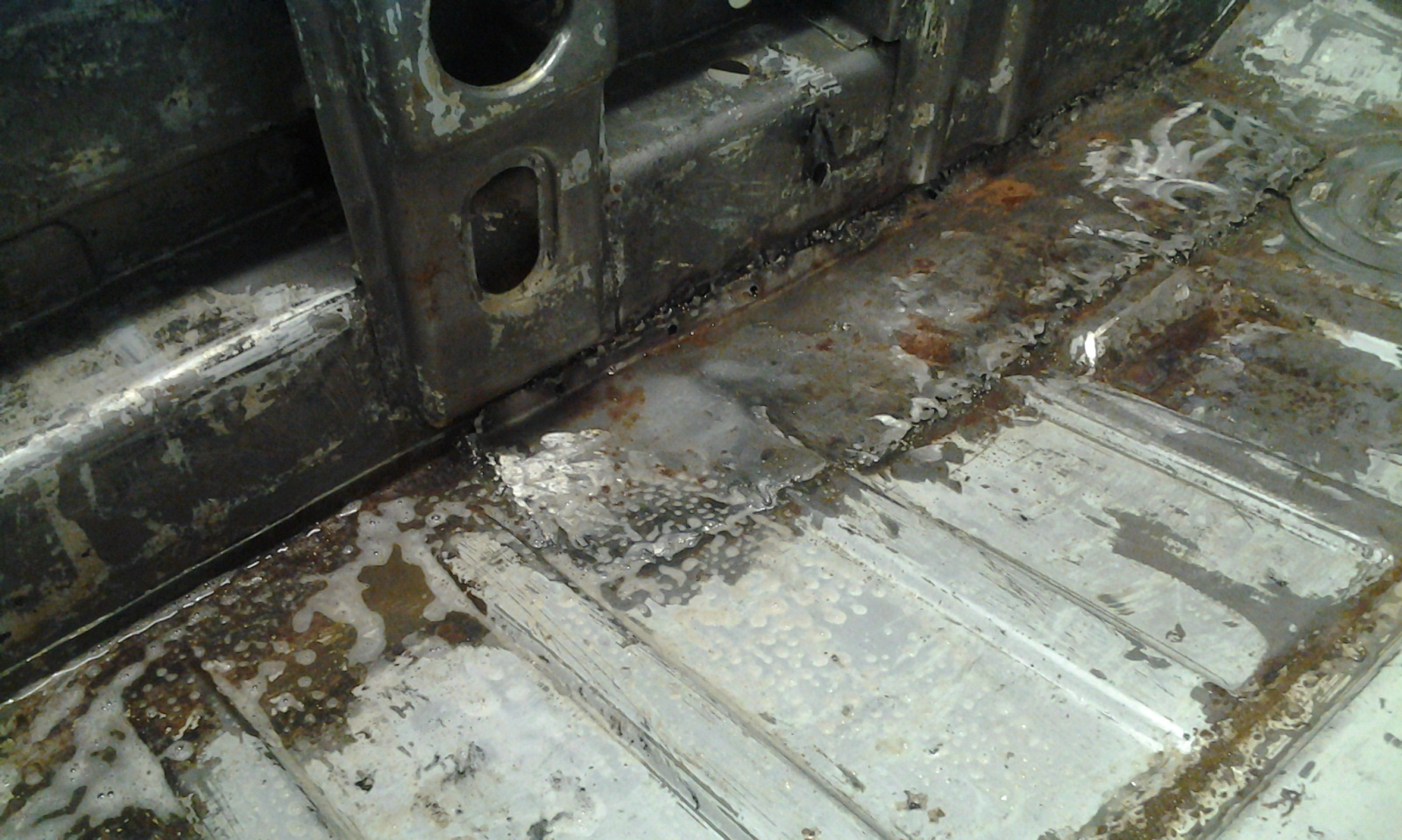

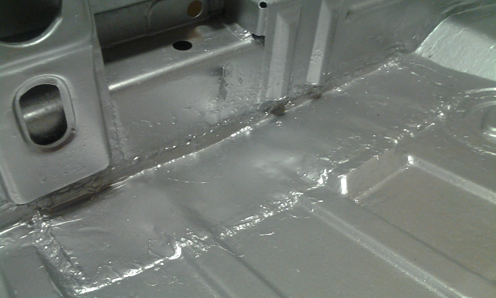

I have had excellent luck with my hell hole and the exhaust heat shield which I POR 15'd about 4 years ago. No issues whatsoever. I used their Marine Clean degreaser and their Metal Ready prep as well - and I followed the directions completely.
Since I believe and have my own proof that POR-15 works well with the proper preparation, over the past 4 weeks I removed all the tar out of the interior, wire brushed it down to bare metal (or light rust), and coated the floor with POR 15. After drying for a week plus, I applied 1-2 layers of a Dynamat equivalent - Hush Mat - and a layer of Second Skin Luxury Liner Pro on the floor and the firewall.
Test drive tomorrow or Wednesday....
