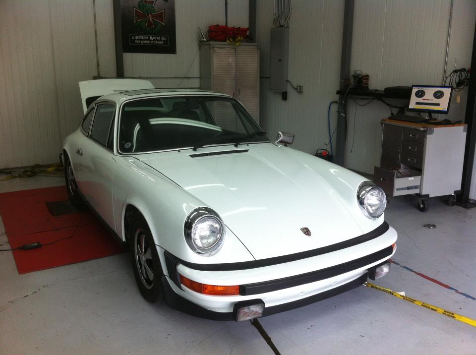

Left is 912E #985, center is 912E#185 and right is my '88 Carrera
#985 on my chassis dyno tuning the Electromotive
I see you had to have it towed there!
