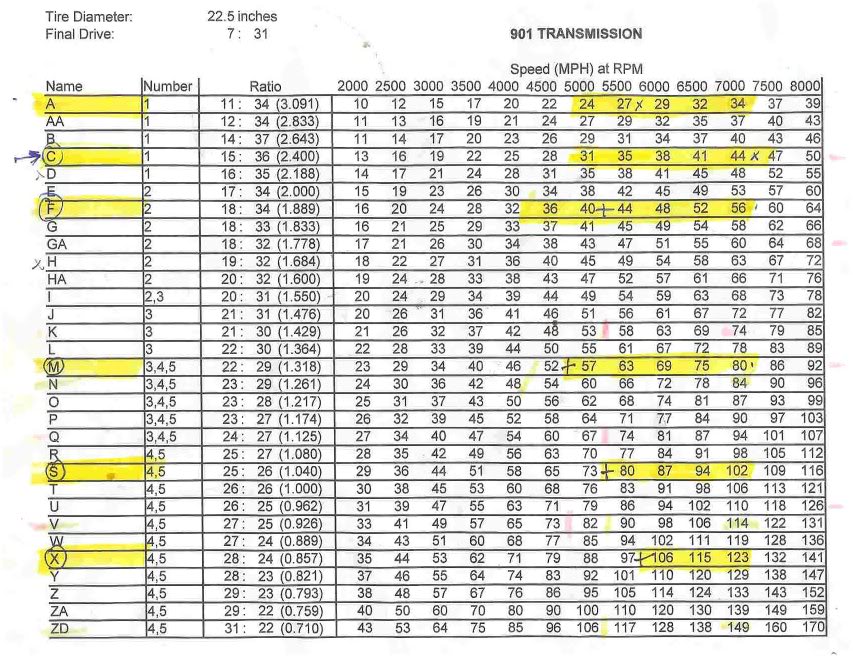

C or D first gear. Totally worth it!
I run the C first. It's good to 45mph at 7k and you can downshift into it at will.
I run the stock F 2nd, flipped ZD 3rd ( Ka )
S 4th and X 5th.
I would only change 5th to a stock ZD if it were a street car.

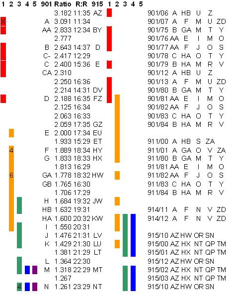

So where is HB on the chart?
Mark Henry
Jan 26 2014, 12:48 AM
HB is a oddball 4 speed gear between H and HA. It's not on some charts. HA is a 5 speed 2nd and can't be used.
H, and HB are 4 speed 2nd gears that are flipped making a 5th.
Flipped H is a sought after gear for the V8 crowd.
This chart shows the gears and what boxes they are in, of course many boxes now have who knows what in them.
