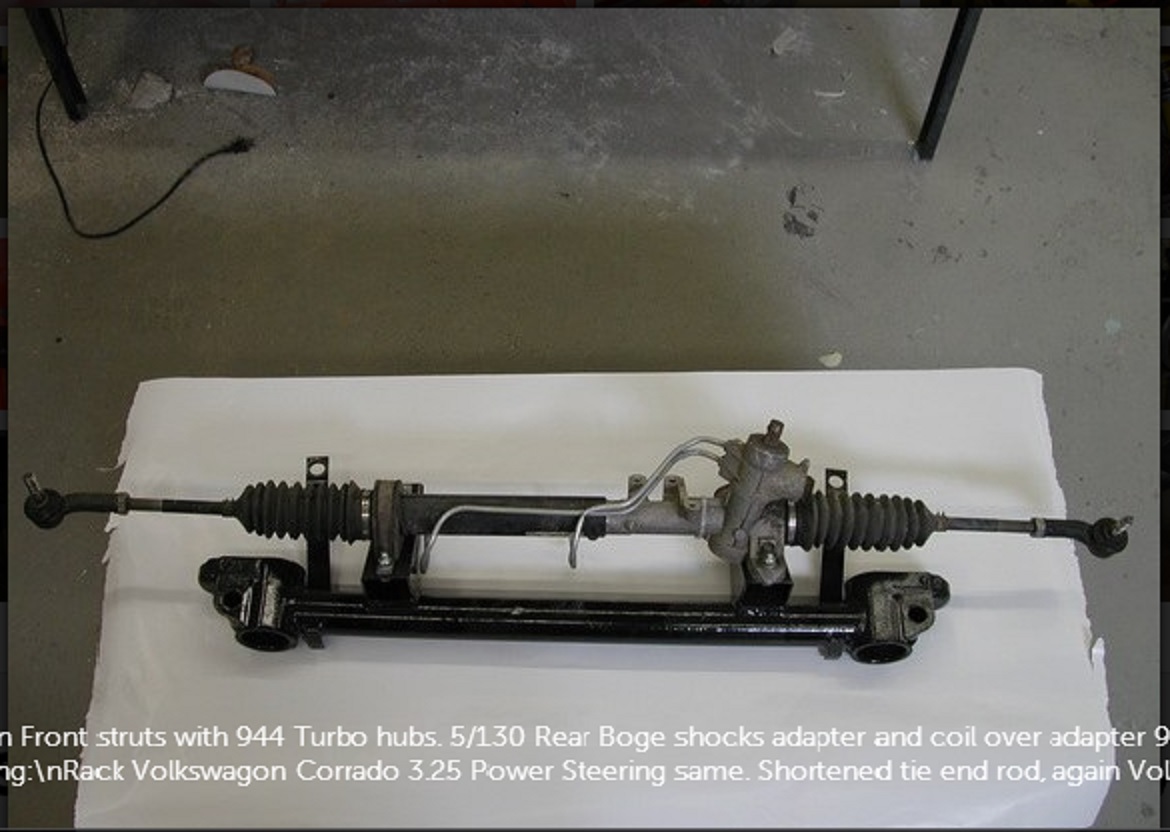

Has anyone fitted power steering to their 914? if so what rack did you use?

Here's a V8 conversion fitted with a power steering rack, as well as power brakes. There are a few pictures of the underside of the car and the power steering pump.
http://www.cardomain.com/ride/2303120/1975.../photo-gallery/Guy T.
