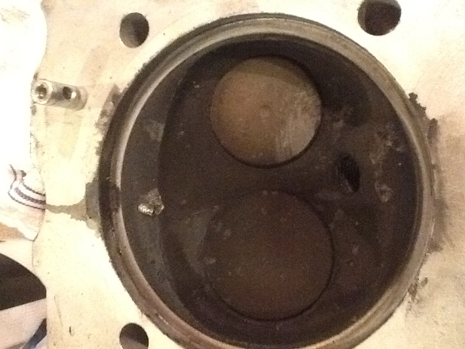

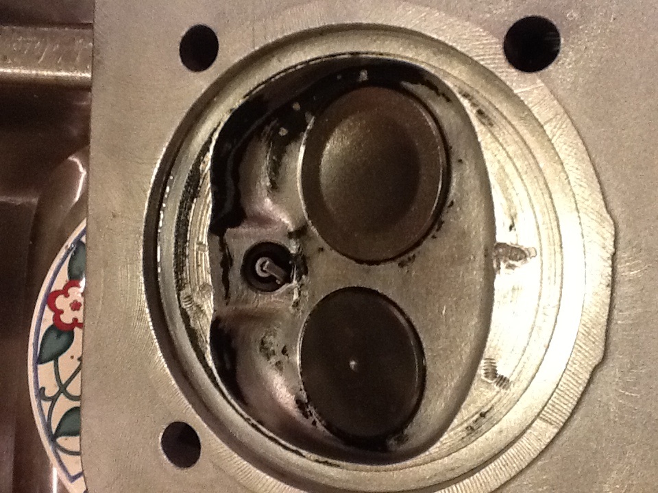

Mblizzard
Feb 24 2014, 07:41 PM
QUOTE(r_towle @ Feb 24 2014, 05:28 PM)
You never said if this was happening before you changed the fuel lines....
Was it?
Sorry I guess I was not clear. But it was not happening before I installed the SS lines. But I also had to pull the heads to retrieve a part that fell in the intake. Another long story.
Click to view attachmentClick to view attachmentBanged around a bit but good compression afterwards and the valves seemed fine. Did not mess with the dizzy. It is the same as before.
So I have to think it has something to do with the fuel lines. I am betting I swapped the lines around
Jake Raby
Feb 24 2014, 08:18 PM
Yep, a sheet metal screw was eaten. You'll make that mistake once.

Mblizzard
Feb 24 2014, 08:36 PM
QUOTE(Jake Raby @ Feb 24 2014, 06:18 PM)
Yes I will never do it again. I was very lucky! You remember the painful lessons!
