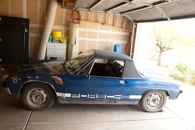

Saturday March 15th, my best friend (timothy_nd28: http://www.914world.com/bbs2/index.php?showuser=8154) is coming out to Tucson to help me get my 72 1.7l 914 project up and running. He will be in town for about 5 days and here is our agenda: 1. Install L-Jet FI 2. Install new windshield 3. Install a new carpet kit 4. Install stainless steel fuel lines 5. A few other miscellaneous updates.
Our goal is to get the car finally running after rescuing it from a local scrapyard in 2012. Click to view attachment

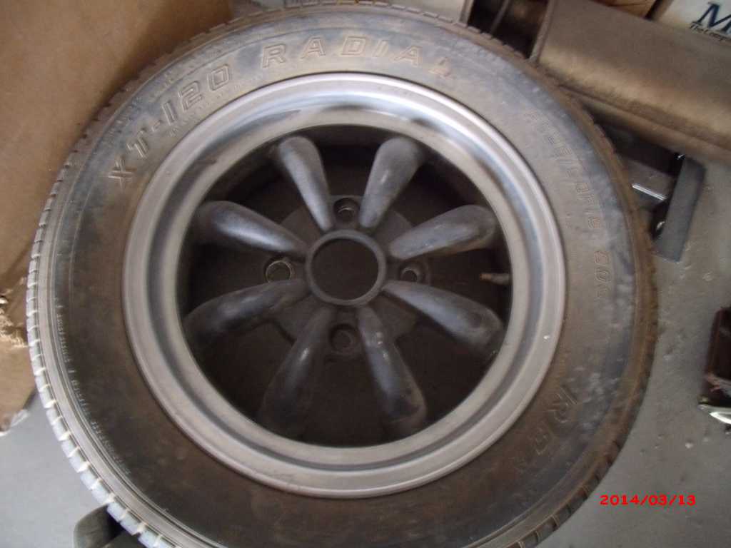

Do you need a set of wheels? I have four of these - in decent shape that I won't be using. If you'd like them I just ask to trade for the steel wheels so I can have something to roll the car around with.
Gerard, yes please! I will get the tires off my steel wheels tomorrow and have them ready for you on Saturday.
Thank you!

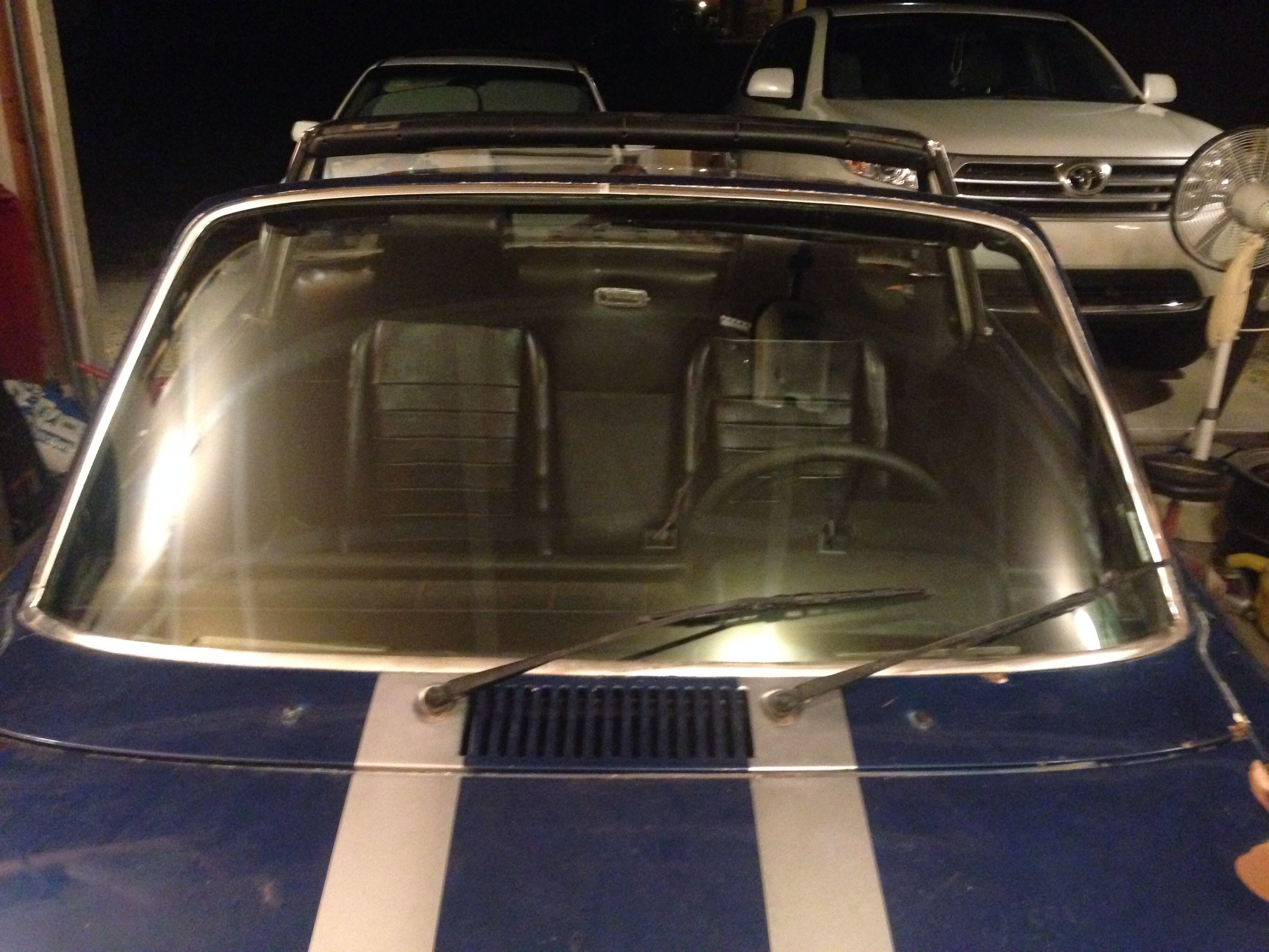

Mar 17 2014, 09:12 PM
Got a bunch done today. The interior is complete and the windshield is in. This afternoon the engine roared to life. However, it's not playing nice. I'm having issues getting this to tune correctly. It's not holding a idle correctly, starting to wonder if this engine has a non fuel injection cam.
