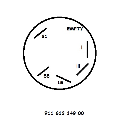

I am going to use a 911 heated window switch to control the fan on my oil cooler. I am trying to verify the different tabs on the back of the switch.
Here is a diagram of the back:
I am guessing that the numerical definitions are standard for all porsche switches - but I dont want to burn up the switch or wiring by making this assumption.
Here is how I think things should go:
31 = Ground
58 = light inside the switch <-- is this + or - ?
15 = keyed power
I = Load/Accessory #1
III = Load/Accesory #2
Can anyone verify?
Also, is #58 a positive or negative lead? When installing a standard off the shelf FLAPS rocker switch, the lead to make it illuminate is negative. However, those types of switches do not have a ground - they just interrupt the power lead to the accessory.
On a side note, this is a single postion pull switch - weird that is has what appears to be two load "outputs".
Thanks a million for any help!!

Get yourself a cheap digital multi meter (under 8$ at harbor Freight)
then using ohms scales, check across various terminals switch off & on.
If open switch closed and zero or just a few ohms switch on you'll know.
Barefoot
