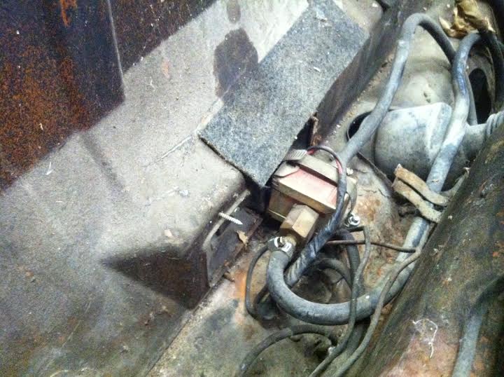

Here's an image of a hack job (Noooo... you say, not in a 914! ohmy.gif )
it does give you an idea of the location and the line routing. You can also the tabs for the factory fuel filter etc.
It's nice if you ever want to change out the pump. A few screws and it comes out with the door.
You'd have to a get a pump that would be spec'd for the motor you're installing.

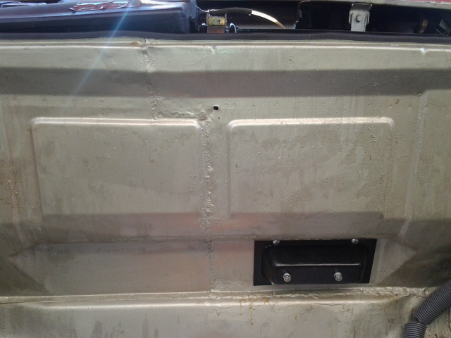

I thought I had a shot before I put the tank in, but I can't find it. If I run across it, I'll add it later.
But here is a shot of the door. Anyone recognize the big SCAR? Pretty obvious that the right front was hit, decent repair job IMHO.
