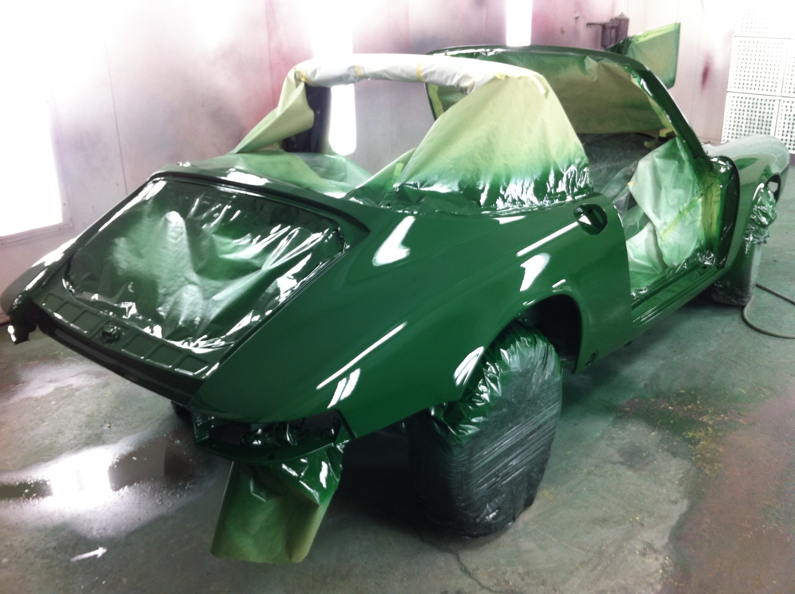

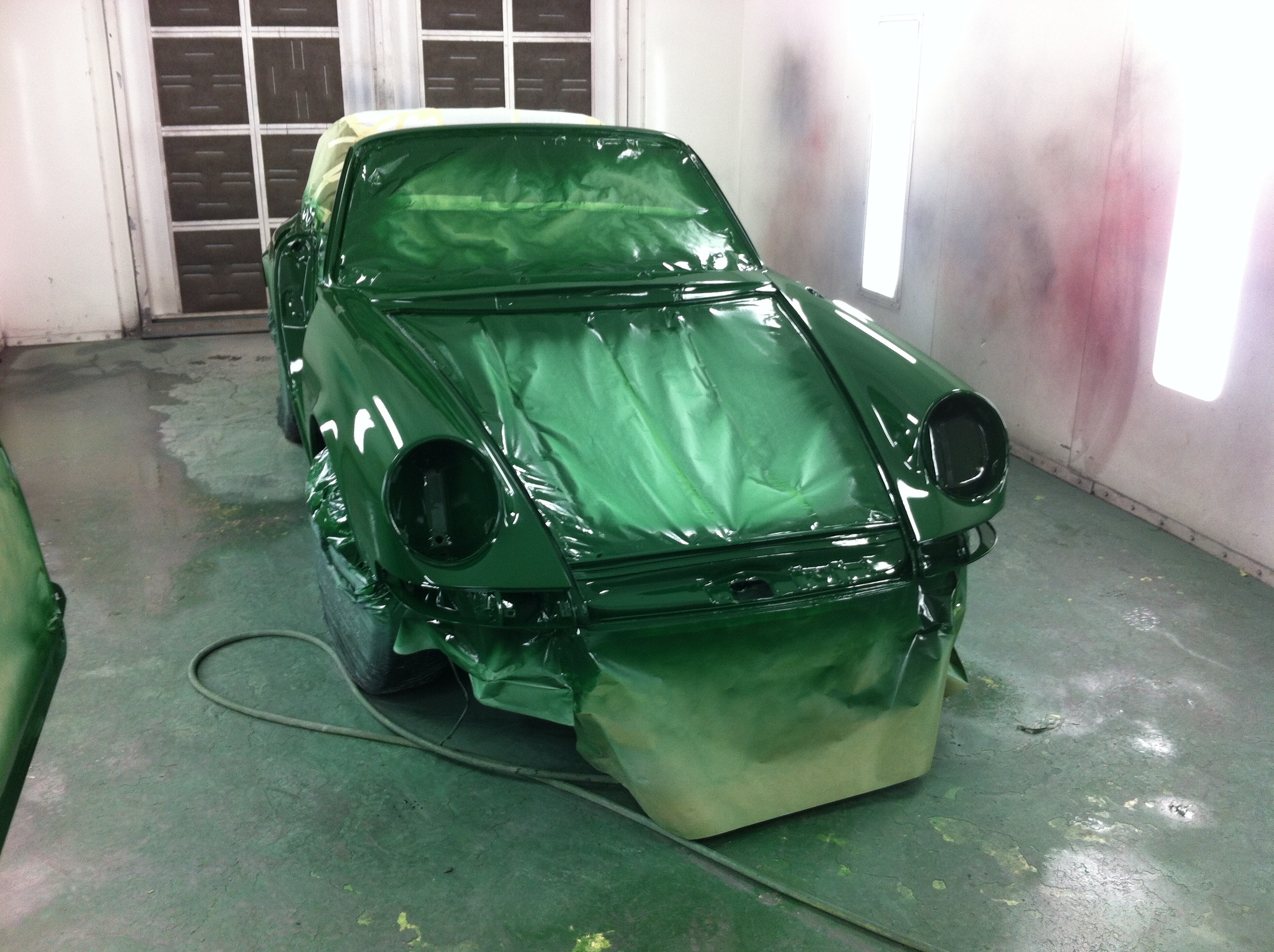

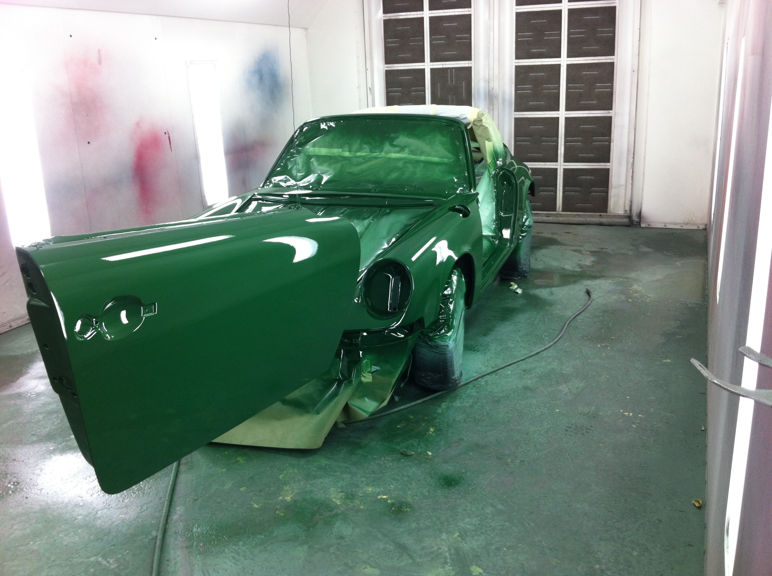

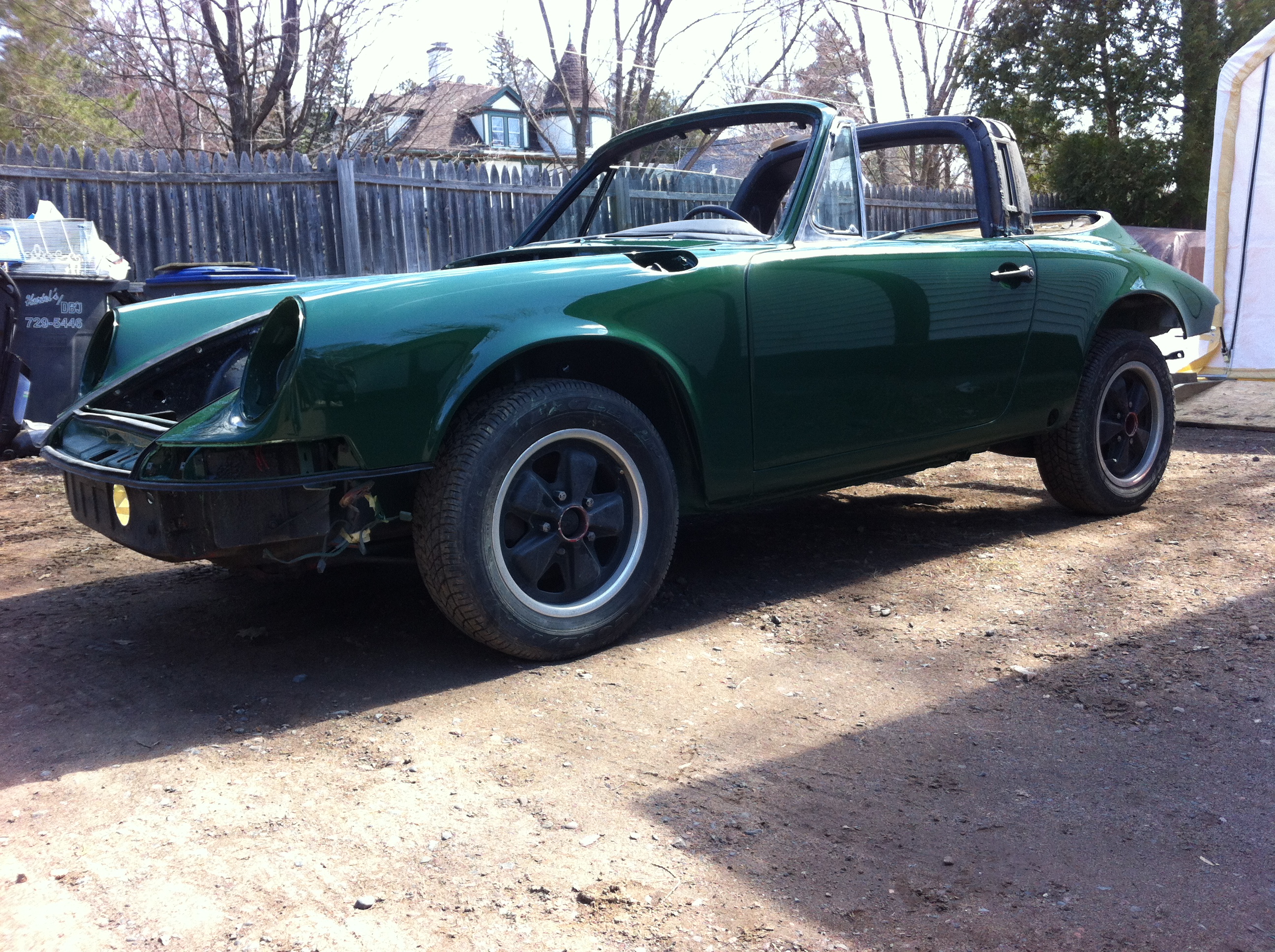

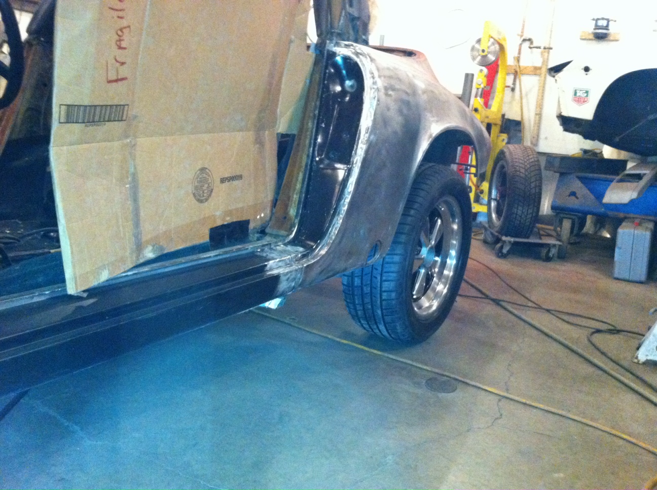

I thought I would share a couple photos of a 911 I have been working on. It came to me with 10 very bad paint jobs, very poorly repaired crash damage and fist sized rust holes in the fenders, rockers and left door jamb. It's far from finished. But at least I now have paint on the doors and shell.

jaxdream
Apr 6 2014, 09:18 AM
What's with the hole in the right rear fender behind the door jam for ??? Great looking paint job , iffn you like green !!!!!

Apr 6 2014, 09:33 AM
1972 model Oil tank flap opening. very sought after cars now.

With the 2.4 mfi , targa, 1972 911S, this will be a highly sought after Porsche.
Did I mention NICE body work ?!

siverson
Apr 6 2014, 10:13 AM
Nice. Is that Irish Green?

rick 918-S
Apr 6 2014, 03:35 PM
Yes, Irish.
I was supposed to have the car completely finished and assembled for the first but it was so.... bad It took way..........longer to even get this far.
The car is getting a 3.0 with F.I.

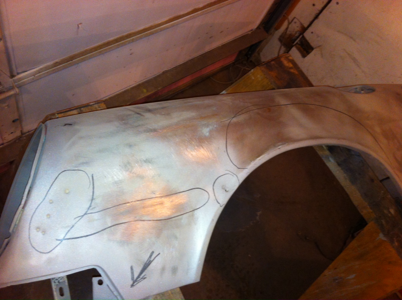

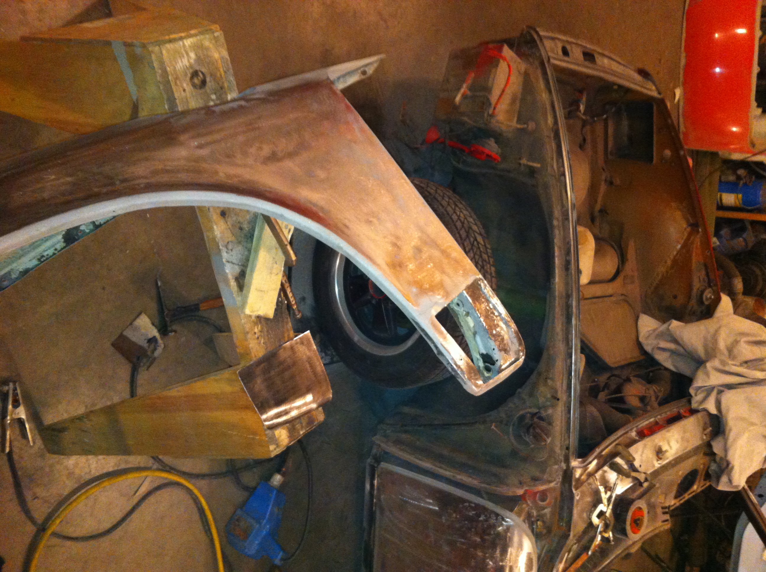

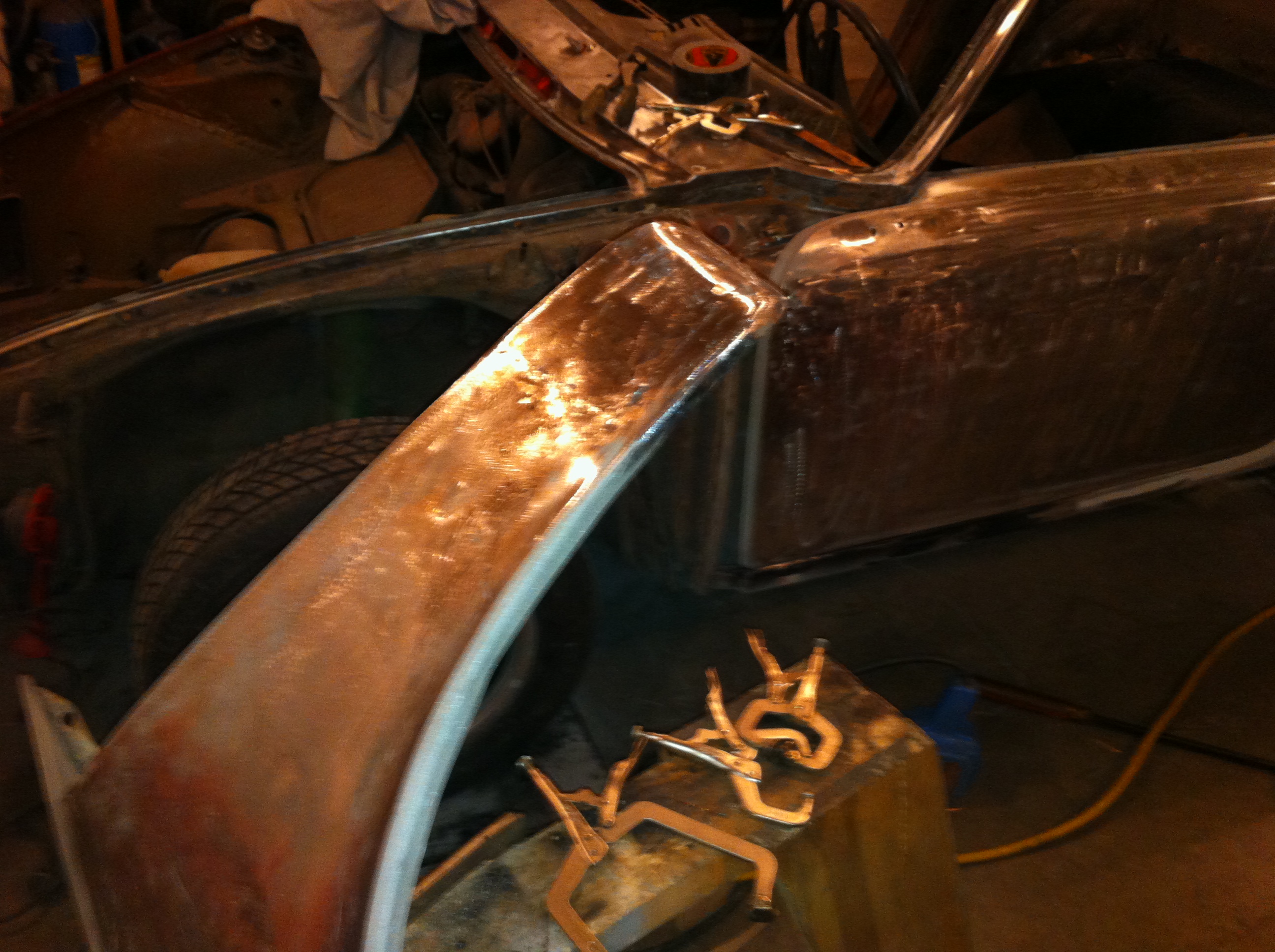

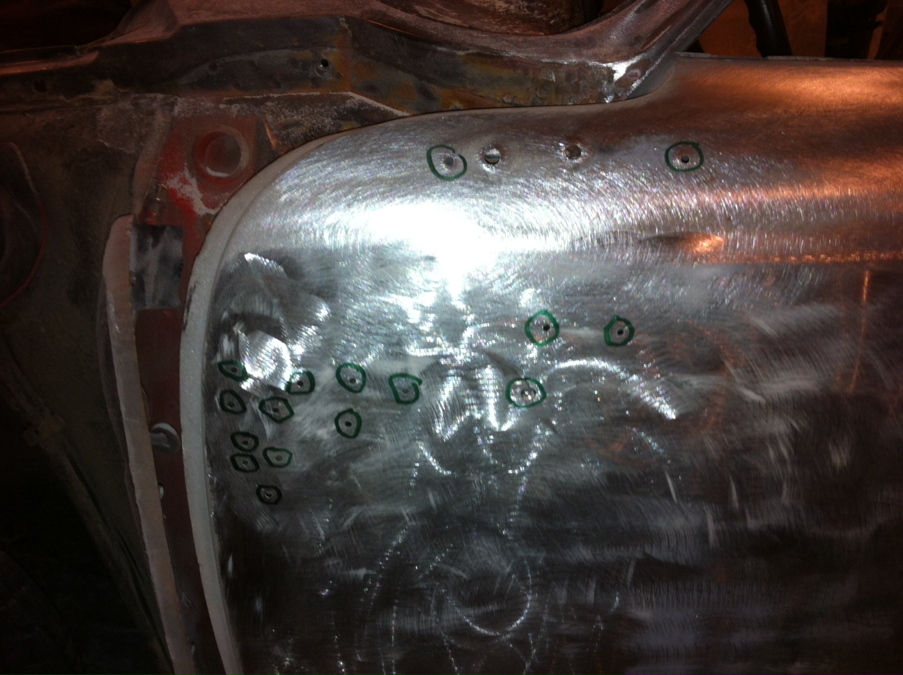

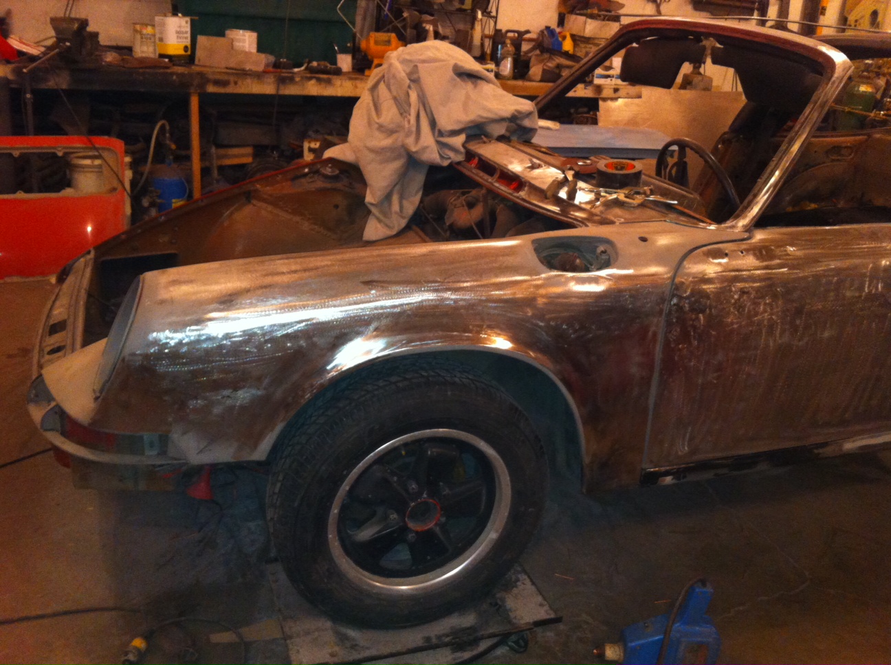

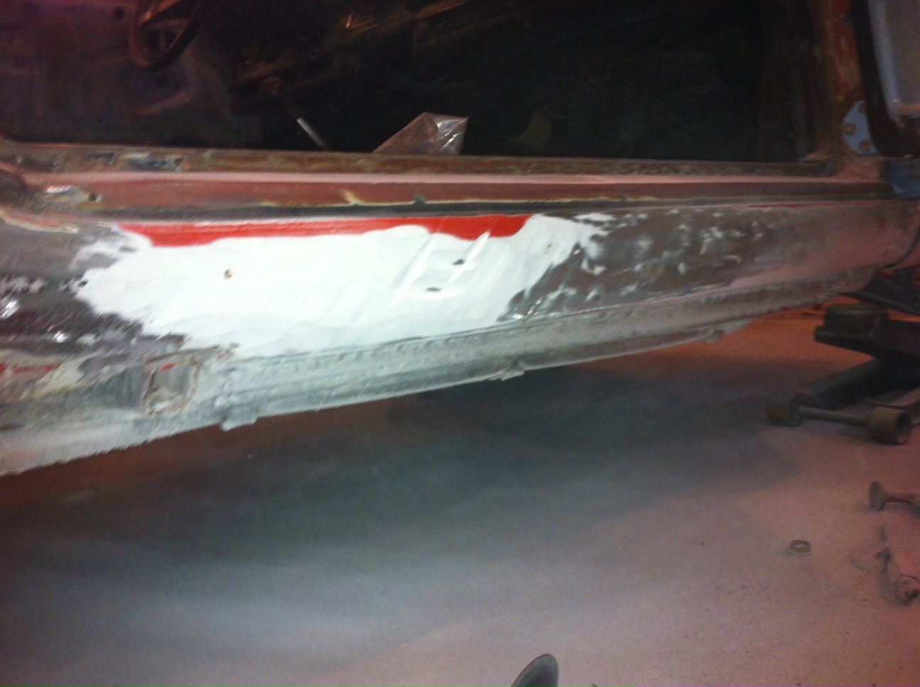

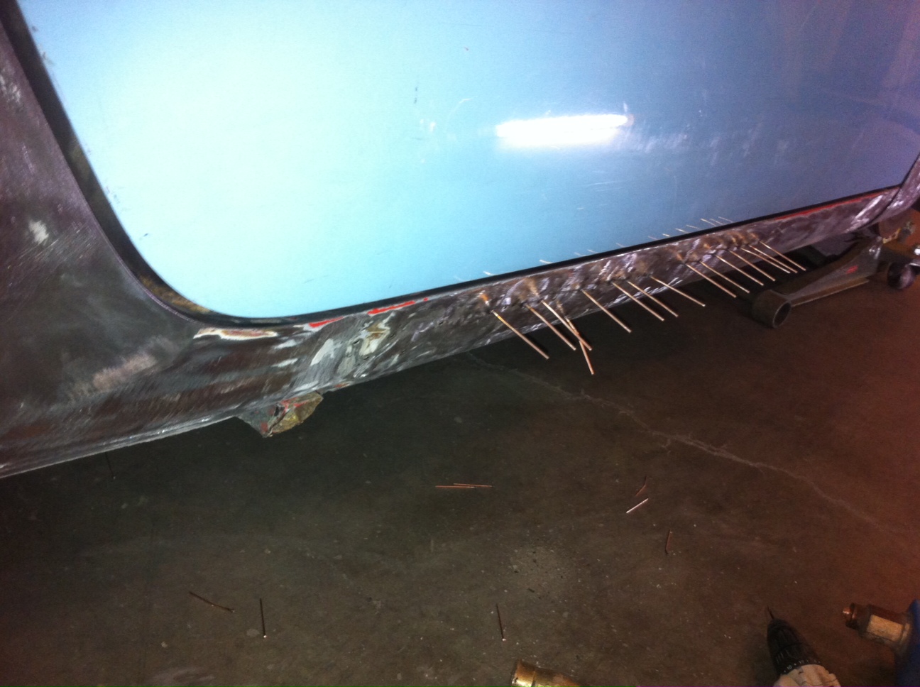

Here's a couple shots of what I had to start with.
Click to view attachmentClick to view attachmentClick to view attachmentCan you guys in Cali spread the word that drilling and leaving holes in panels is not a repair method..
I call those little filler worms hanging one this inside of the skin like little moisture wicks "California rivets"
The doors that were on the car were smashed and butchered so bad I got replacement doors from Parts Heaven. One was swiss cheesed by someone that was obviously learning how not to repair a panel.

rick 918-S
Apr 6 2014, 05:13 PM

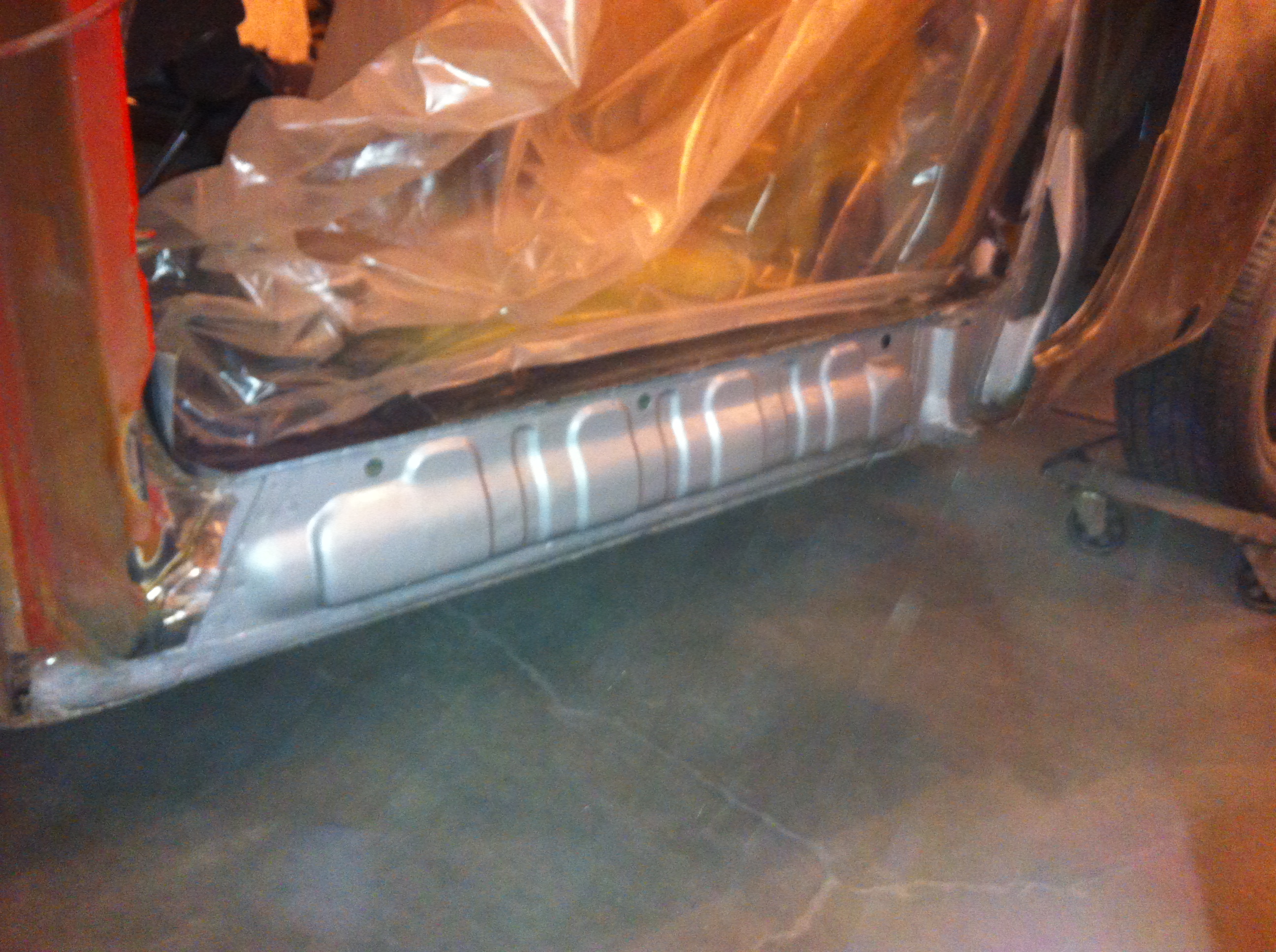

Rocker was creased full length, drilled full of holes and slathered with filler.

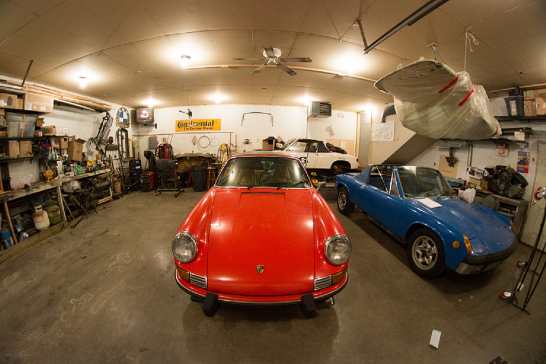

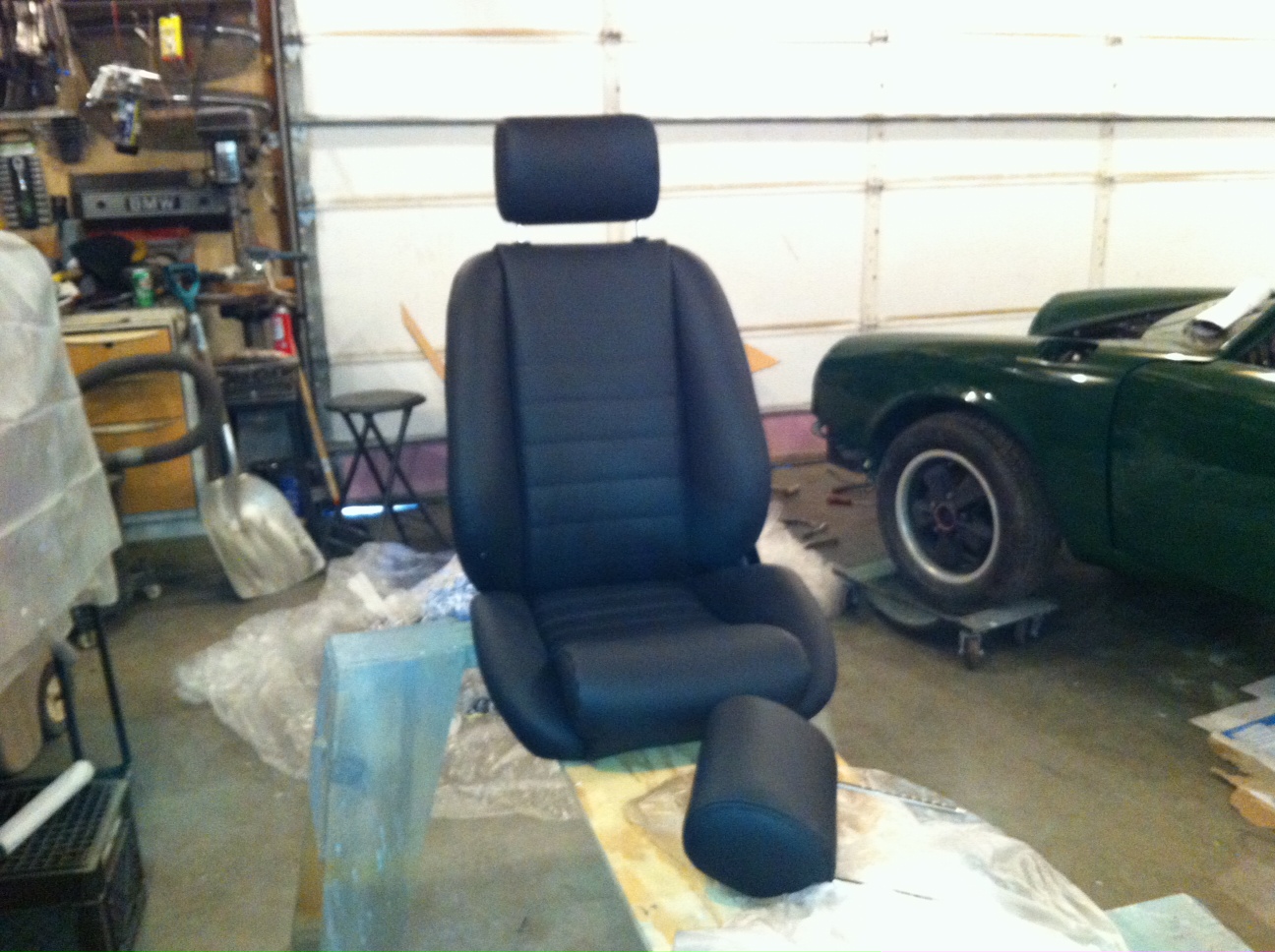

Starting to go back together.
Click to view attachmentHere's one of the seats from Classiccarseats.com These are the monte Carlo Seats with head rest. They are very nice!

And you started with a clean shop....nice
bulitt
May 5 2014, 08:12 AM
Why is the ruler taped to the door?
rick 918-S
May 5 2014, 09:21 AM
No latch in the door. I was using it to hold the door flush with the quarter panel to check the fender alignment.
rick 918-S
Jun 11 2014, 06:41 AM
Just dropped the junker off in Cleveland. Not a day too soon either. While I was there I was called the work the storm in Nebraska. So I'm on the road heading west.

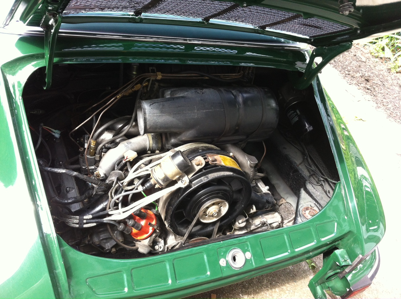

rick 918-S
Jun 11 2014, 08:36 AM

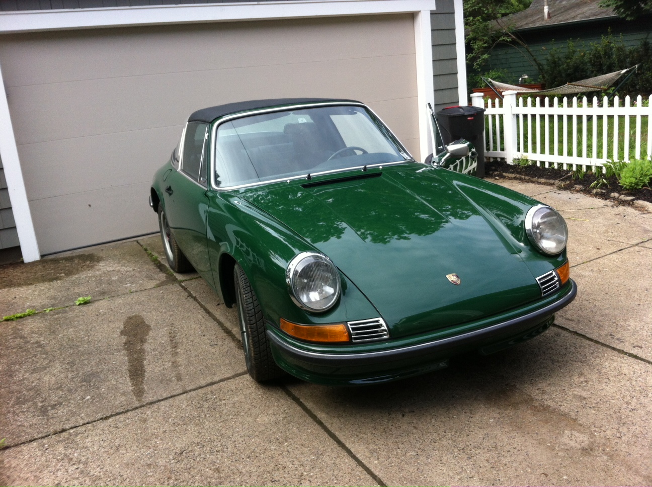

Couple more photos. This is my friends father in-law's car. We installed the wheels and a 3.0 F.I. in the driveway. We only sent him a photo of the car with the corner of the car cover lifted.
He hasn't seen it yet.

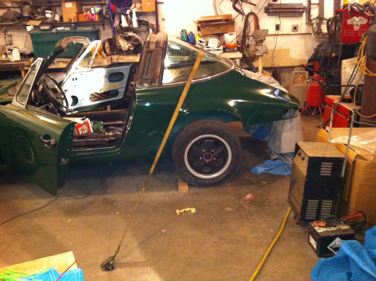

Here's how you install a 911 Targa window. Ratchet strap, floor anchors and lots of fear!
There's about 100 psi on that strap. it's tight!

Looks great Rick. Smart thinking on the targa glass. I don't think I would'a come up with that.

I had 3 pro glass installers chicken out and cancel when they saw the glass. I was really pissed as waiting for them to show slowed the progress on the car by a week and a half. Only way to get it done is to do it yourself. No one will touch a targa glass.
The second trick is to use para cord and double rope it. The first pass may leave a place where the seal didn't climb the lip.
