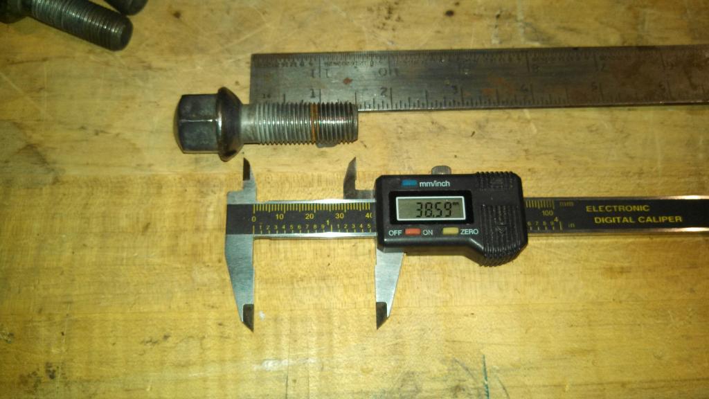

Apr 15 2014, 12:17 AM
A little late but:
