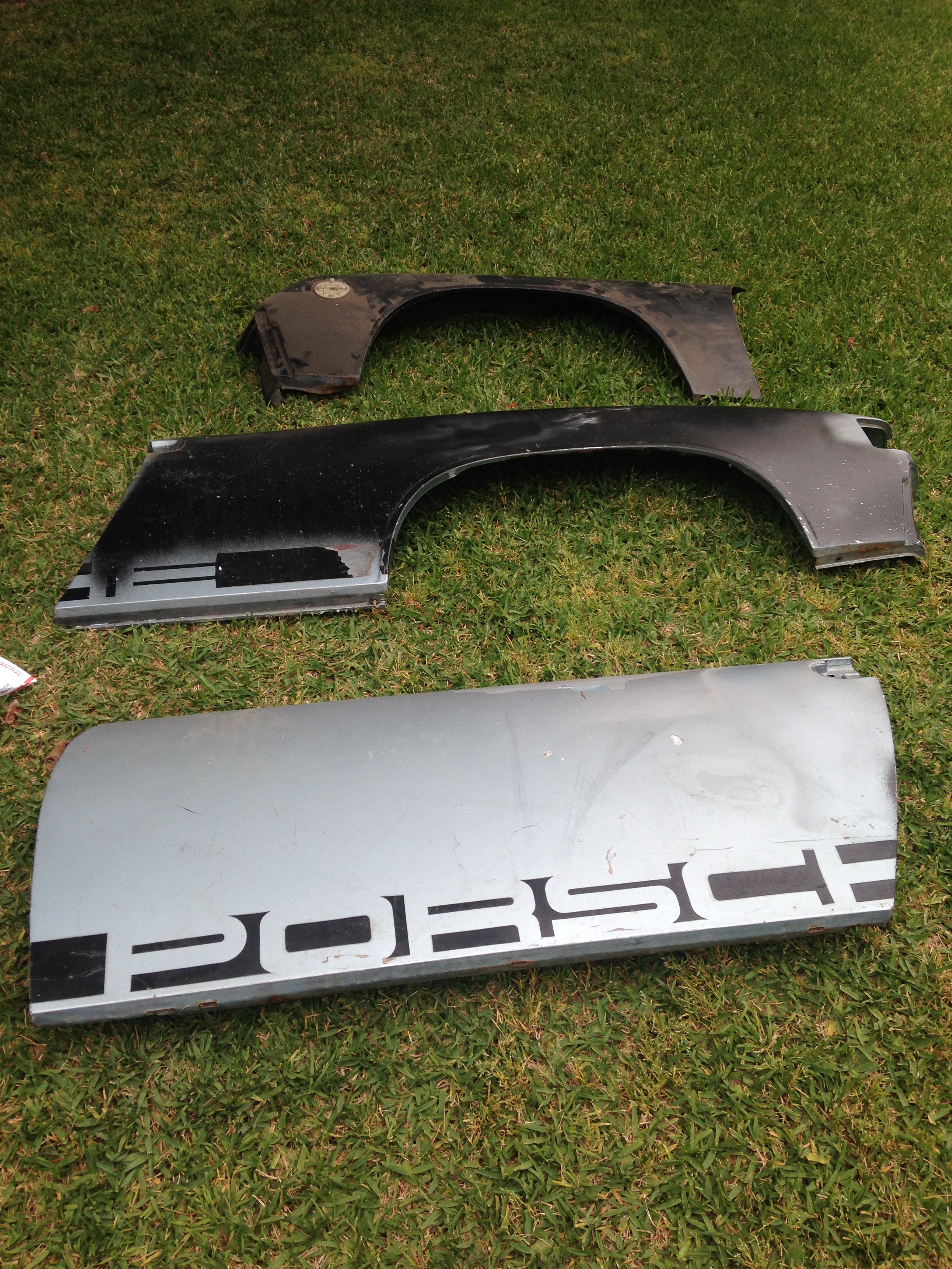

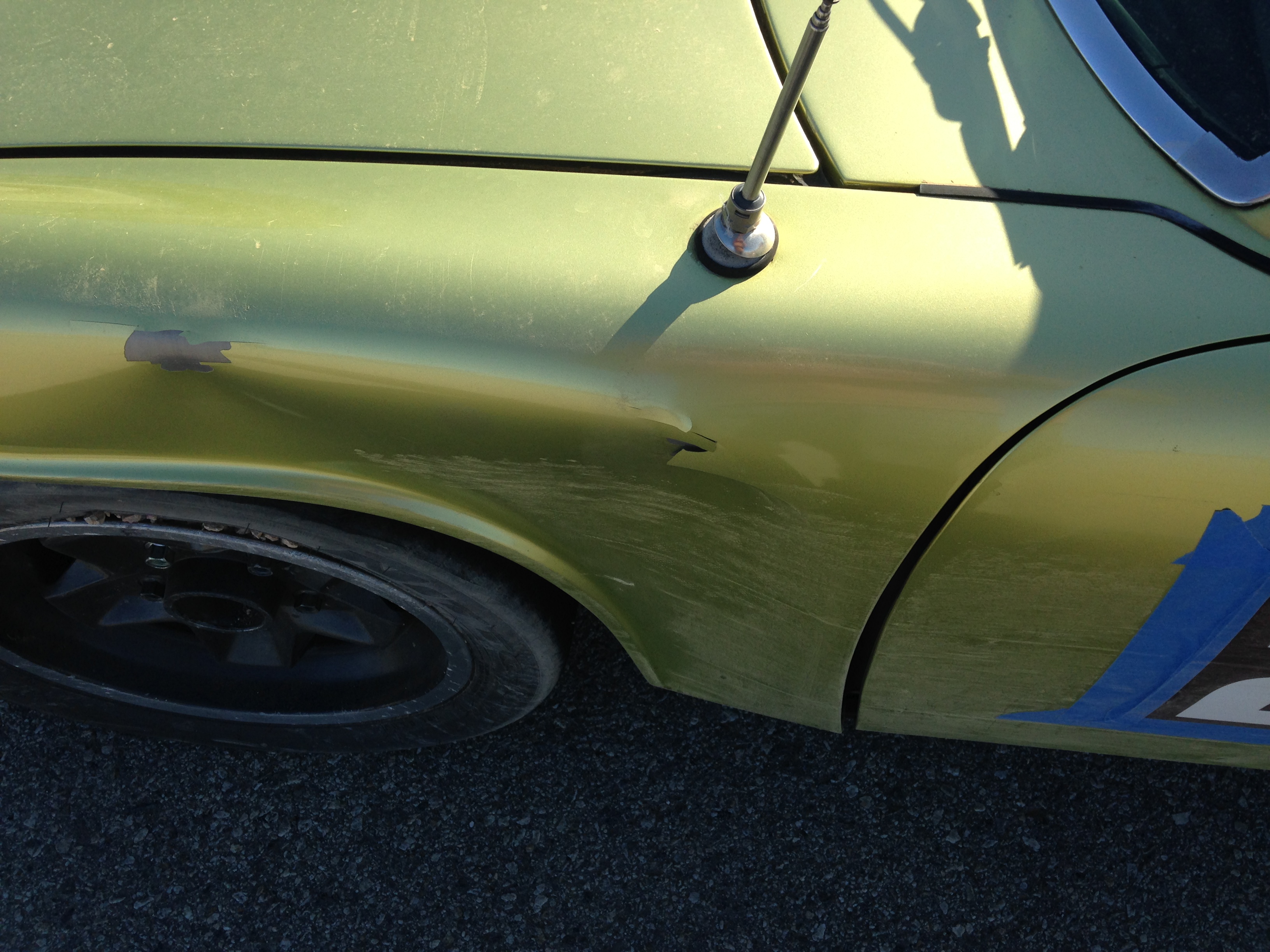

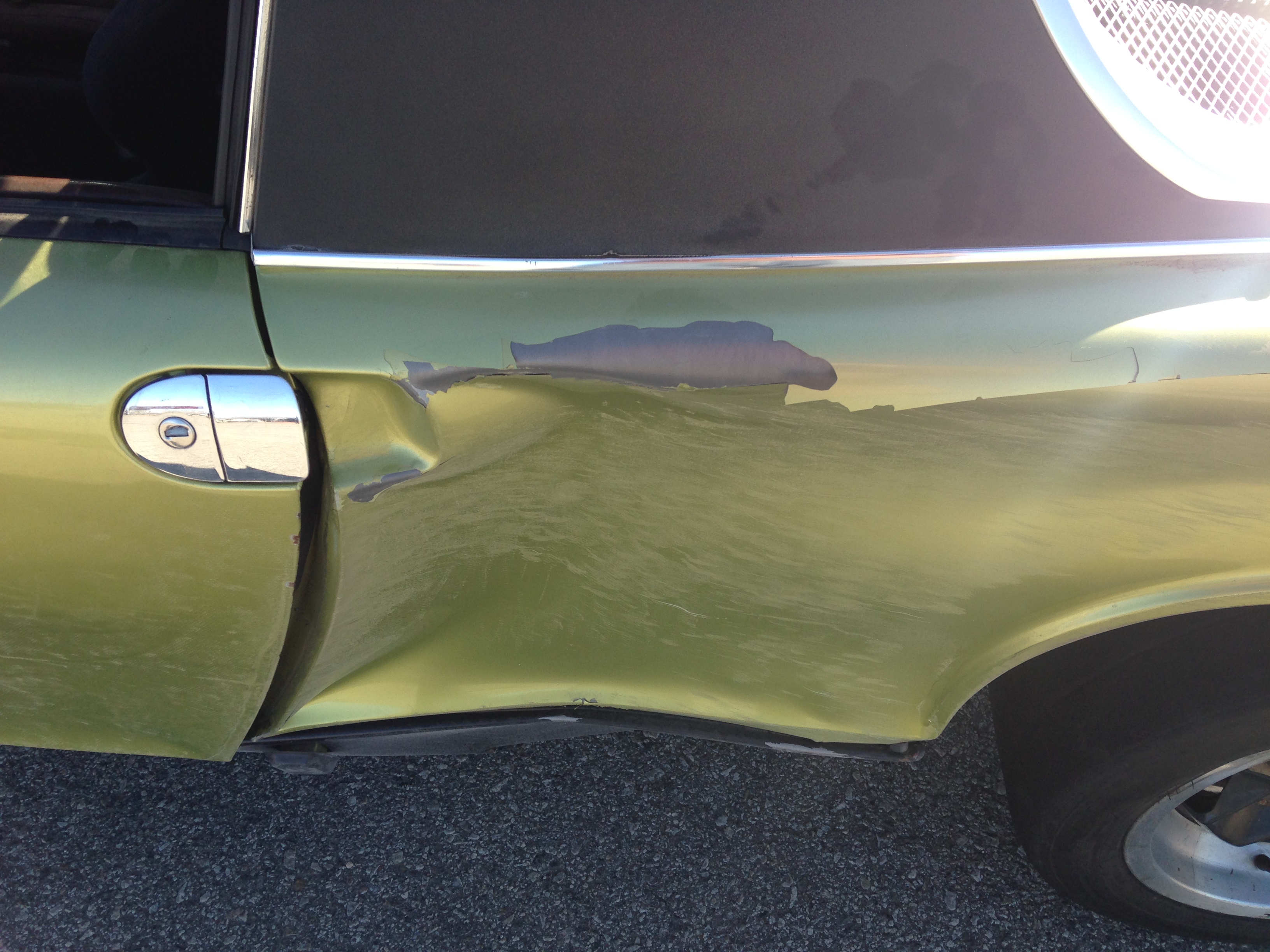

Thanks to Bruce Stone I have some sheet metal to work with. My plan is as follows:
* Plan A:
Use a Port-a-power to push as much of the metal back in to shape and hammer and dolly from there. I have at least one line on an affordable body shop to do the finish work after I rough it in.
* Plan B:
Push some metal back and cut and weld in parts from the lot that Bruce secured for me.
* Plan C:
Push the fronts back in as close as I can get and flare the rear with QRS panels and Duz fastners.

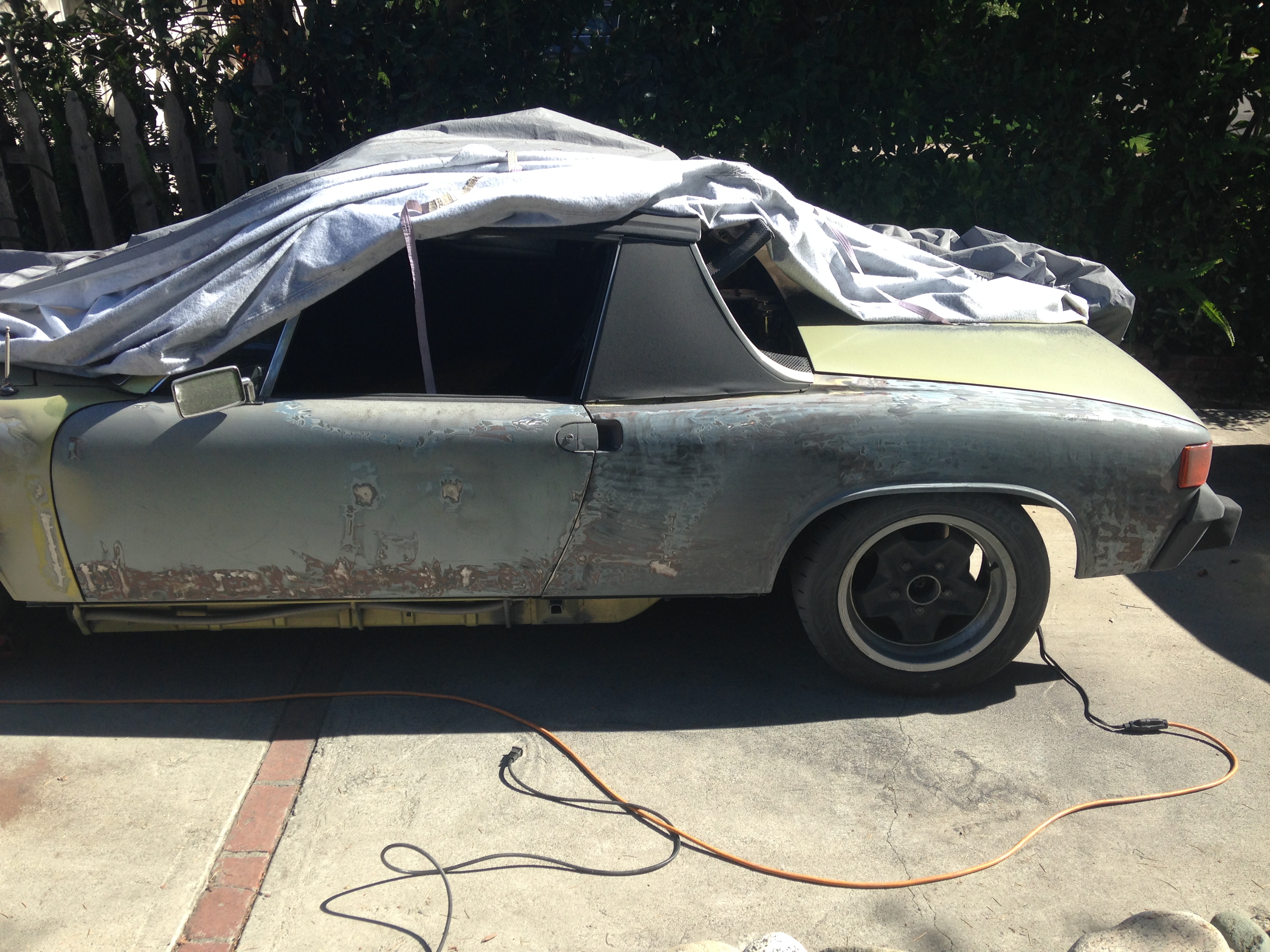

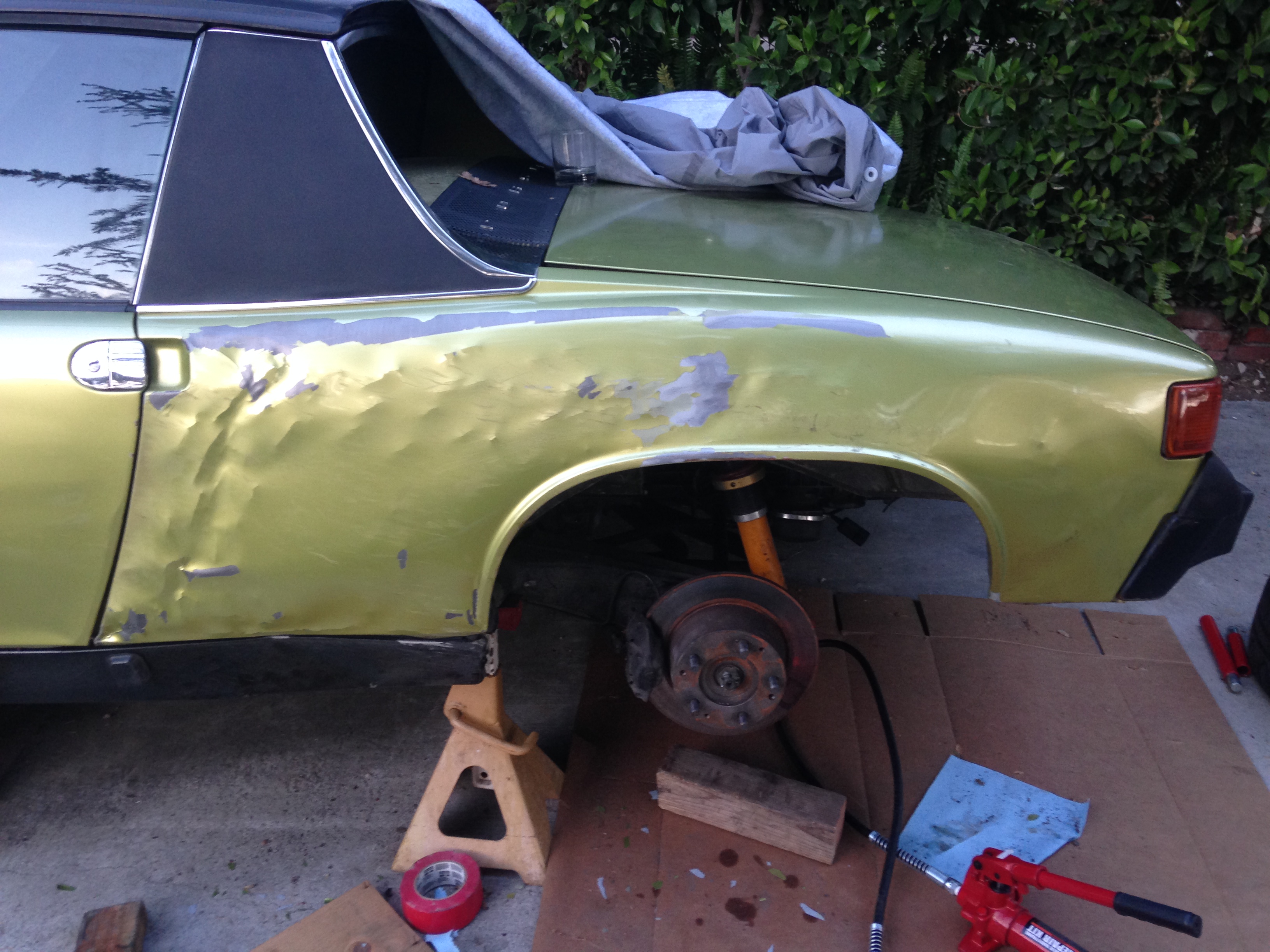

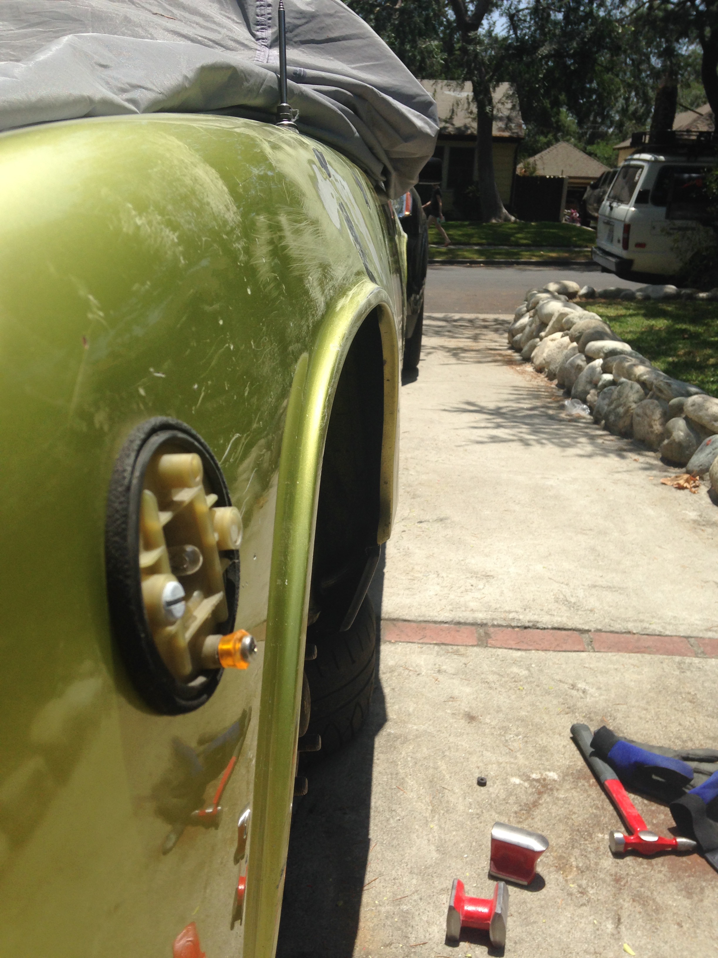

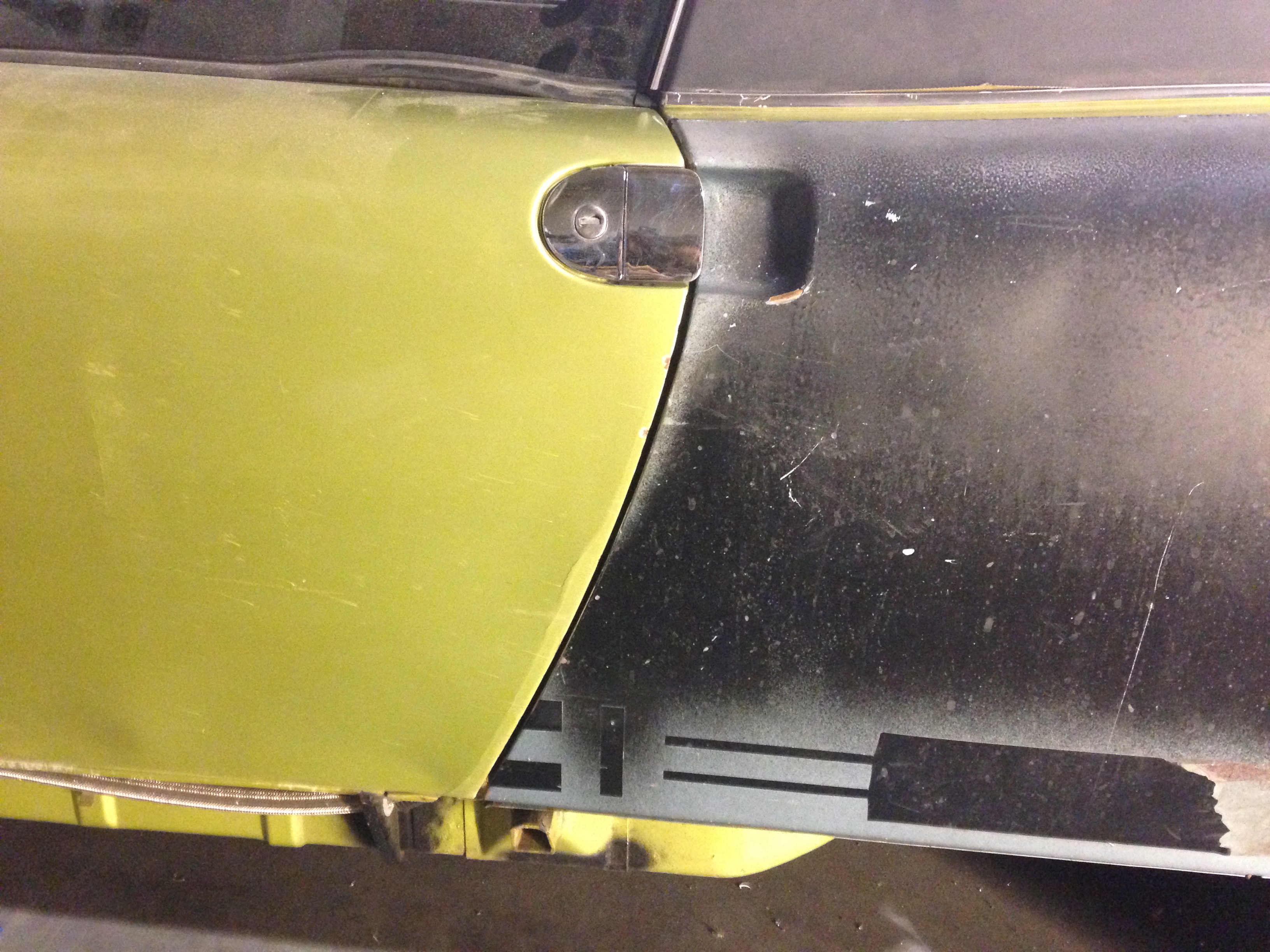

Started work pushing the dents out using a port-a-power. I'll be moving to a hammer and dolly from here to do the finishing work.

May 8 2014, 12:16 PM
Looking good. Good luck with the repairs
Chris H.
May 8 2014, 12:24 PM
Wow your door gaps look great compared to where they were! Nice work.
Jmkorfha
May 8 2014, 02:45 PM
Looking good. And familiar. I didn't have the guts to start beatin' on mine until I had replacement panels sitting there. Amazing how fast the dents come out.

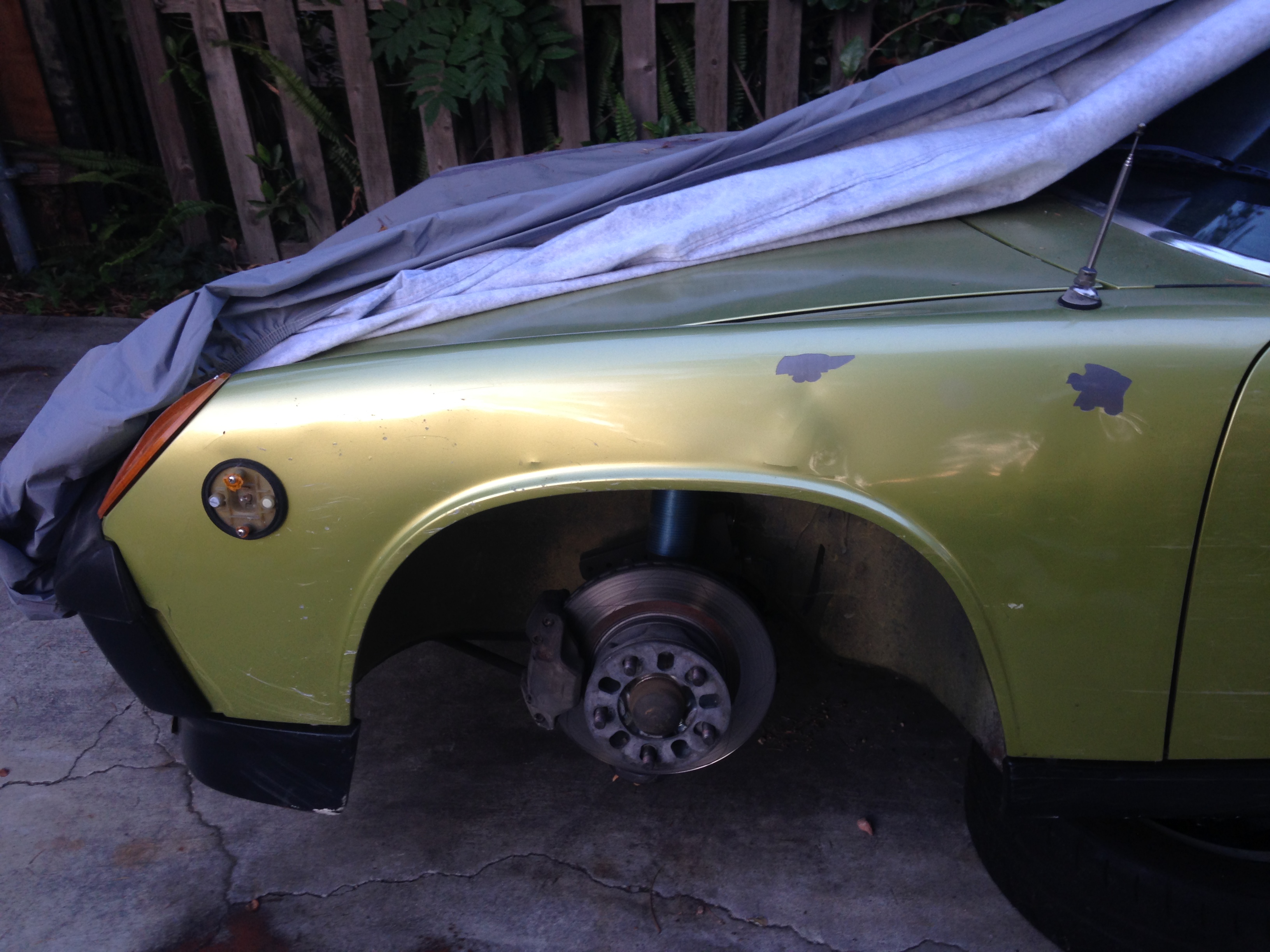

May 19 2014, 05:36 PM

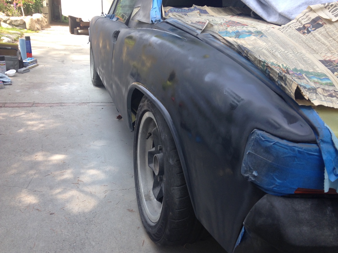

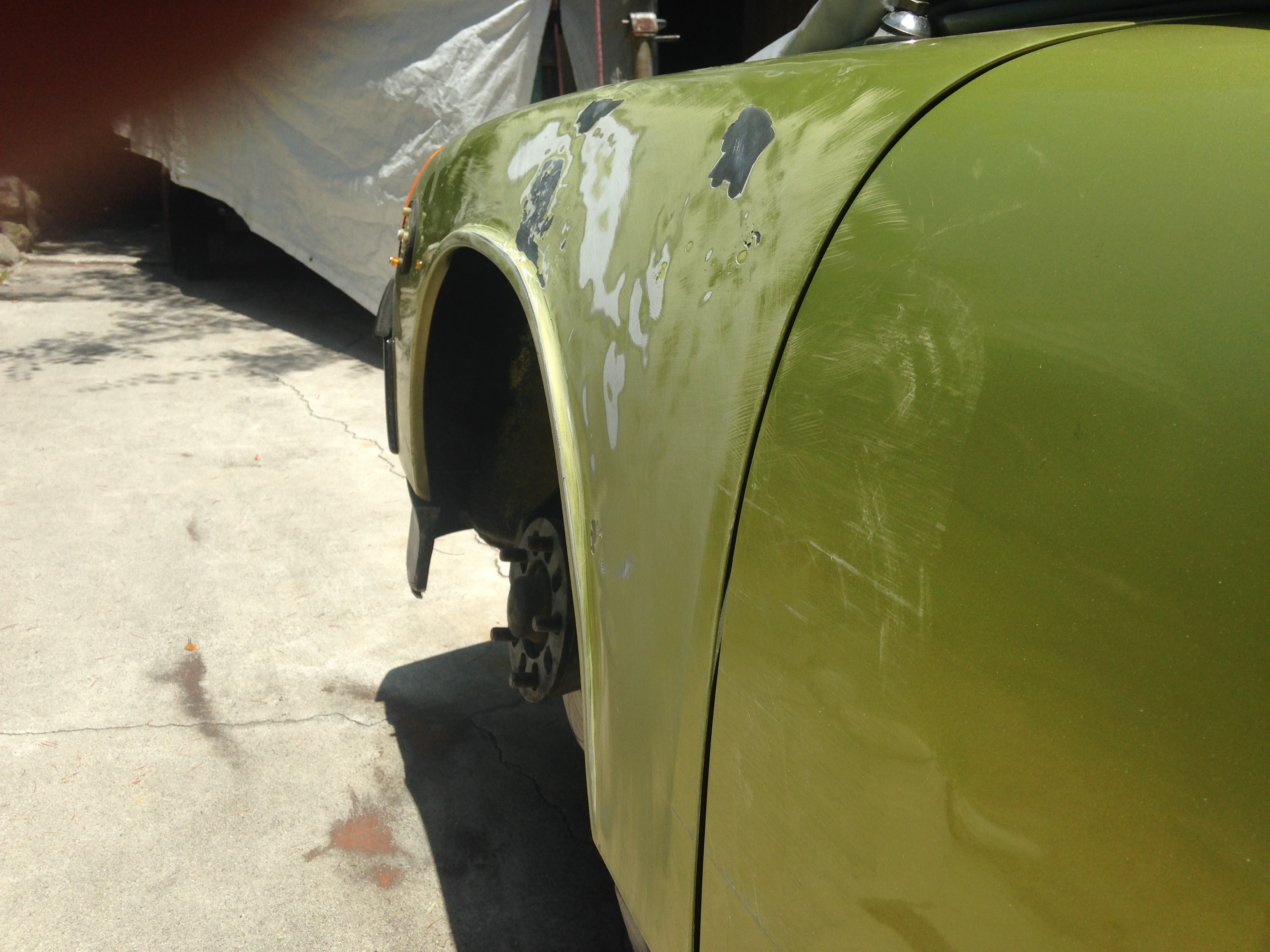

Here is the front fender after some hammer and dolly work.
yeahmag
May 19 2014, 05:37 PM
yeahmag
May 19 2014, 05:38 PM

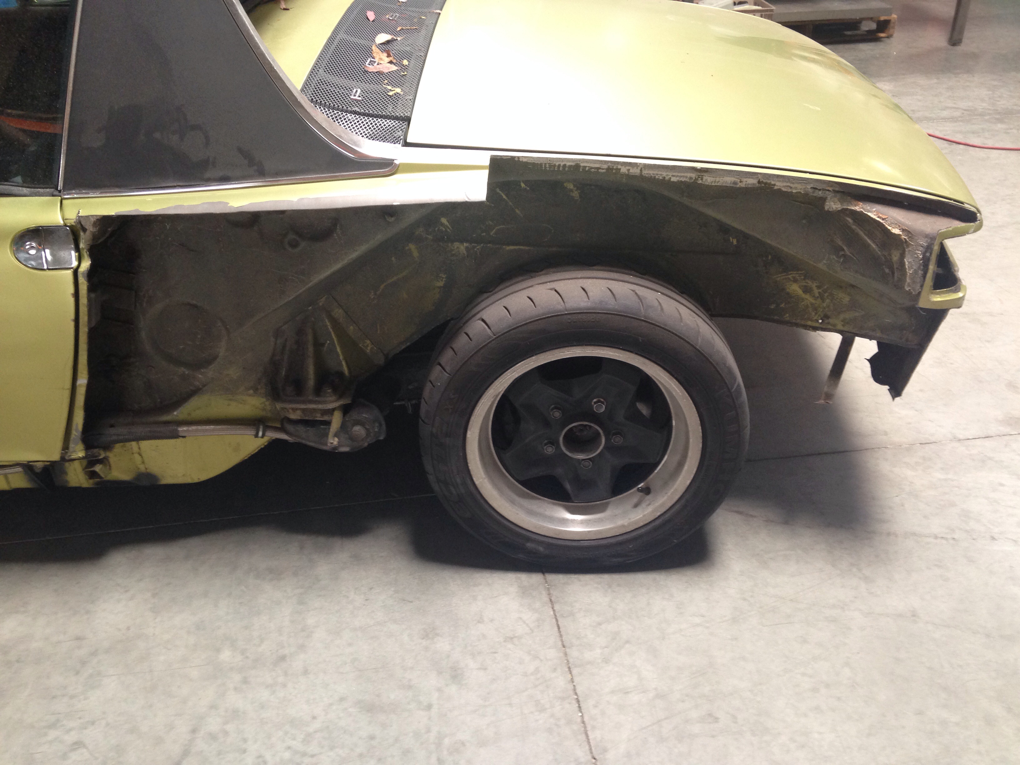

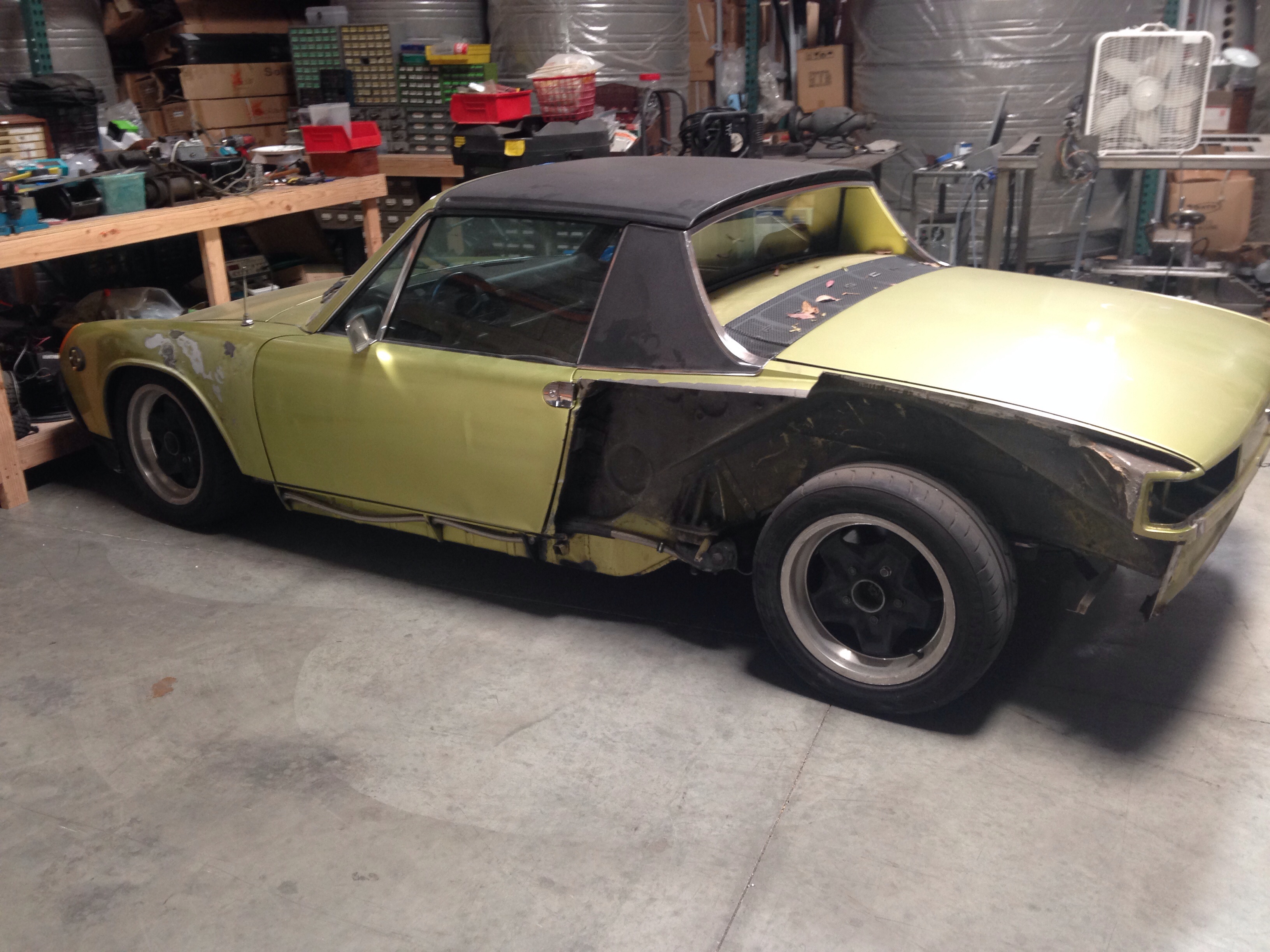

I think the rear quarter is a goner though. I'm trailering the car to a buddies house who is a metal master with the assumption that we will cut and replace.

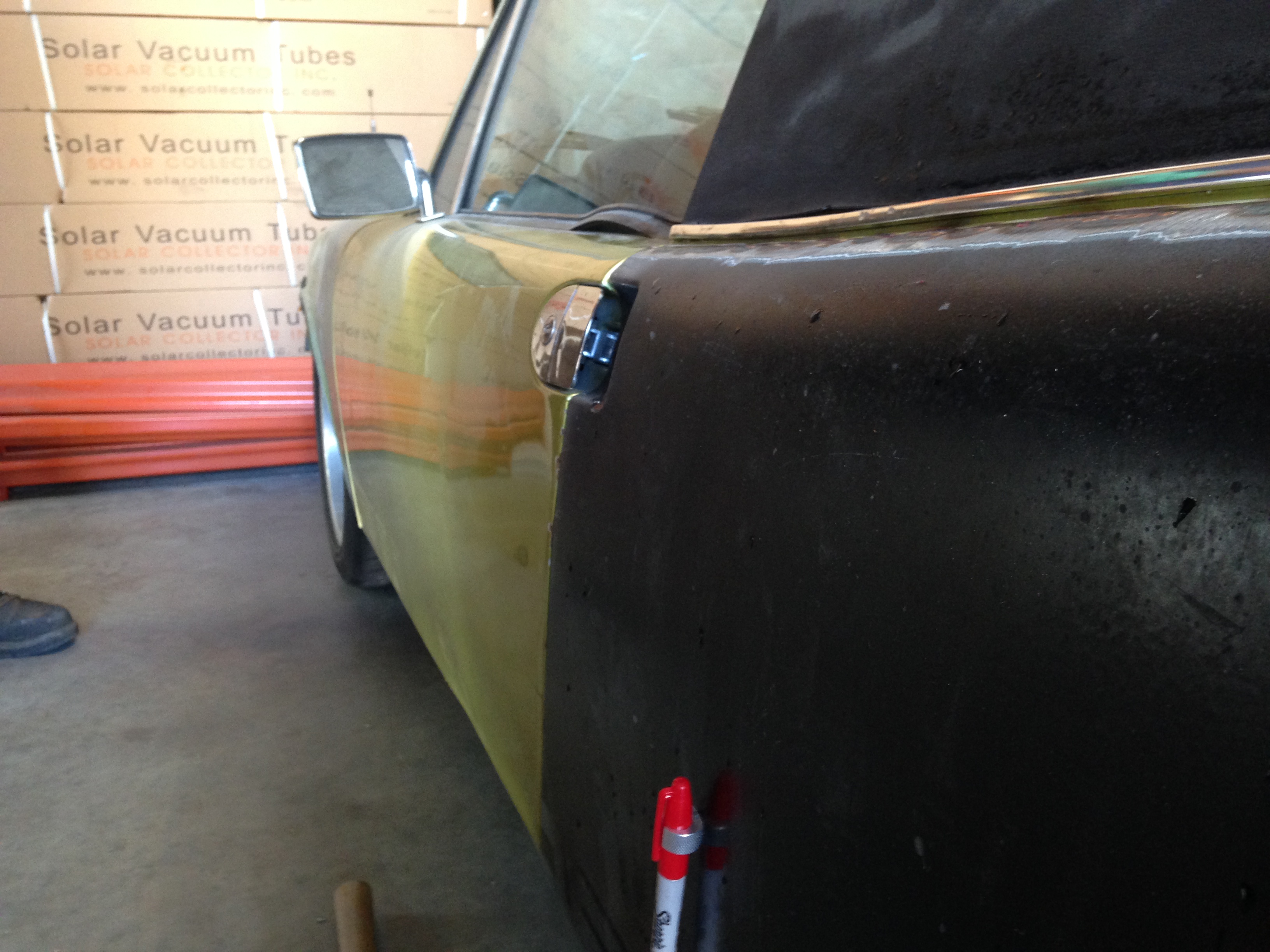

Spare panel is cleaned and ready. Starting work on the car itself.
yeahmag
Jun 8 2014, 04:58 PM
Just some loose cuts to help start fitting the new panel.

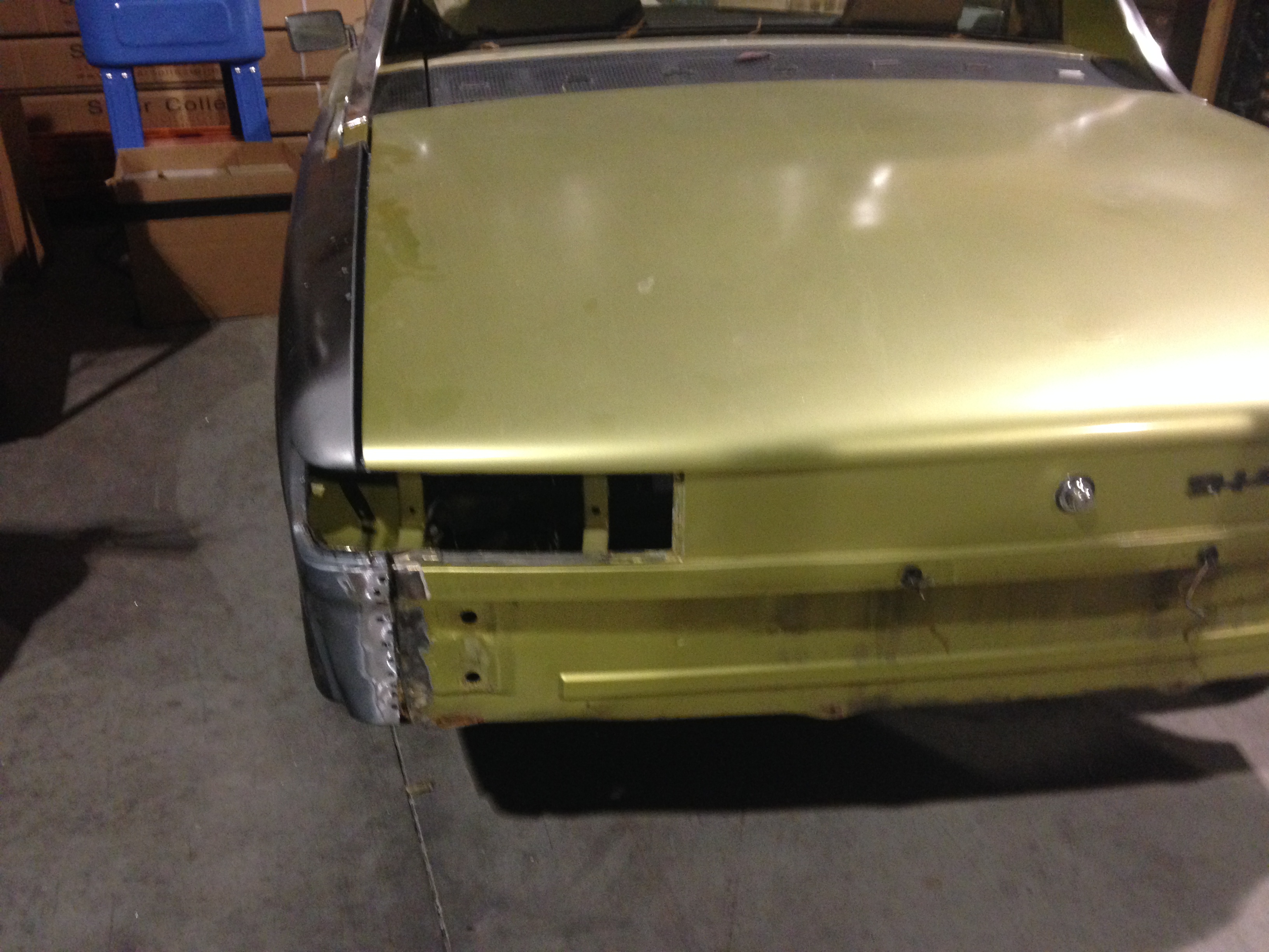

Jun 17 2014, 10:57 AM
Test fitting has begun.

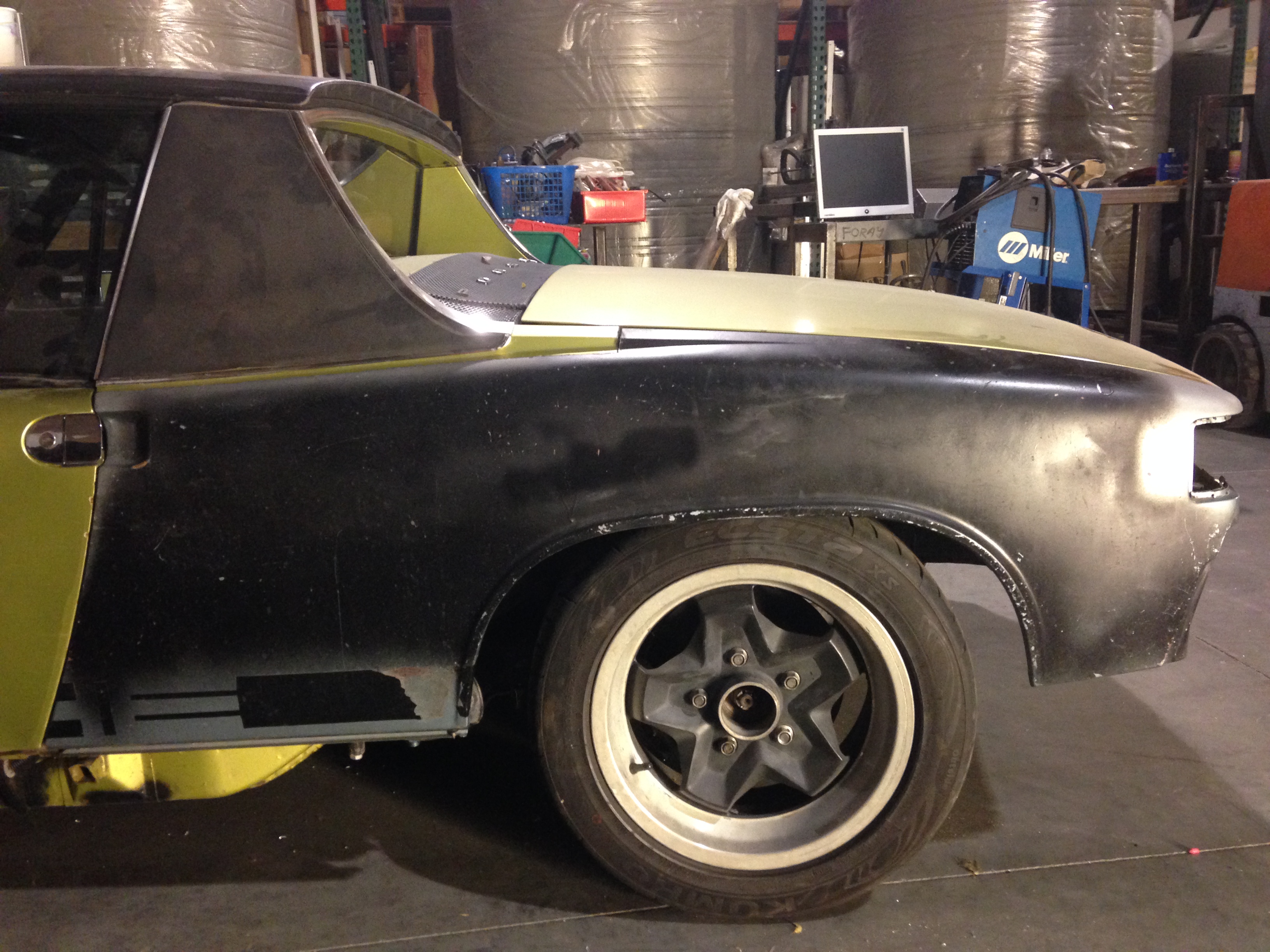

Jun 27 2014, 03:24 PM
A few more pictures of us fitting the replacement panel from last night. Getting close now to welding.

Socalandy
Jun 27 2014, 03:34 PM
Nice work!!!
rick 918-S
Jun 28 2014, 02:57 AM
Looks like its working out fine!

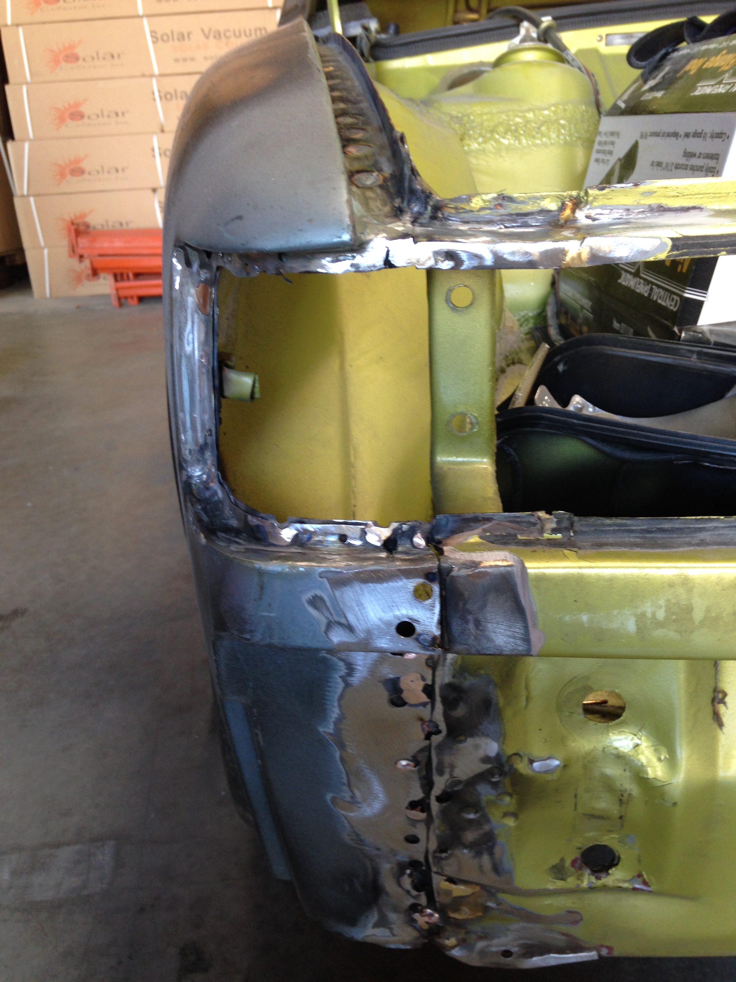

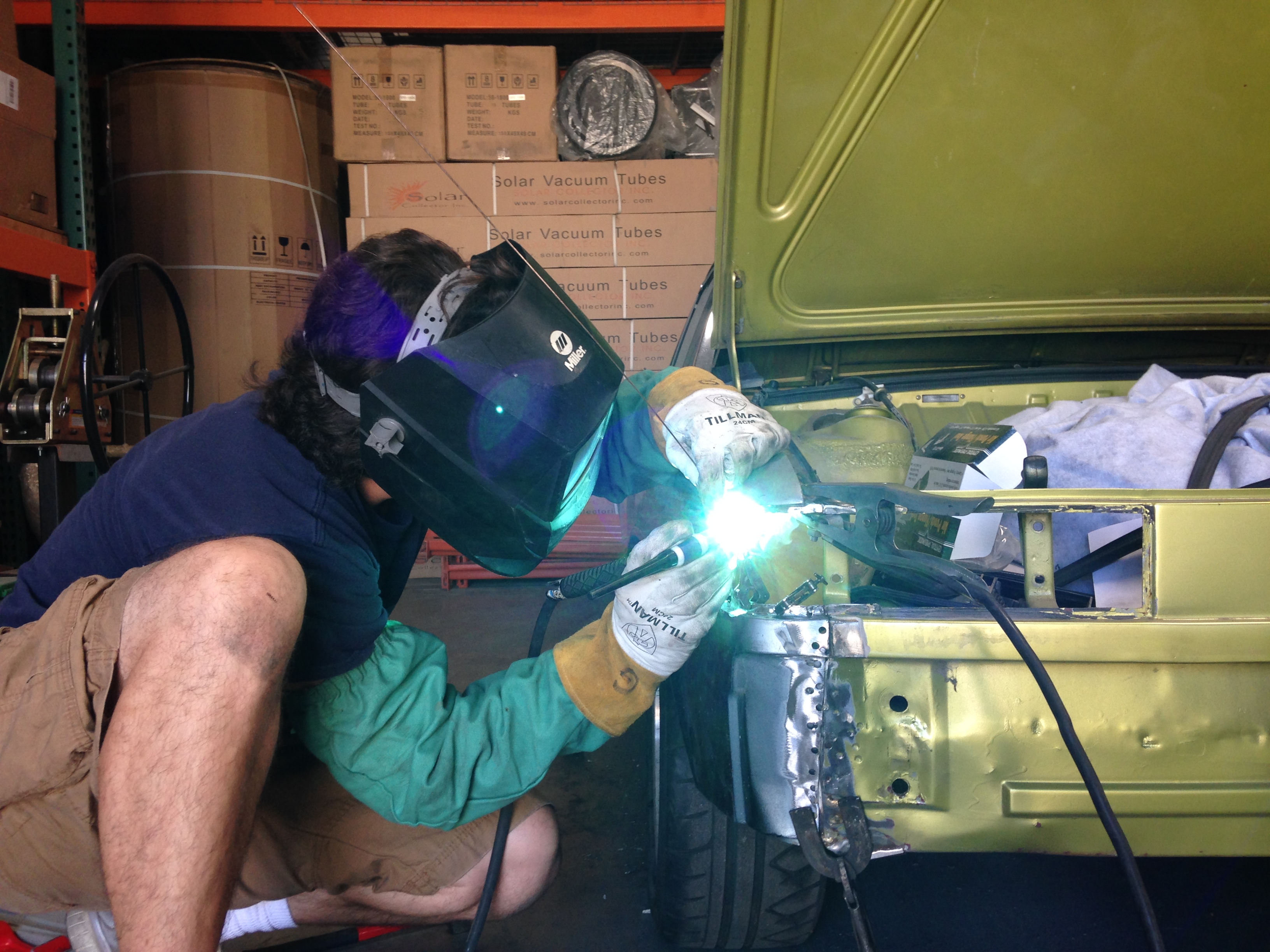

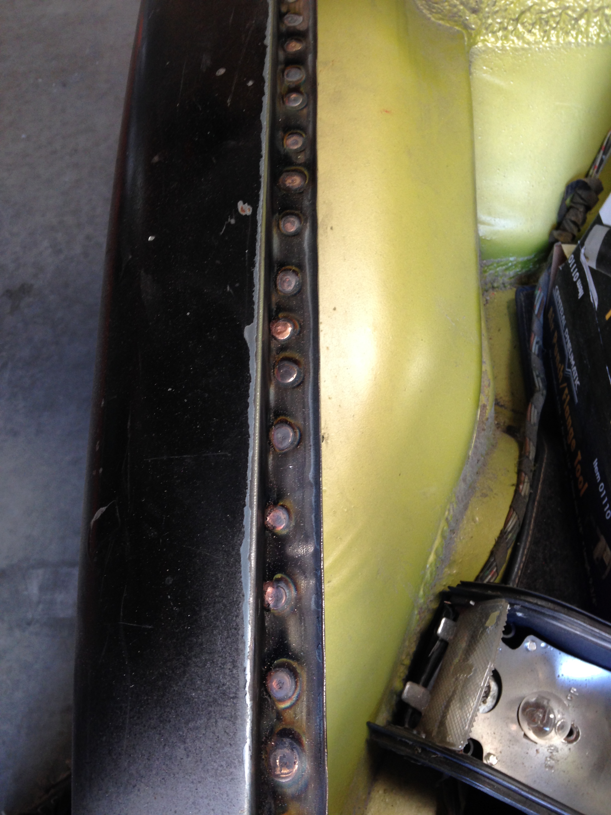

Aug 4 2014, 03:56 PM

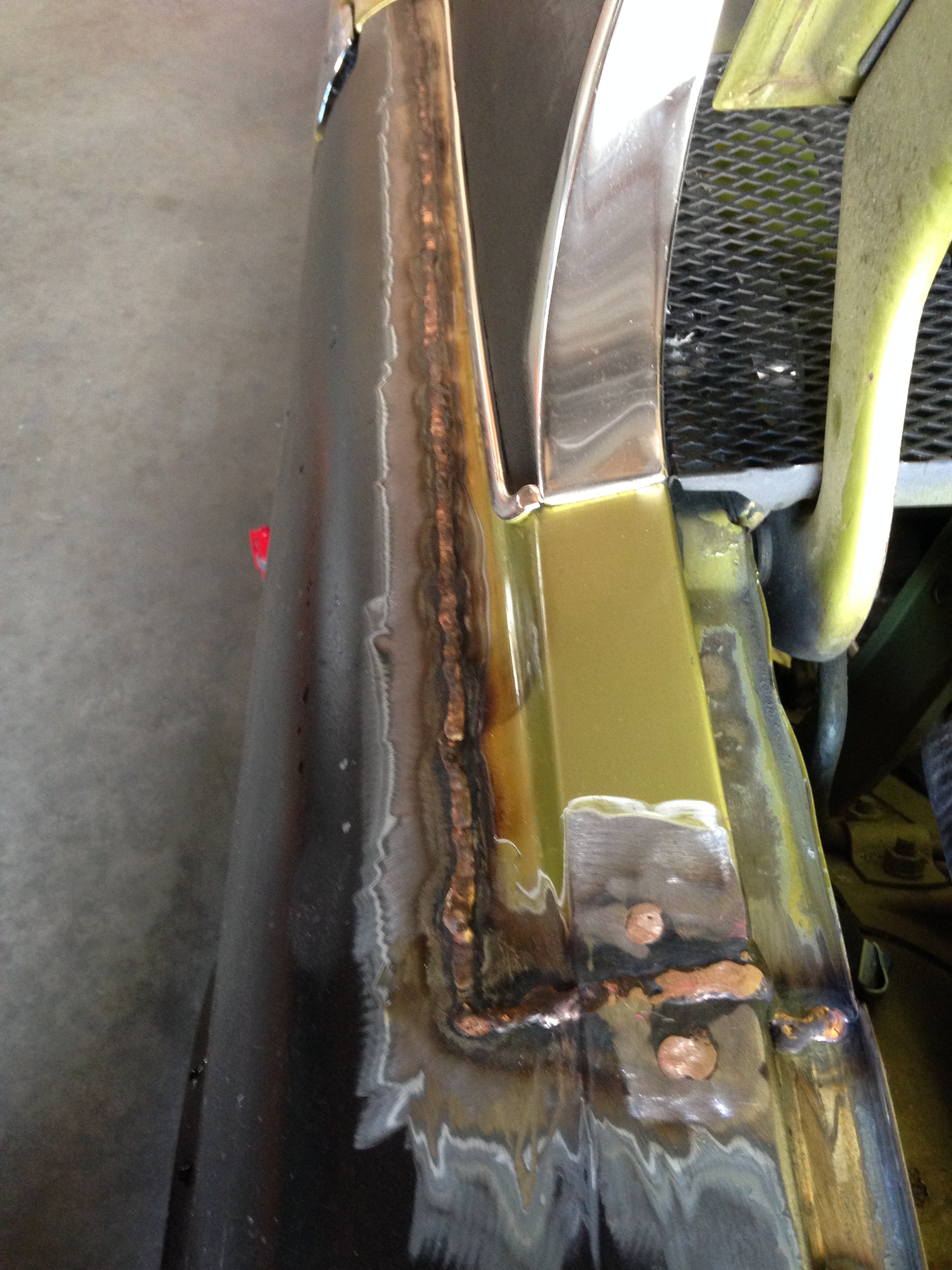

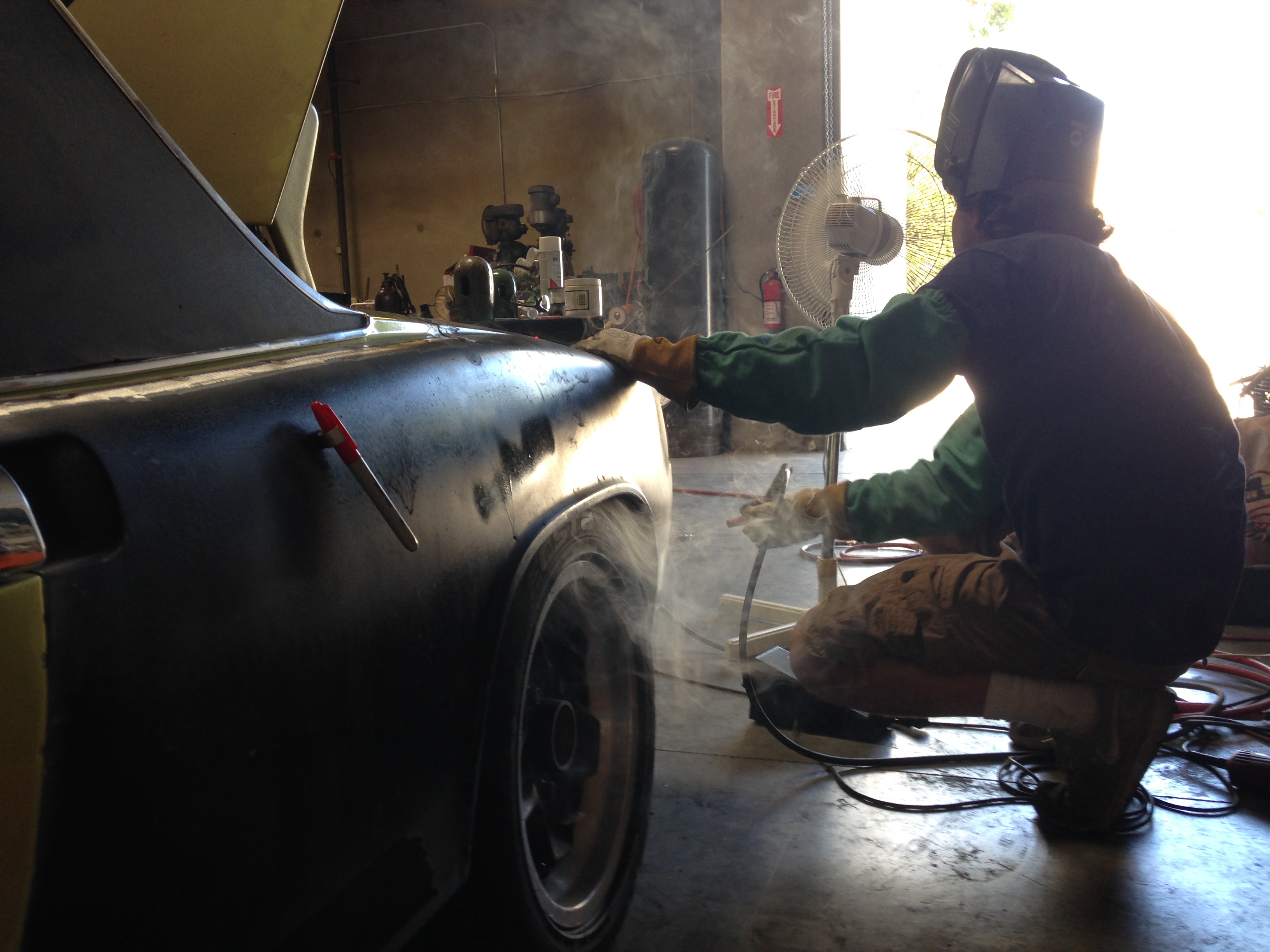

Trial fitting is over and we have started welding. We are using TIG with silicone bronze rod.
yeahmag

Aug 4 2014, 04:17 PM
Starting to work on the tail light/bumper sections.
914_teener
Aug 4 2014, 05:00 PM
It looks really good Aaron.
If you are going to grind down those welds....
I don't recommend Evidure for any structural stuff. It is great for bonding body panels and such.
It doesn't have the same shear strength and will crack over time.
yeahmag
Aug 4 2014, 05:05 PM
Never heard of Evidure...
I am going to grind them down and skim coat them. I'm planning on welding in the Mad Dog Motorsport inner long kit, installing the new trailing arm roller bearing bushings, alignment/corner weight at Iron Canyon Motorsport, and then a round testing the car before making it pretty. After I thrash her around the autocross course a few times I'll gussy her up a bit.
914_teener
Aug 4 2014, 05:14 PM
Sorry....I'm getting old.
I think it is spelled Everdur....Silicon Bronze welding wire. That is what I used to call it.
It flows really nice and you'll get lower weld distortion on the body panels, since there is lower heat input.
Any structural stuff like longs and the such, I'd use regular welding wire for that purpose.
yeahmag
Aug 4 2014, 05:19 PM
Ah... I've had really good luck with the stuff (whatever we are using) for mounting things that WOULD normally crack over time. I've used it for all kinds of tab mounts with great success. My welder is really, really good, so maybe he has some magic stuff.

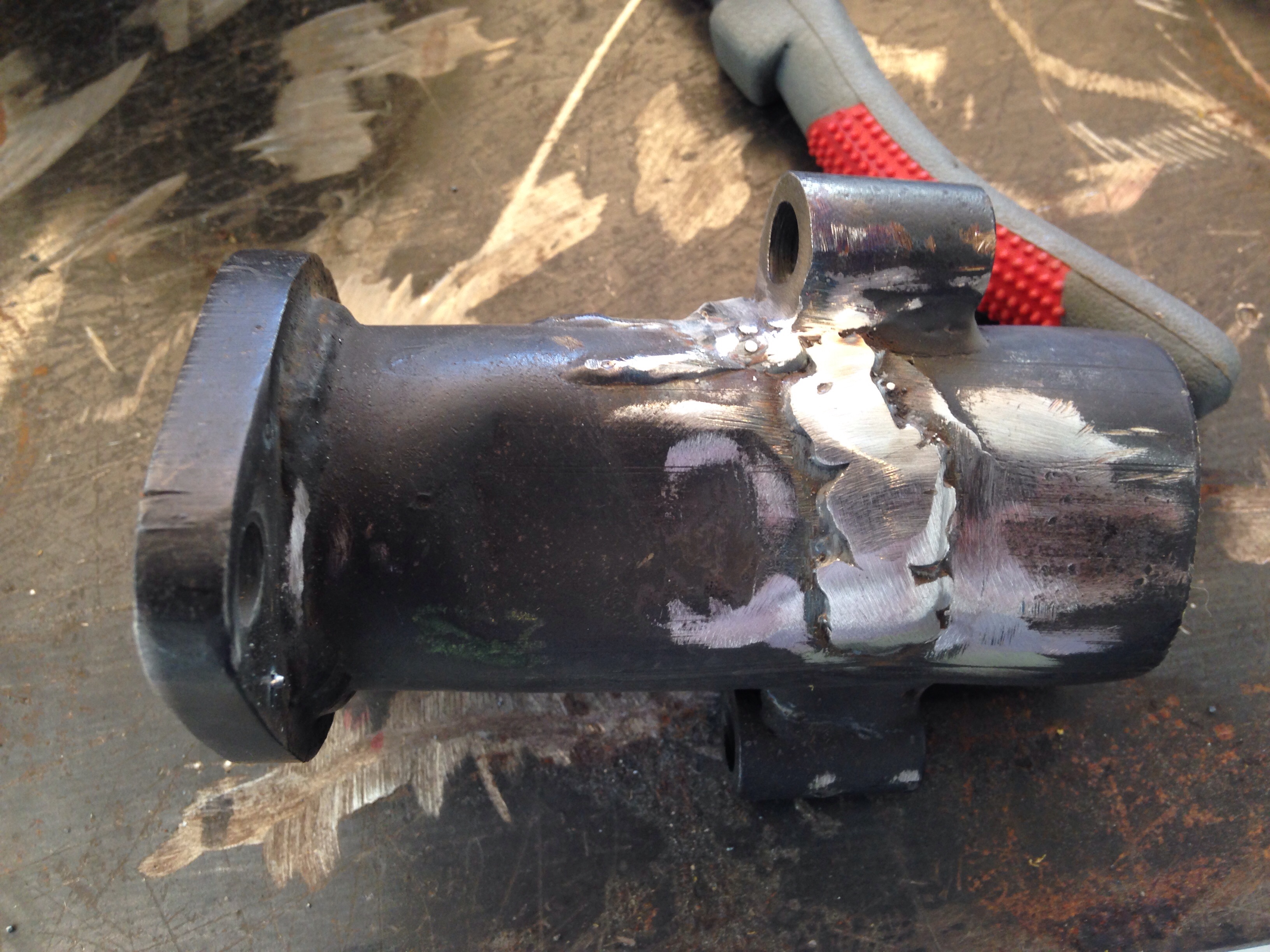

yeahmag

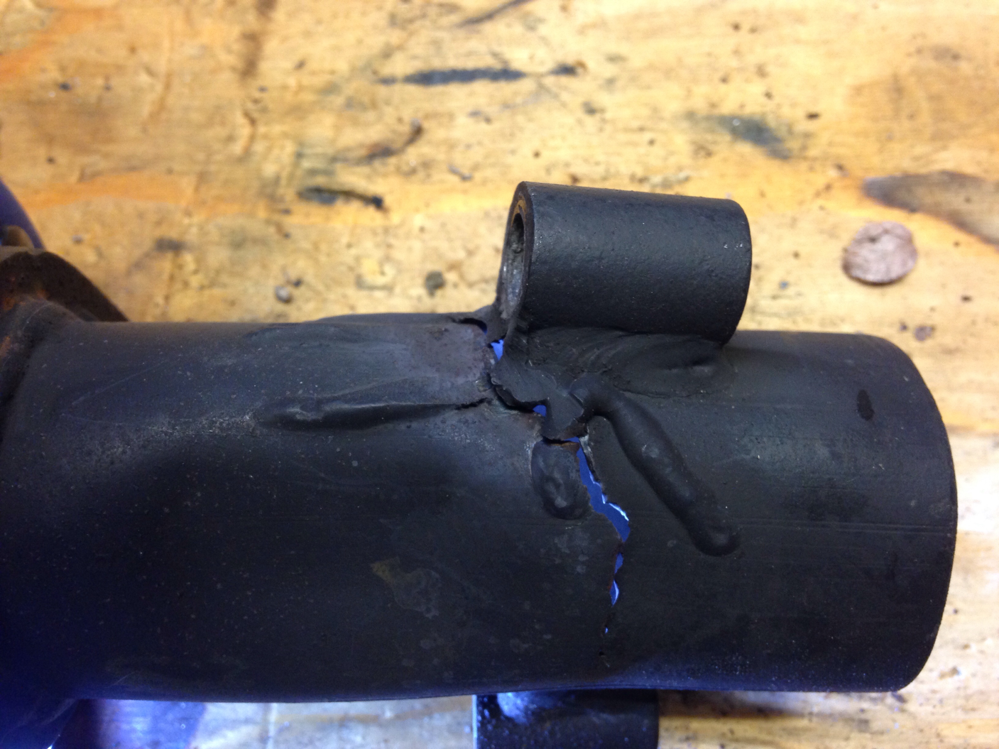

Oct 27 2014, 07:38 PM
Turns out I had a cracked/torn stub pipe too. Used the shop vac to find it!
yeahmag
Oct 27 2014, 07:39 PM
And here is what I found.
yeahmag
Oct 27 2014, 07:42 PM
I drilled the ends of the crack/tear to relieve any stress and welded it up. I re shaped the oval and made sure it was flat. No leaks!

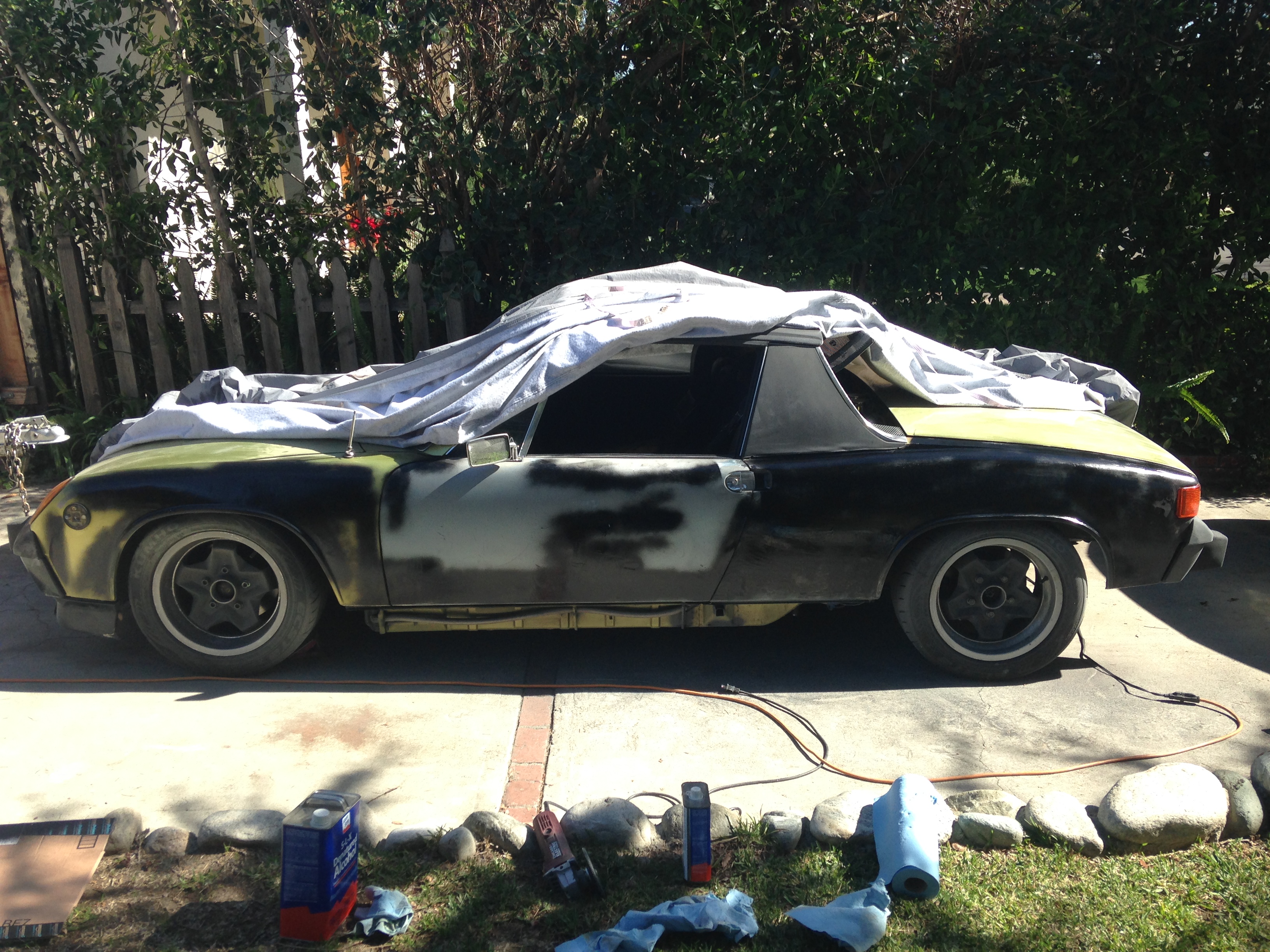

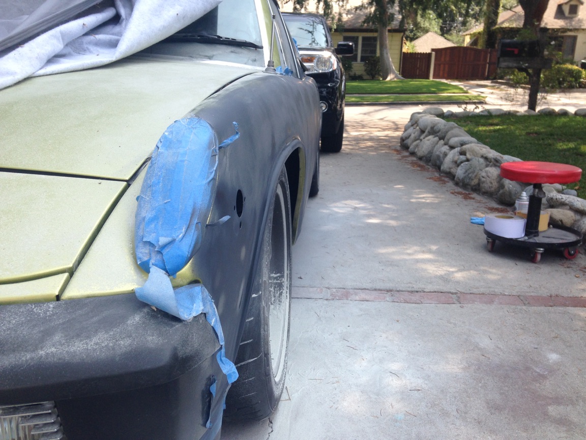

Feb 2 2015, 03:38 PM

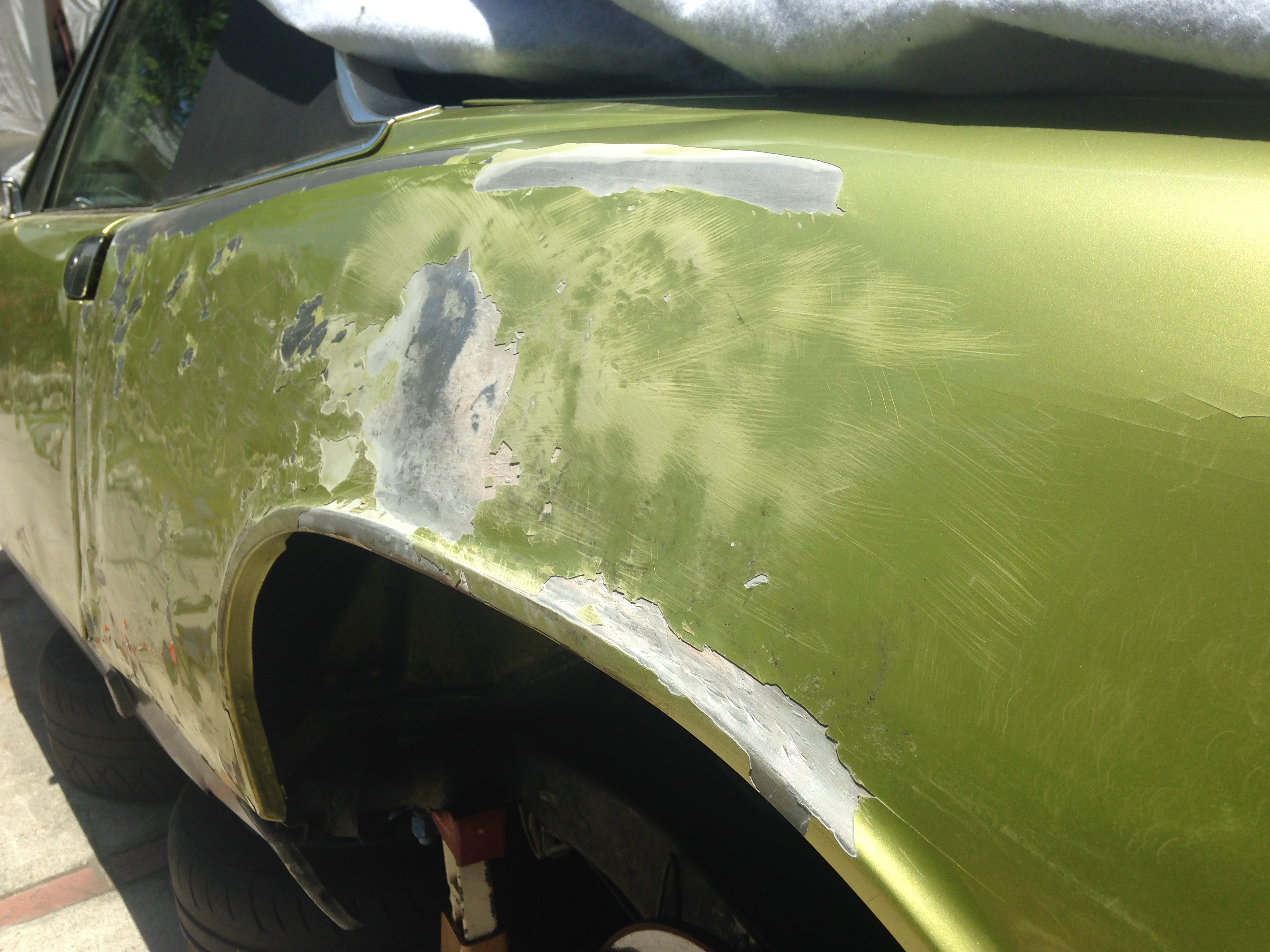

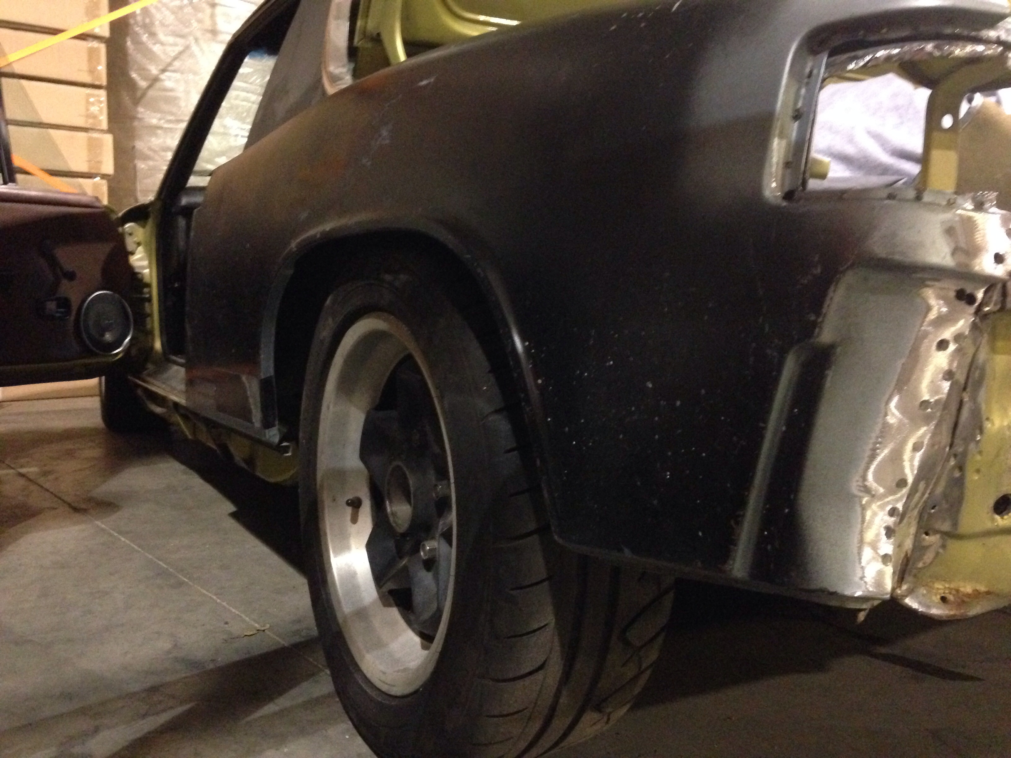

Finally got some time yesterday to make some headway on the finish work. Used the angle grinder and a flappy paddle sanding disk to take of any runs/drip/defects and the weird, gummy black spray paint that the rear quarter came with.
yeahmag
Feb 2 2015, 03:39 PM
After sanding I laid down a guide coat. I've got good sanding blocks on order... Progress.

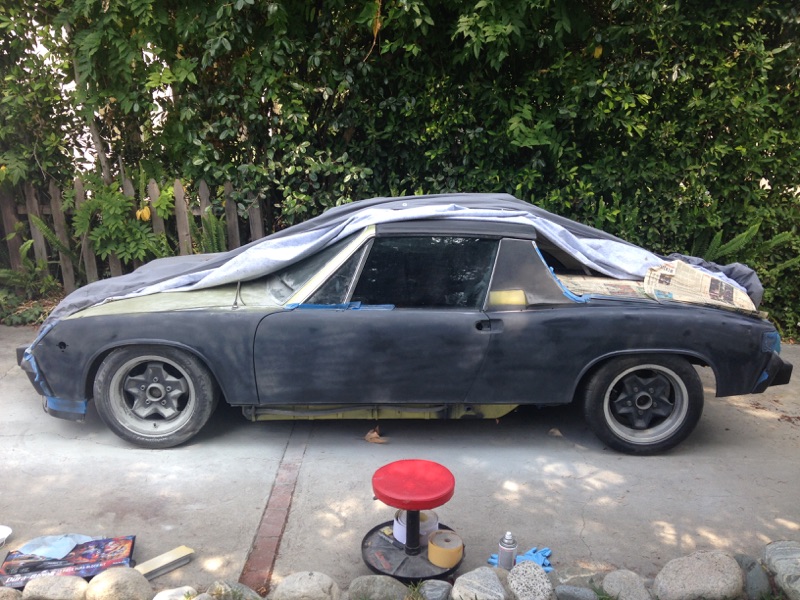

yeahmag
Jun 15 2015, 12:41 PM
Closer still... Going to use some 2 part glazing to get some of the finer bits taken care of then do a once over the rest of the car.
