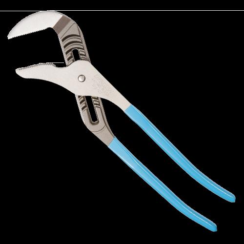

tommy914
The tool I use.
messix
cheap ass harbor freight pipe wrench
r_towle
Pipe wrench or the proper strut wrench.
