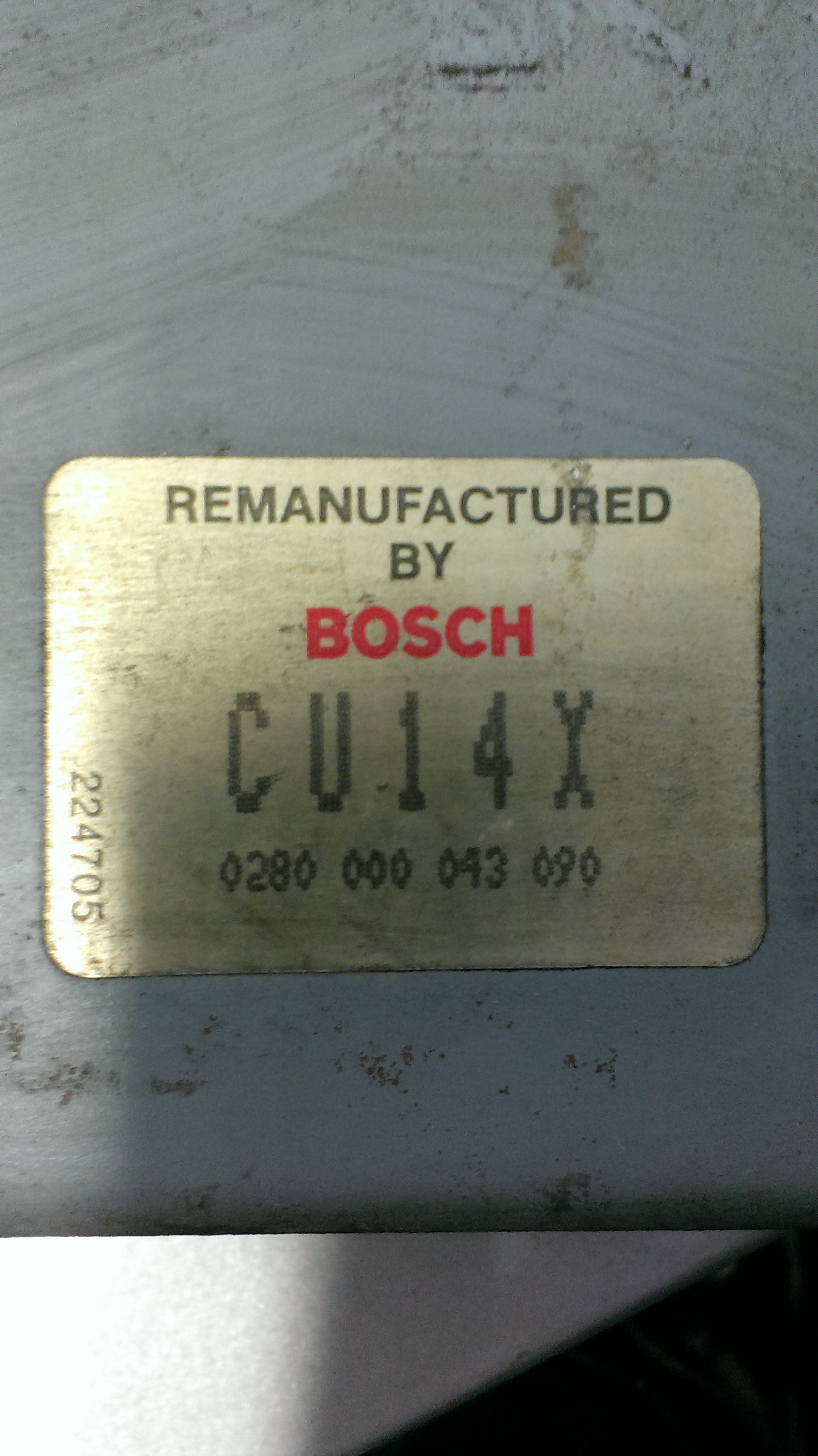

I have a similar question on my '74 2.0.
The P/N on my ECU match those in the table from link. However, there is a three digit number (090) after the part number. Does anybody know what the 090 represents ?
zambezi
Not to hijack this thread but have a question that might be relevant for others wondering about ECU issues. How can you determine what the ECU number is if there is no longer a sticker?
