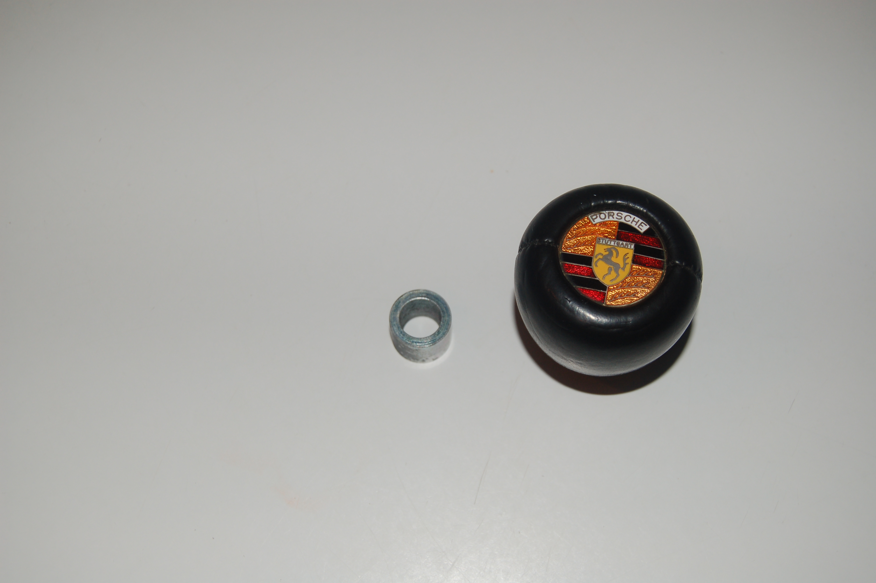

I have a old leather covered wooden gear shift knob and the bushing (pressure fit) has come out of it.
I'm going to epoxy the bushing back in, but was wondering if that pressure fit bushing needs to be "oriented" in any particular direction.
IE - is it tapered?
Thanks,
Len

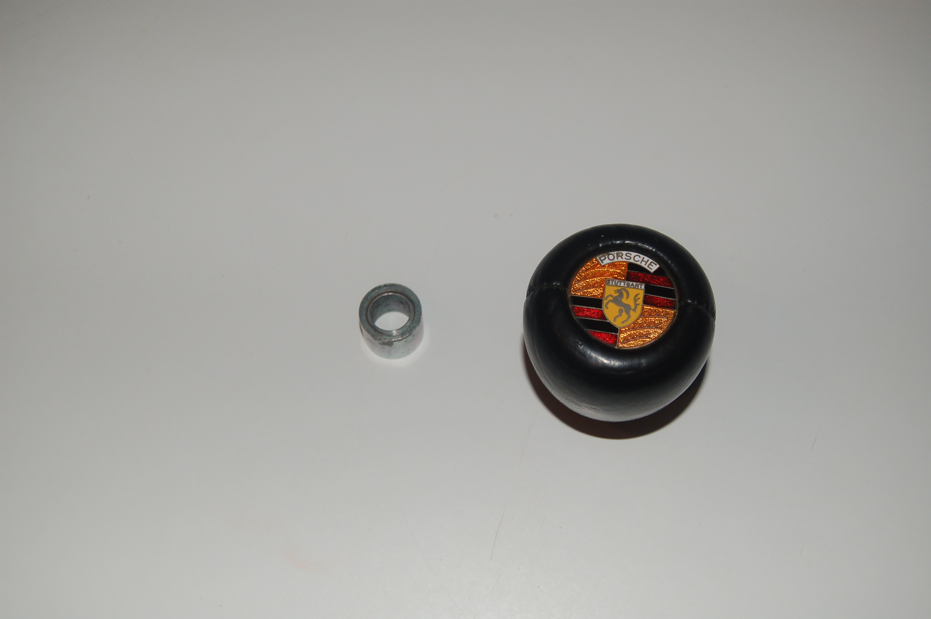

Should just be a crush washer. Post a picture of what you are calling a bushing. Epoxy is one way to fix it but if it is truly a crush washer then then I would not epoxy that on to the shifter.

Here are two pictures of the bushing / and shift knob. The bushing is flipped from one photo to the next.
The bushing needs to be epoxied back into the knob and I was wondering about orientation of the bushing - or if it even matters.
I can test fit just the bushing - I suppose and see.
I'm not intending on epoxying the thing on the shaft, just inside the knob.
Click to view attachmentClick to view attachment
