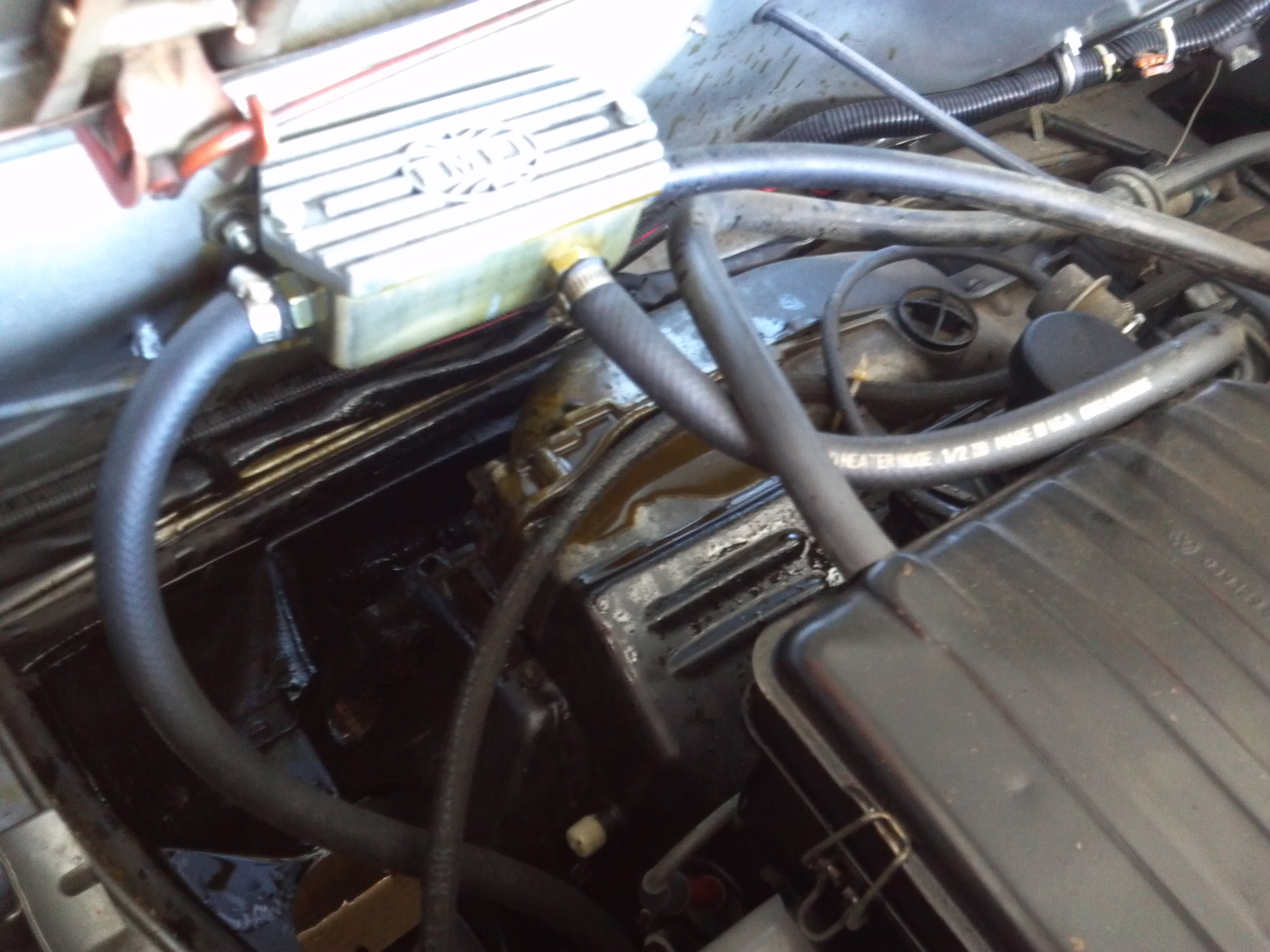

Now this: Attached is a silver box located on my fire wall, used for crankcase pressure. I think its there from when the car was carbed, but the PO had installed Megasquirt FI, but there are still three hoses running to this. It has always been 'oily' but never really leaked. I checked the hoses and wiped it off. They seemed tight. Again, never any real problems from here, so I thought all was good.
After a few miles of spirited driving, I get home and saw the attached. Oil everywhere, pooled on engine, splattered on firewall, etc. Pretty sure it is all comgin from here.
My question is, if the hoses are indeed tight (i did not touch them), what would cause this? Pressure overload from the crankcase? Too much oil?
IM at a loss.Click to view attachment

Looks like u put to much oil.
malcolm2
Maybe when you checked the oil, you did not fully seat the stick and it looked low....then added more and you are over filled. You can't tell where it is coming from? Clean it up and get a helper to start the car and you watch for drips or an oil spray.
#2. The silver box is not supposed to hold oil, right? Just oily air flowing around and eventually burning off? If so, it seems that a hose is blocked and the oil is pooling up in the box and leaking out.
Maybe, since it sounds like you don't think you need the box and did not put it there yourself. Take it off as a troubleshooting measure. You can always put it back.

Thanks, maybe I did overfill.. Will check when it settles more.
I did let it idle for 5-10 minutes before I left the house and nothing was leaking, seemed to only happen once I got out driving it.

if like other breather box styles, the empi breather box would have a piece of foam in it that helps control the vapors. the outlets are slightly above the bottom of the box and oil will pool in the bottom. squeezing the oil out of the foam and mopping up the inside is part of regular maint. check to see if the foam is in there. running djet the bb should be unneeded and vapors controlled via the pvc valve and the port to draw off said vapors. time to go back to the stock system.
72hardtop
Make sure you don't kink the breather box hose too much. (hose to puke can)
Could also be crank seal on cooling fan side.

Good call guys, oil seems to be overfilled, not sure how I let that happen. I am going to change the oil tomorrow with the proper amount. All oil looks to have came from only the breather box, so hopefully nothing else is damaged. Gonna open that too and clean it out if needed, thanks for the info.

Just dribble half a quart out of the drain. The other half already came out
Jake Raby
Those boxes lack volume for an engine bigger than 1500ccs... That, and if you have that much volume in the breather you've probably got some worn parts internally and have excess crankcase pressure from it.
The higher the RPM and the hotter the engine, the more significant these symptoms will be.
