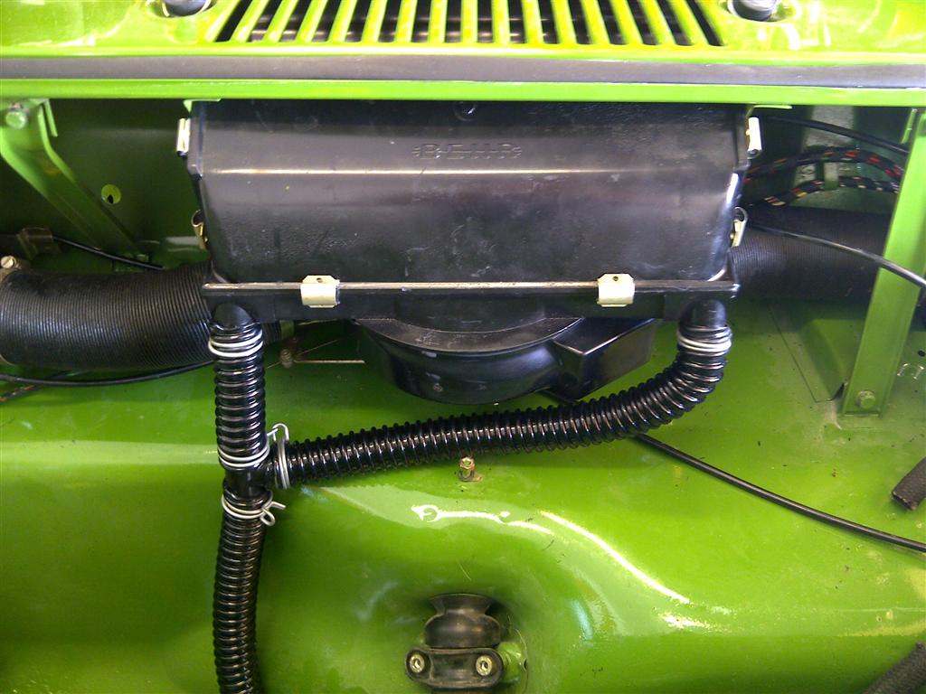

That is what I used. This is a picture (only one had) of the same hose up front.

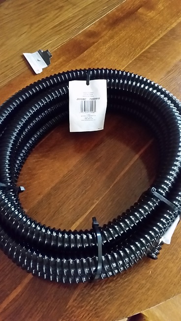

Grabbed a tape measure before I left.
cary

QUOTE(cary @ Sep 21 2014, 06:56 PM)
I bought the thicker stuff. It is difficult to work with, but might last an extra long time. IIRC I did not have to use the clamps on the engine lid cause the stuff is stiff.
After I bought 20' and used 6 of it, I realized that it came in the vinyl style. I even had some for a rain barrel that I installed and accidentally bought 2 diverters. I consider myself a "closet" environmentalist.
If I were to do it again, I would go with the thinner, rain barrel material vs. the thicker fish pond material. Just my 2 cents for future lookers.
I have plenty of the stiff material if anyone is interested.

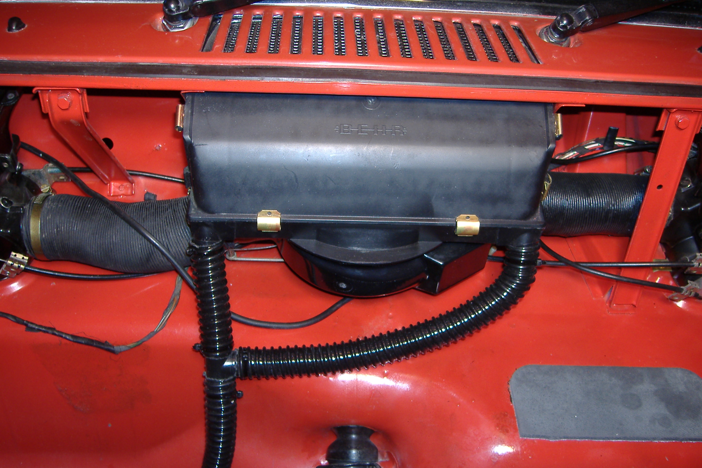

EdwardBlume
Sep 24 2014, 08:41 AM
This is what I did and plus it's shiny!

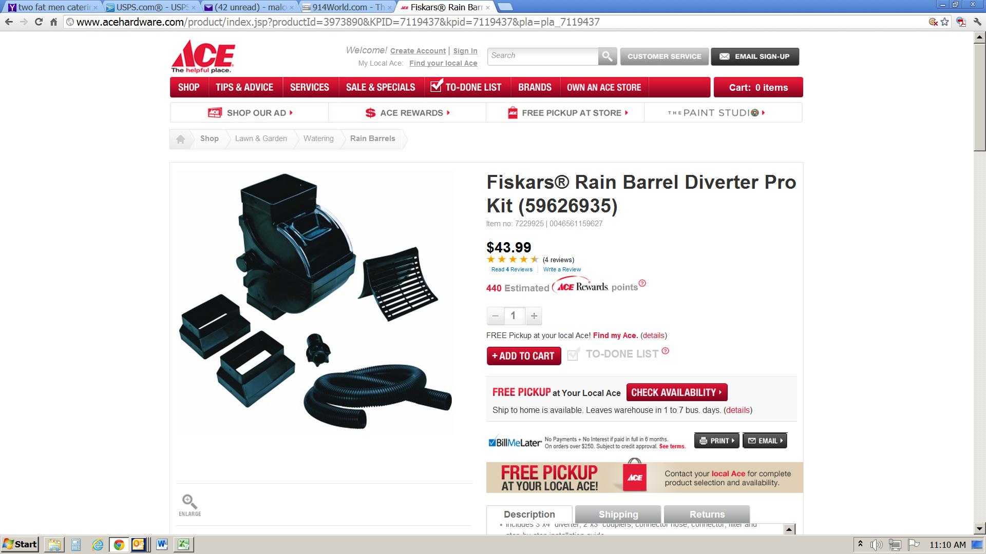

malcolm2
Sep 24 2014, 10:12 AM
QUOTE(cary @ Sep 24 2014, 08:56 AM)
Goggled rain barrel drain tube .............
http://www.sears.com/sears-universal-hose-...p;mktRedirect=yNo info on the ID. Looks like it would close.
IIRC I bought a diverter online, but did not want to pay to have the barrel shipped. Ended up getting a barrel at Ace hardware that came with the same model diverter in the barrel.
Ace Hardware diverter by FiskarsClick to view attachmentYou are right tho, I never have checked the ID. Right material, but I'll need to dry fit it to be sure.
