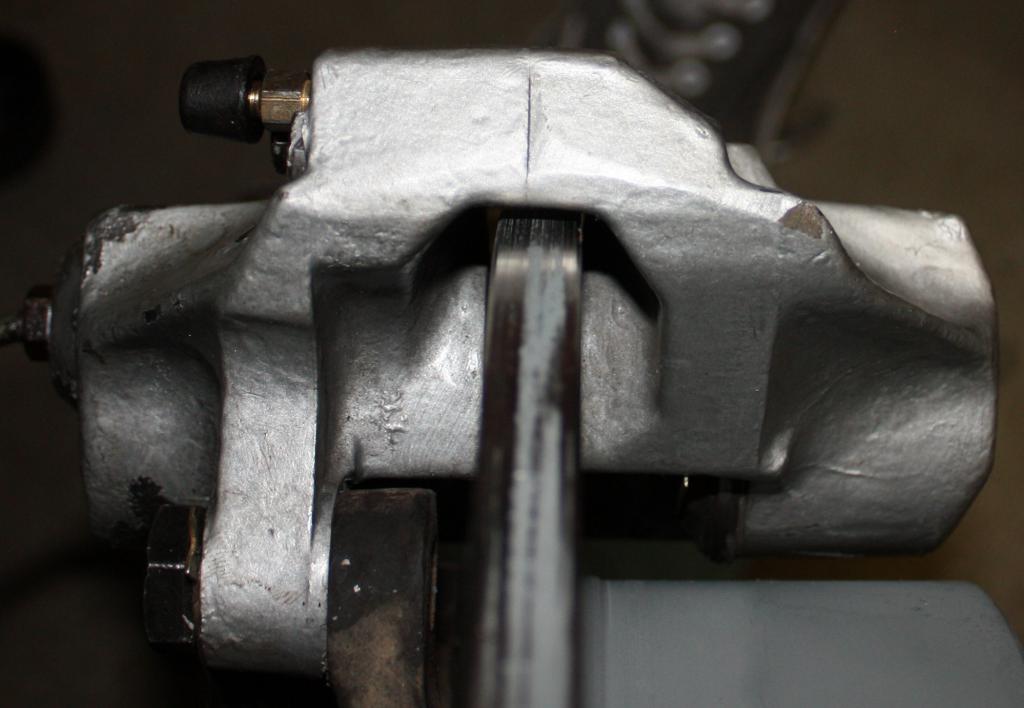

I dont remember the clearance being so close when I took it all apart.
Is this normal?
IPB Image
I can only fit about a .001 feeler between the rotor and the caliper on the outer side.
This is a 71 with what I thought we determined was a late front strut.
When I tried the early rotors, you could not even get close to putting the caliper on.
Now with the "late" rotor, the caliper just barely clears.
I thought maybe the wheel bearing wasnt seated all the way, but I re/over-torqued the nut to see if it needed to pull in any more, but that didnt help.

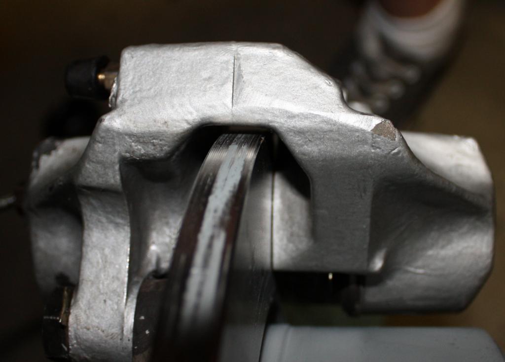

Here is another pic that shows how the rotor is not centered with the split line in the caliper:

Jeffs9146
Is it a 5-lug conversion?
stugray
No just replacing stock 4-lug rotors with off the shelf replacements.
It is acting like the bearing race didnt go all the way in, but I checked it.
I guess I'll try the other side before pulling it apart to look again.
infraredcalvin
Looks like you don't have much clearance on the inside as well. Either you have a 911 caliper with a missing spacer, or for some reason the rotors are too thick.
It's been a long time but I remember there being at least a mm or two clearace on each side of a new rotor (late calipers). Can you even get new pads in the caliper?
stugray
The back side has plenty of room (like 3/8").
I have not tried to put the pads in yet.
Eric_Shea
Stu,
It appears to be a bearing issue. What bearings did you use?
We've seen el cheapo aftermarket bearings (can't remember the name, starts with a K and in a greenish box) with improper inner race dimensions.
Verify again that your inner race is pressed in completely to the seat. Also, try fitment without the outer bearing in place. It will be wobbly at the end of the spindle but, it should let you know if there's an issue with the inner (most likely) or outer bearing.
Let us know the results. Also, let us know what bearings you used.
