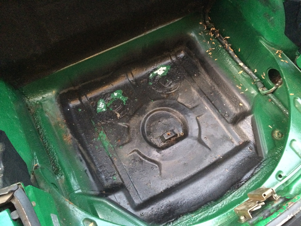

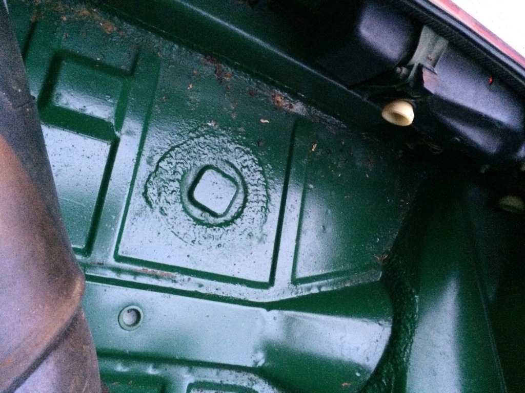

IPB Image
Mopped the water out and wiped it down. Someone said there should be a drain hole? Where would it be at?

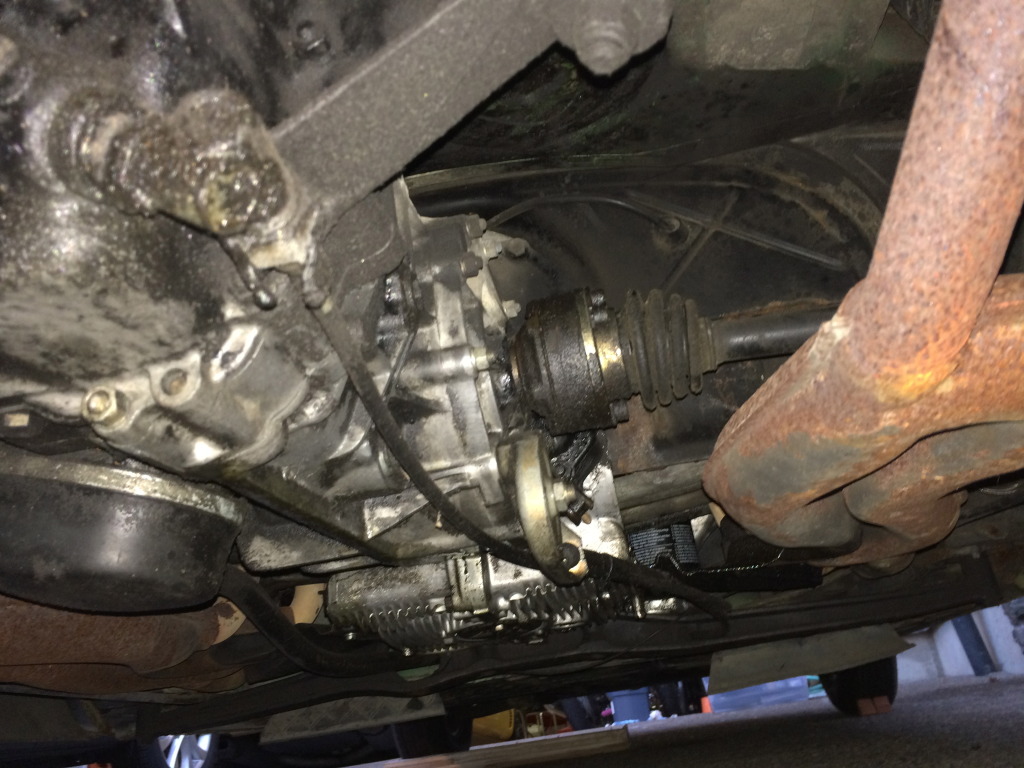

IPB Image
Shot from underneath.

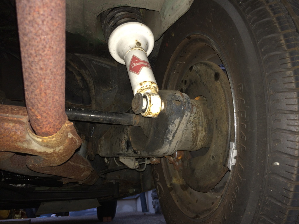

IPB Image
KYB Struts

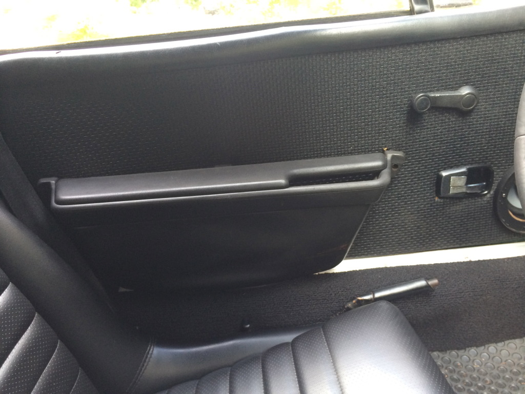

IPB Image
This was laying on the floor. What do you call this thing? Has a funny swinging door.

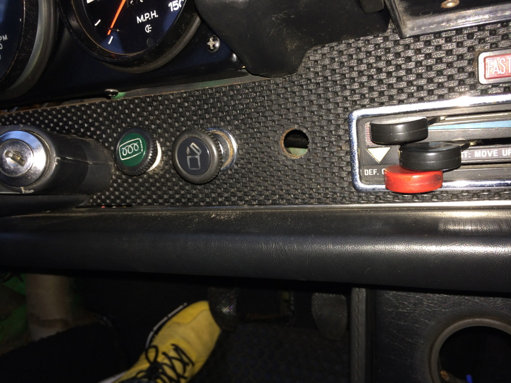

IPB Image
Something is missing from this hole.

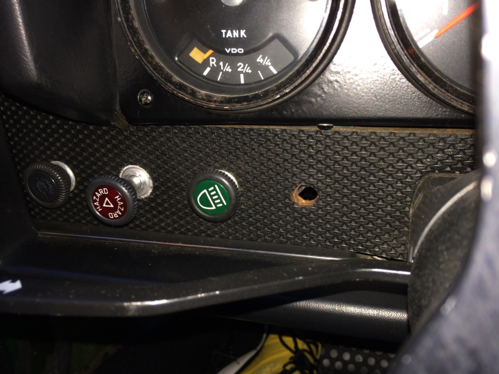

IPB Image
Here too.

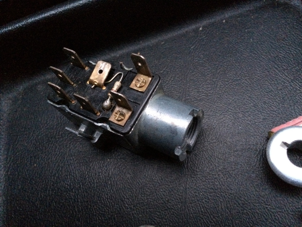

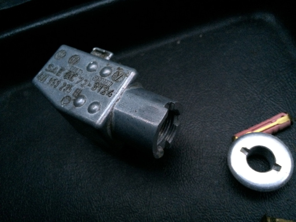

IPB Image
IPB Image
Not sure what this is… yet.

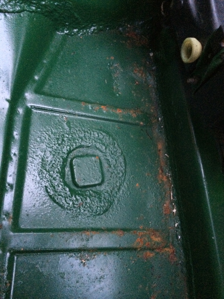

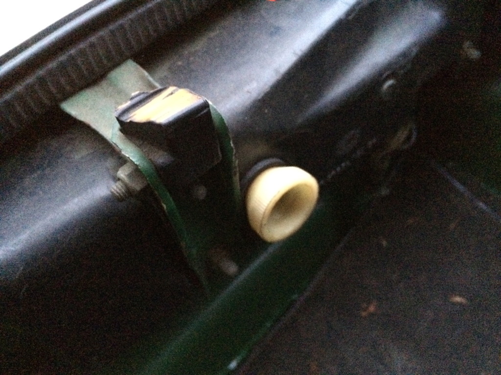

IPB Image
Tiny little bit of rust in the back trunk. Not even enough to get excited about.
IPB Image
Need a new rubber thing to hold the top. And by new I mean used.

It looks like your 914 might had air conditioning at one time. Why, it looks like someone replaced the floor pan in the front trunk when they took it out. I don't see a hole. Just drill a small one at lowest point. See yellow arrow in picture.
914Rubber makes the drain seal: http://shop.914rubber.com/Front-trunk-drai...cation-91DT.htm

Mark makes the rubber holders. New.

- on the picture of the pocket thingy under the dash on the passenger side, that is a driver's side door pocket that someone got creative with i guess barf.gif
the other picture of the rear trunk, it looks like a white knob, looks like the knobs that hold the rear tail lights in place. normal, the other thing is a rubber stop that the targa top sits on when it is in the trunk, looks like its broken off. - you can get these from Mickey at 914rubber.com -

Oh, that's the drivers side door pocket? It was loose on the floor so I stuck it under the dash to see if it fit. Then I took a picture for you guys to mock me. ;-)

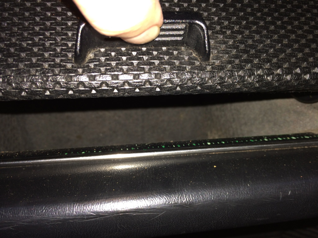

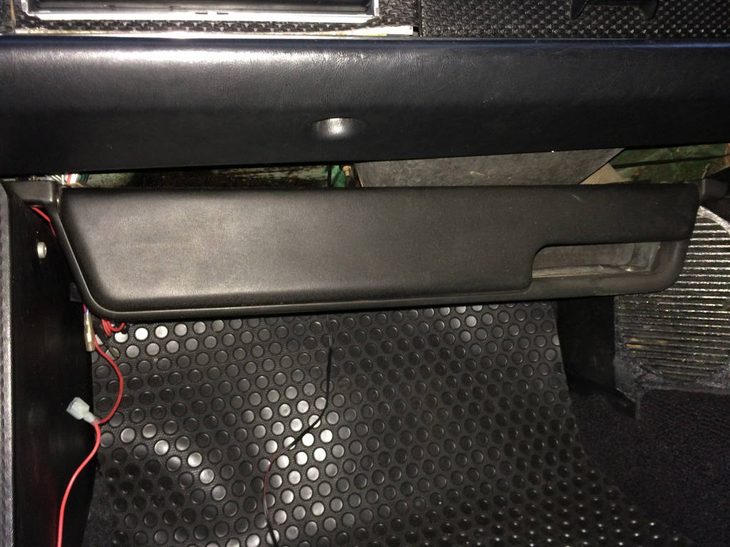

IPB Image
The asymmetrical armrests threw me.

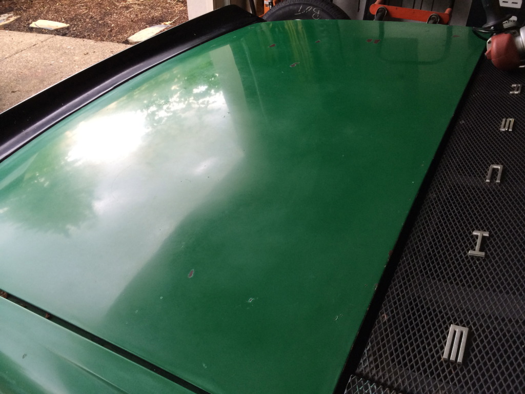

IPB Image

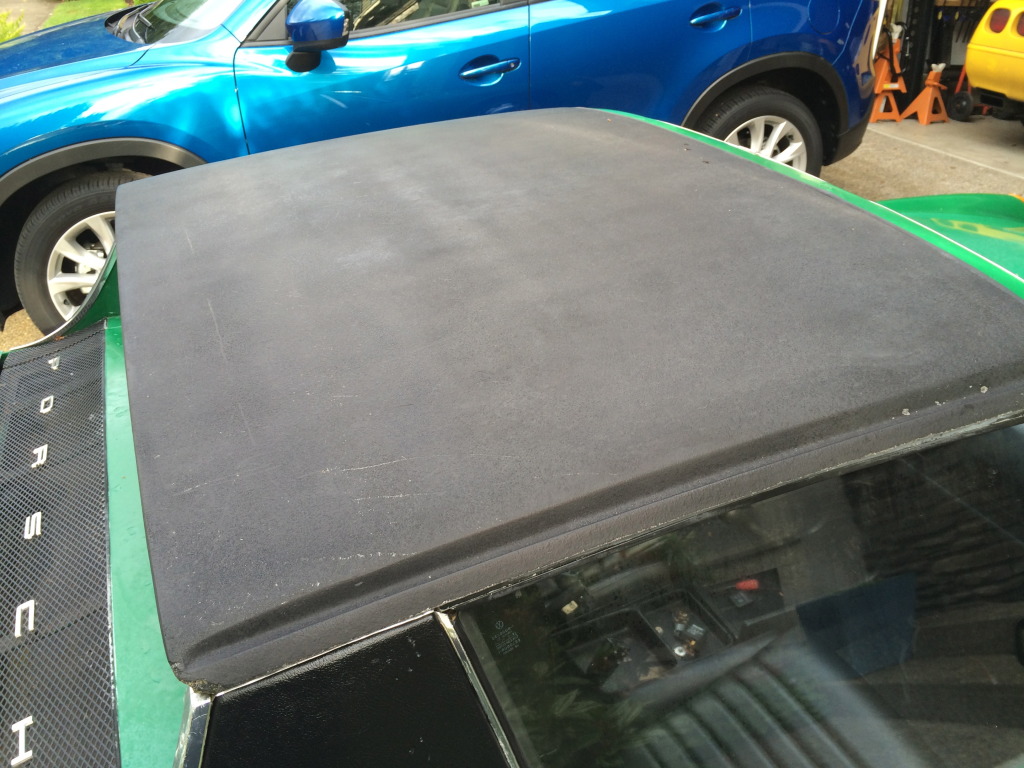

While I was at work the wife unit cleaned the targa top. Shhhhsh, I think it might be growing on her…

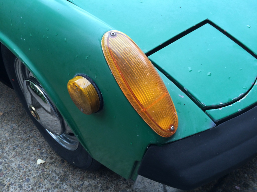

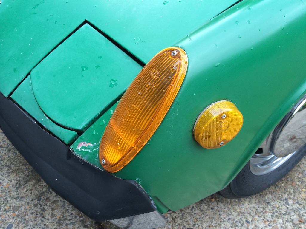

IPB Image
IPB Image
The right side lens have been replaced. I bet the fender had been munched at some time. What is the correct direction for the side lights?
Chris H.
Thick side should be closest to the front of the car. The drivers side looks like its backwards on yours. Very common. They are also marked "L" and "R" so make sure you have one of each and they're on the correct sides.

Is that daylight showing through in the KYB struts picture? At the front of the swing arm.
swooshdave
QUOTE(wobbletop @ Jun 17 2014, 01:16 PM) *
Yes, big hole under battery. I understand that is very common.
wobbletop
Not sure what this is. Yet.
Hazard Emergency Switch 411.953.235
swooshdave
QUOTE(wobbletop @ Jun 17 2014, 01:51 PM) *
The one in the dash works so this might be the old one or a spare.
Is there a website that you can plug these numbers in and see the parts? Or perhaps a parts book online?
There's a great one for BMW I used to use.

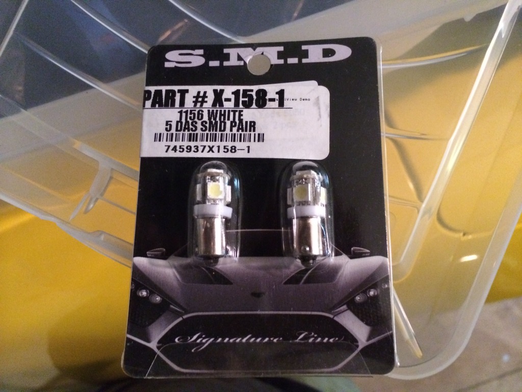

IPB Image
Need to do some research to see what these fit.

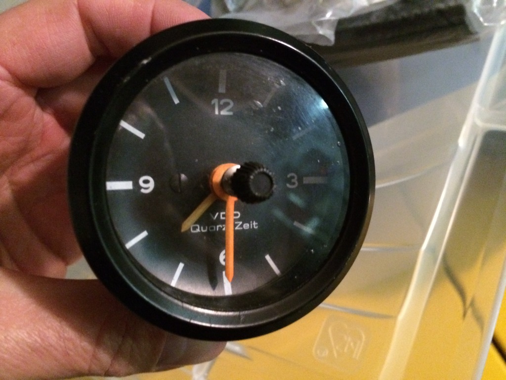

IPB Image
Clock to fill the hole in the console.

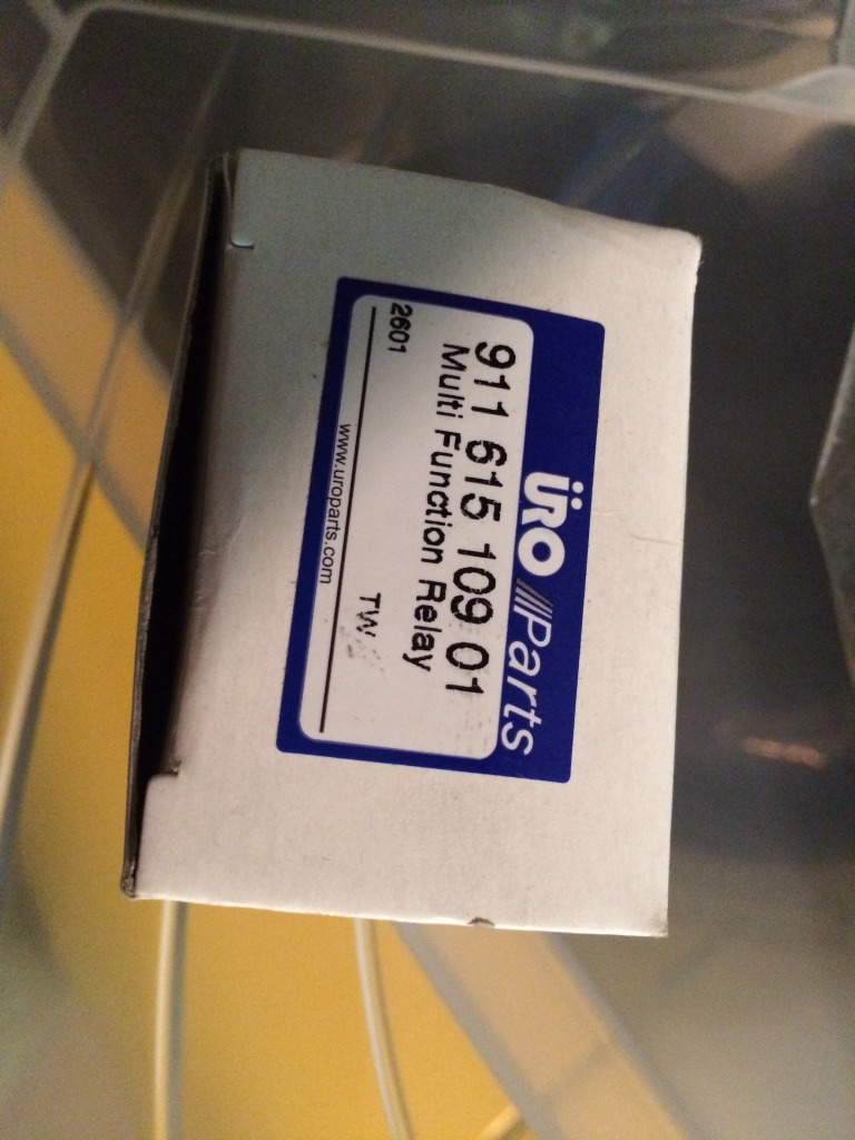

IPB Image
At least a half dozen of these, new in the box. I guess they go bad often?

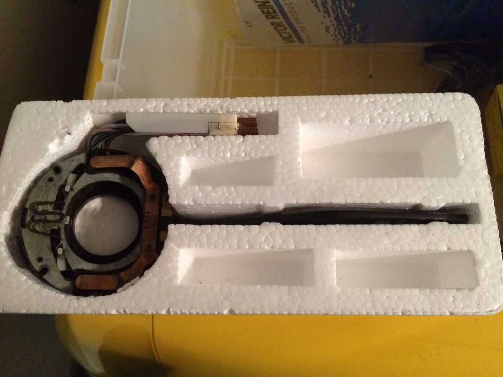

IPB Image
I think this is a new turn signal switch. The one in the car seems to work fine. I need to try it again to see if it's sloppy.

Got a power buffer from HF. Hitting the heavily oxidized paint with some compound. The good news is that it would be hard to make the paint worse even if I burned through to bare metal. It's coming out ok. It's "less dull" now.
Even a cheapy paint job and this car would be pretty nice.
Wife and I were trying to figure out how chunks of paint could be missing. Some of them look like someone tried to chisel the paint off.
orthobiz
It looks like it has the center cushion tray for the removable pad (not the hinged kind) yet it has the triple instrument cluster under the dash.
I have a nice late style cushion if you PM me (not the one on my "for sale" thread).
Paul
swooshdave
QUOTE(orthobiz @ Jun 29 2014, 05:16 PM) *
Paul
So was the console added? Did the 1.7s ever have that package?
