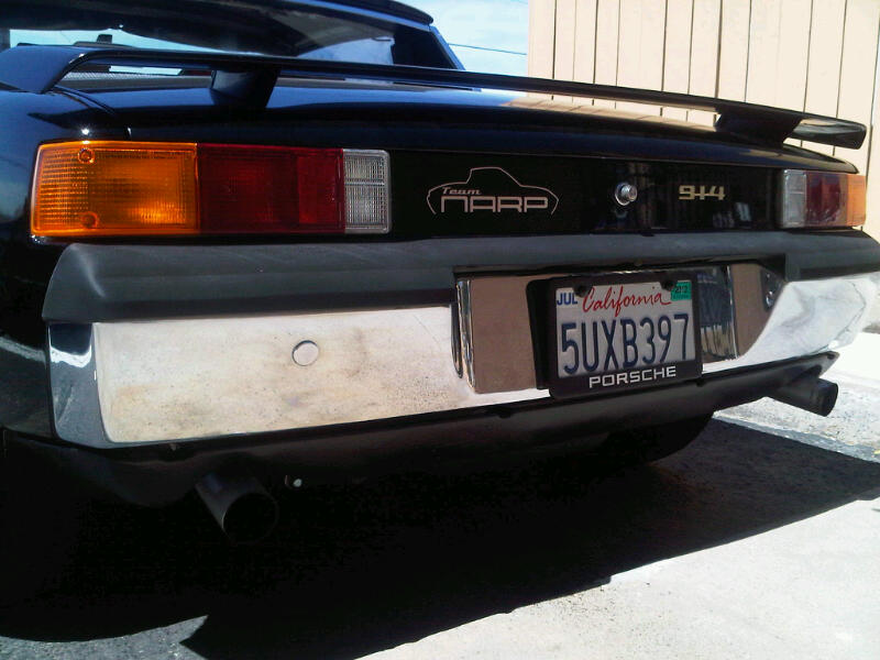

914=teener
I just installed a Triad Muffler and really like the sound. I had a Bursch muffler & didn't like the low idle sound when cruising through town. Other wise about the same sound under acceleration. The issue with the Triad, now I have to modify my lower valance with another dual muffler outlet. hissyfit.gif
Tom
campbellcj
That looks nice with the ceramic coating and chrome bumpers! My triad is stock black paint and my bumpers are black too.

QUOTE(TJB/914 @ Jun 21 2014, 02:18 PM) *
QUOTE(914_teener @ Jun 20 2014, 12:39 PM) *
Anyone local in So-Cal that is running one on the -4 teener.
I am running a Bursch now and I like the way the Triad look.
I'd like to ride in one to see just how loud they are.....beer and lunch in the offing for a ride.
Rob
914=teener
Tom
Thanks Tom....man that looks cool. Did you get the "quiet package" that Chris alludes to?
I don't have a problem modifying the valance as my metal skills are pretty good.
You confirm what others have said...they are about the same as the Bursch.

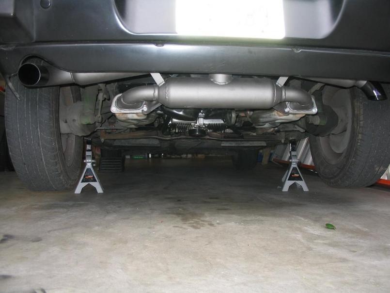

jim_hoyland
Some Triads don't require modifying the valance. The driver side exhaust uses the existing pathway, the passenger side exhaust points down toward the ground. IIRC Greenies was set up that way

jim_hoyland
QUOTE(914_teener @ Jun 22 2014, 11:02 AM) *
Good advice Kevin.....I too have some reservations about cutting into my valance...
I was wondering also if anybody had a picture of one with the turned down exhaust with the valance still on?
Thanks All.
There is a pic of Greenies triad See: http://www.914world.com/bbs2/index.php?sho...69&hl=triad

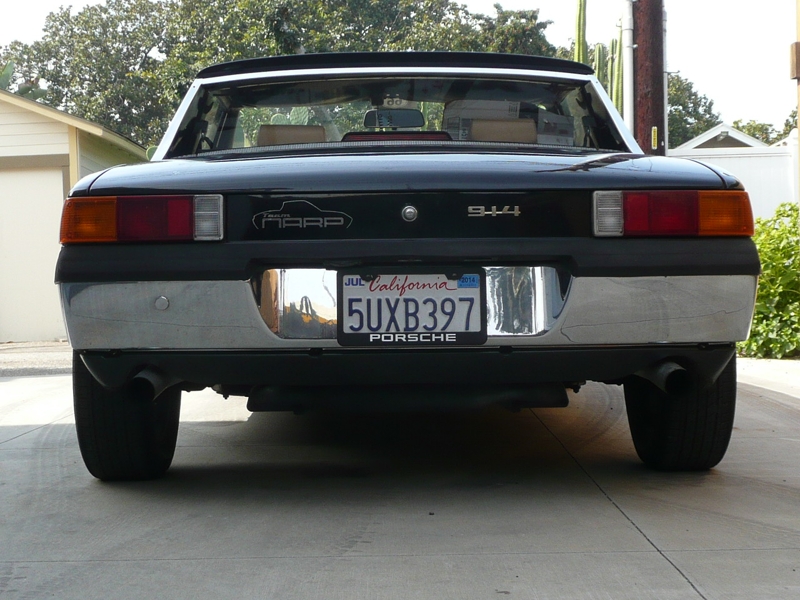

TJB/914
QUOTE(914_teener @ Jun 22 2014, 02:02 PM) *
Thanks All.
Too late guys, I am never coming back. I did save the sheet metal I cut out, you never know if a 6 is in my future?? rolleyes.gif Hey. Pete Stout went 6-cyl. stirthepot.gif
I like the valance look better with the passenger side cut out.popcorn[1].gif
BTW: Triad sounds great, real throaty sound and a little deeper than Bursch.
Tom
914_teener
Thanks for the pictures guys.
Looks like if you had the 1.7 HE's it would tuck the glass pack up a little past the valance view line.

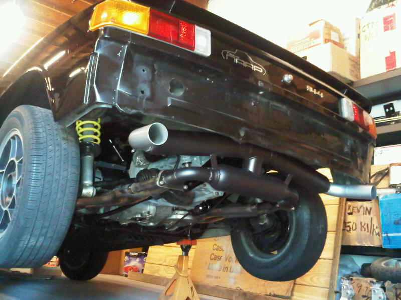

LINGO
I dealt directly with Dave at Triad and he was top class to work with. He answered all my questions and his suggestions made the process easy. He suggested the Chrome tips and welded them on. Delivery was perfect. When I climbed under the car to install it everything was spot on and a perfect fit. I've had numerous people walk up to me in parking lots asking about the car in general and how much they liked the low growl. "Bad Ass" is how my nephew and his friends described it. I installed it 3 weeks ago. Still deciding what to do about my valance. Cut the original or search for a replacement.Click to view attachment
