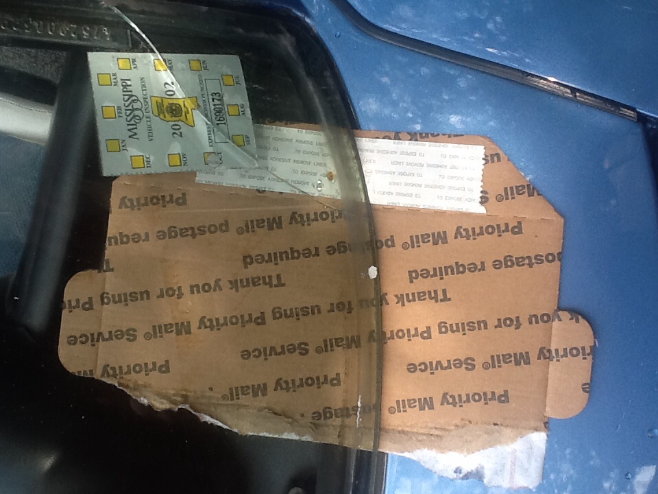

The winner is a leaking windshield.
Found that the windshield was not attached to the adhesive in the corner where I saw the leak. A little pushing and probing showed that the chrome trim was all that was really holding the windshield in. Except for that one spot that caused the windshield to crack all the way down.
But it provides great access for changing the dash vinyl!
