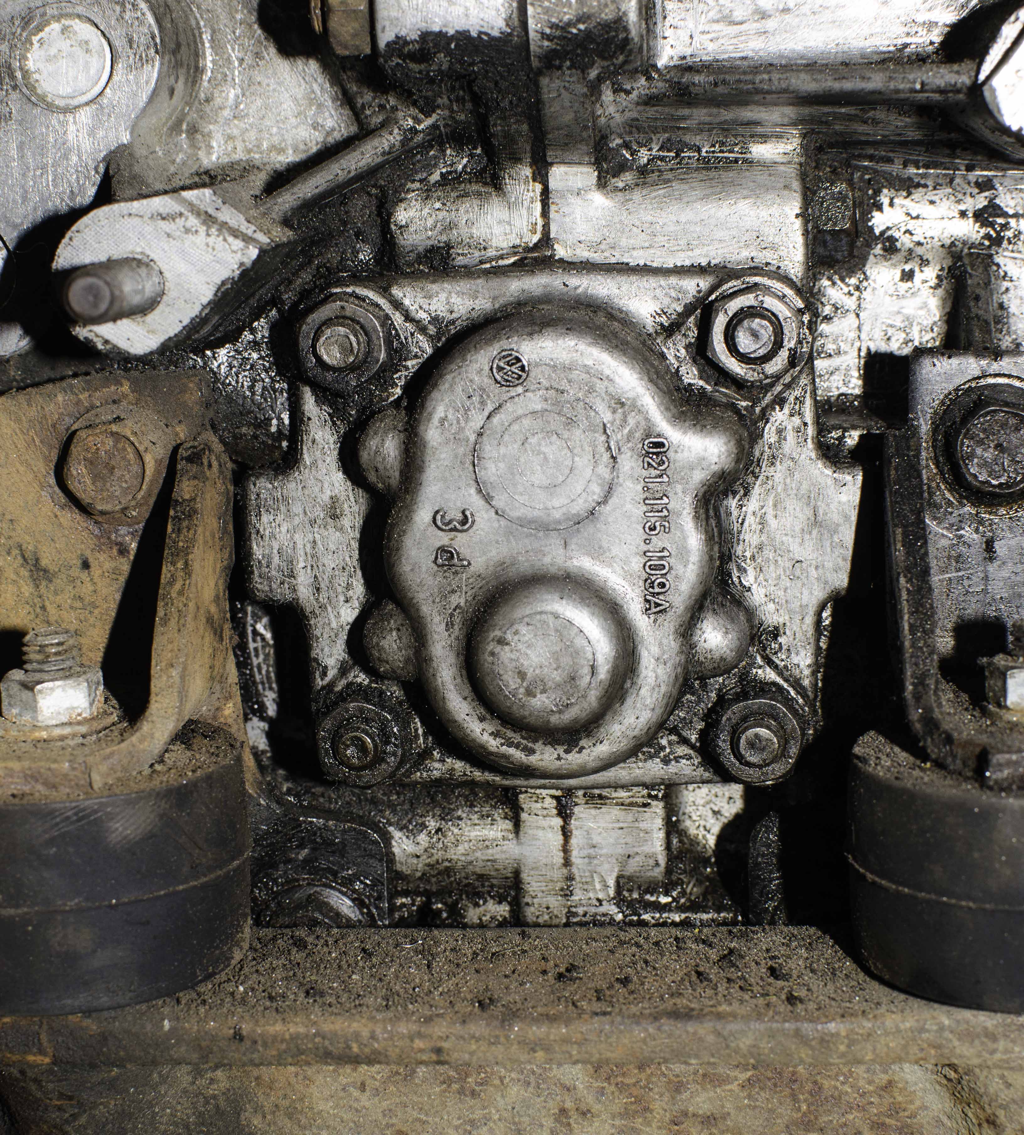

jacksun
Jun 30 2014, 01:05 PM
hi,
I have not been able to even remove the cover of the oil pump...
concerned about prying and damaging something.
the following image is PRIOR to my removing the engine bar and mounting brackets
tks

Cap'n Krusty
Jun 30 2014, 02:12 PM
Remove the motor mount brackets, then the 4 nuts/washers on the pump itself. Those ears on the pump are for prying. Evenly pry the pump out. Be sure you have a new gasket and oring. The pump comes apart after you've removed it from the engine. BTW, that's NOT the pump cover you see in the picture, it's the pump body.

Highland
Jun 30 2014, 02:28 PM
I had to loosen the case parting line fasteners to get the pump out. Trying without loosening the fasteners resulted in broken ears. Ok cause the pump shaft was failed and I had to get a replacement in any case.
After the pump is out and the 4 nuts are off, tapping on a wood block seems to loosen up the whole assembly.
jacksun
Jun 30 2014, 05:54 PM
thanks for the replies..........I actually figured out something on my own....
I used the ears and two BFSD's and pried it out, back and forth until freeeeeee...
it looked ok inside and I just replaced the gasket and put it back together..
tks again.
randal
now on to the push rod tubes seals.............
