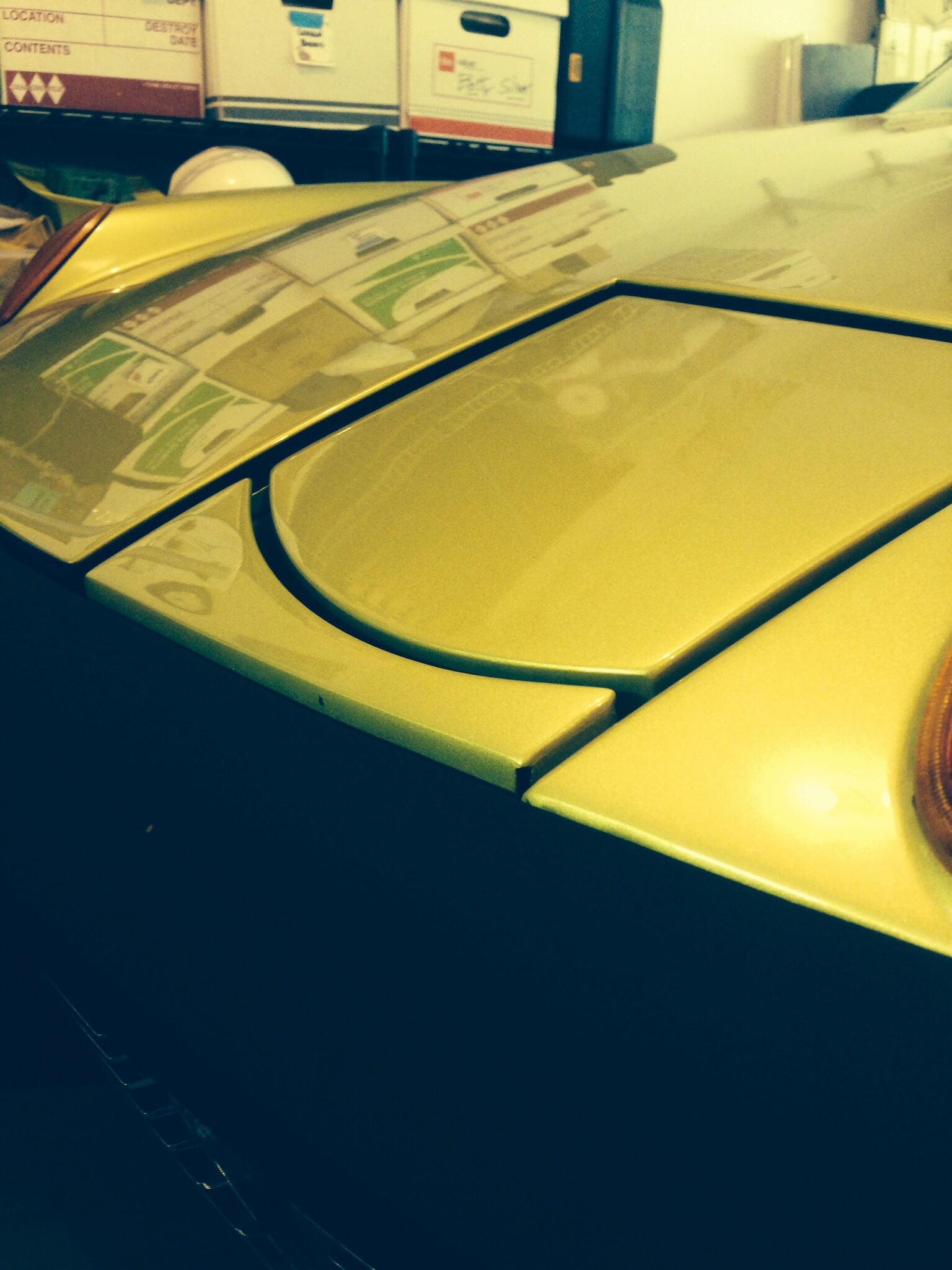

When it came back from body and paint the front trunk lid was slightly higher on the driver side. It's very noticeable at the headlight. Is this height adjustable?
rick 918-S
There is an adjustable rubber bump stop on each side. Check to see if it contacts the landing pad. If it is holding the hood up adjust it down. you may have to adjust the latch too.
