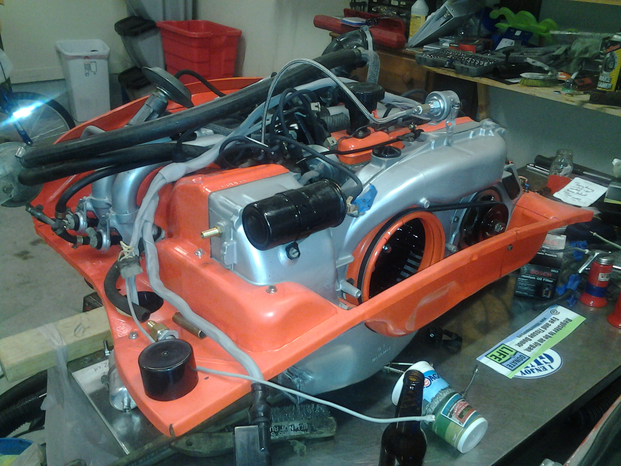

I painted mine.....
But masked off the o-ring seats. I wonder if engine paint is hotter or colder? piratenanner.gif
and then installed....
PanelBilly
It it looks good then do it. Are you going to race the car professionally or compete in an endurance contest?
malcolm2
QUOTE(PanelBilly @ Jul 1 2014, 09:18 PM) *
Not a racer, just a daily driver. Fastest I have had my car in these 1st 5000 miles is 75.... maybe. Not positive, cause the speedo is squirrelly.
Painting stuff ended up being one of those, "while your in there" things. makes you take your time during assembly. did not want to scratch the paint. And having a light color on the tins has helped me fined leaks etc...
Any thing that would fit in my wife's oven got painted and baked.
another shot of the engine on the table...

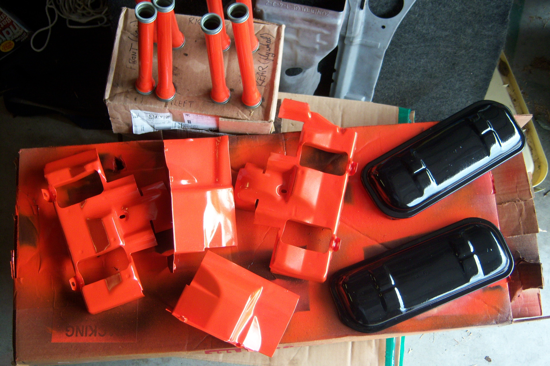

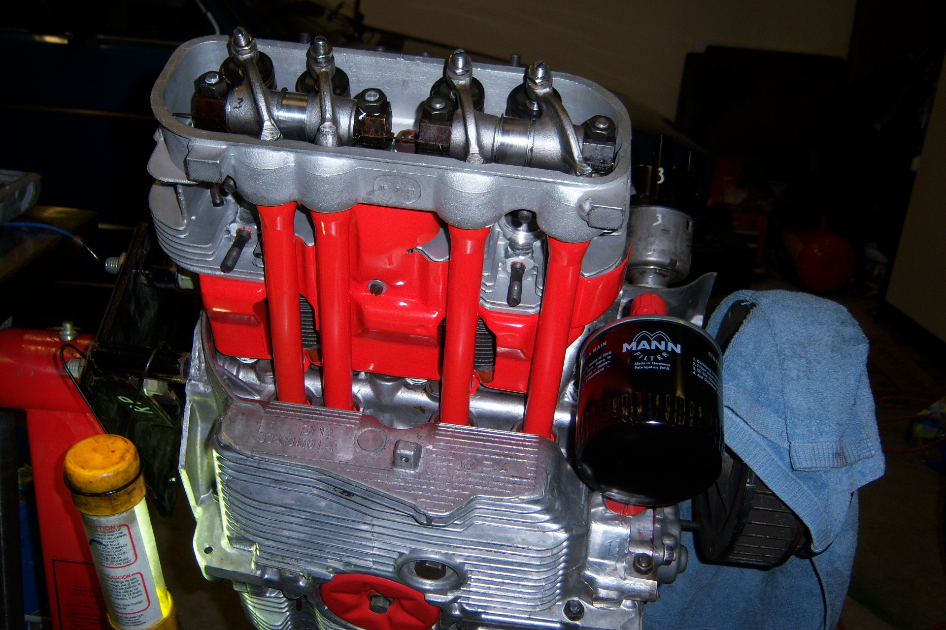

I went ahead and painted mine smile.gif , I ended up using high heat brake caliper paint (rattlecan), I've haven't had oil temp issuses in awhile but then again I run two oil coolers biggrin.gif , Bill D.

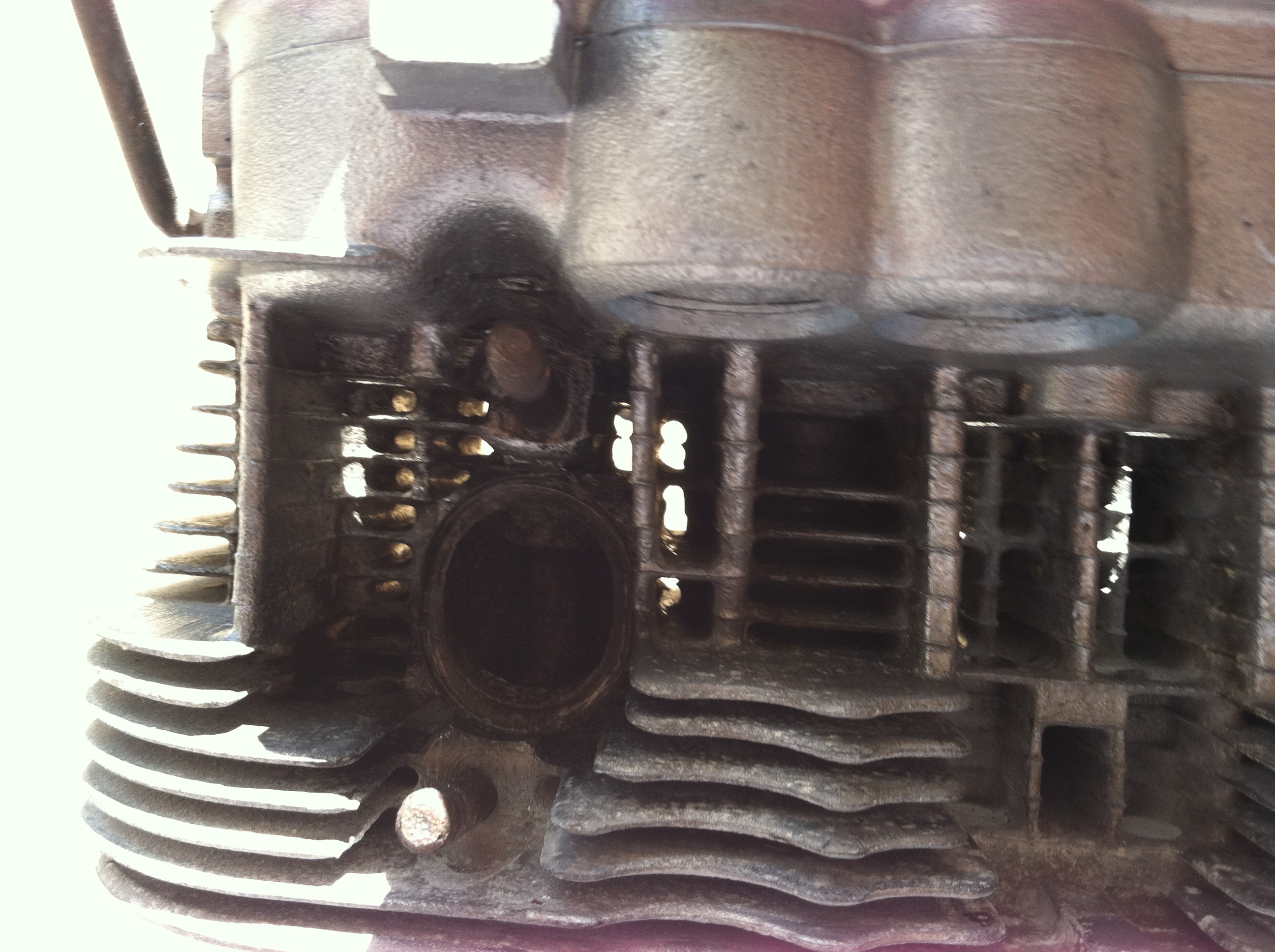

Sorry, slight thread hijack, but an order of magnitude more important than the heat transfer of pushrod tube paint vs plating is the head casting itself.
Just been into cleaning up my newly acquired 2L 3 bolt intake heads (039-101-371A) and I noticed that casting flash had substantially blocked off many of the thru cooling passages between the fins. Lots of cleaning up with long drill needed to get flow passages opened up to intended areas. Photo shows area of concern. I did more clean-up after this, but you get the idea.
Note that my older 2L buss heads 022-101-372G were much better for flash.
So while you're in there folks look closely in those passages.
