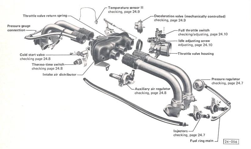

Doh! Where is the cold start injector??
Java2570
Cold start injector is attached to the air plenum....see picture:
