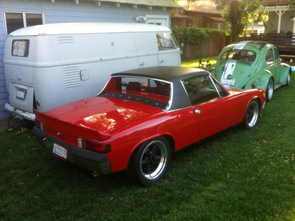

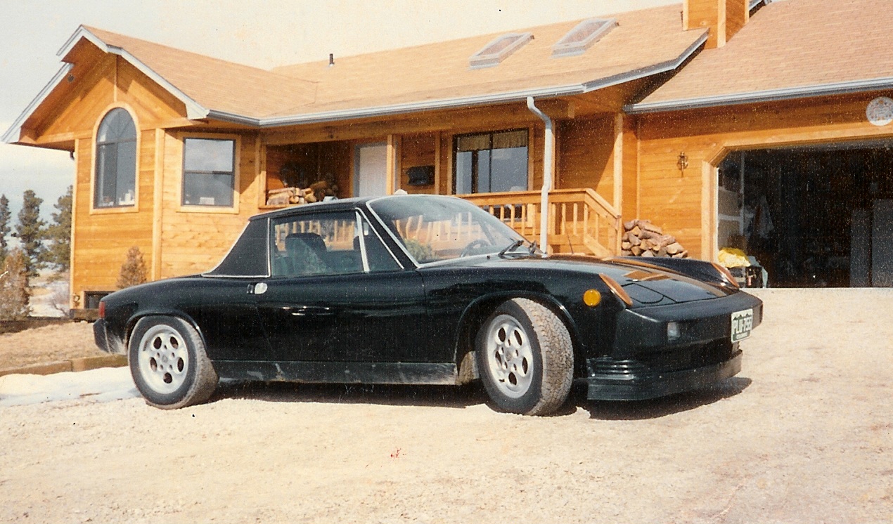

I'm running Falken 215/60 x 15 all the way around. The wheels are 911 SC phone dials, 15 x 6 on front and 15 x 7 rears. As I understand most 911SCs had the 16" Fuchs, but that was an option and the phone dials were standard.
I did stretch the rears with a bat to get them to fit, but it's a nice set up. When I get new tires I may go 205s up front, I've been told the 215 is a little wide for a 6" rim.

QUOTE(Bruce Hinds @ Jul 16 2014, 05:40 PM) *
Hot damn that setup looks sweet, especially at the rear. And I do need to repaint both sides of my car again... idea.gif smash.gif
This is EXACTLY what I was looking for. If you've got any more photos from other angles, please don't be shy. I've been trying to find the right setup for years, and this might be it for me. Thanks!!!!

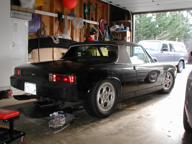

Here, some 215x45x16 on 7" 911 SC Fuchs, front and rear:
IPB Image
And my son's car, 225x50x15's on 7” 911 cookie cutters:
IPB Image
Both cars rolled and pulled, neither rubs, and both with good door gaps.

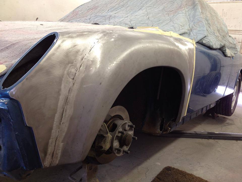

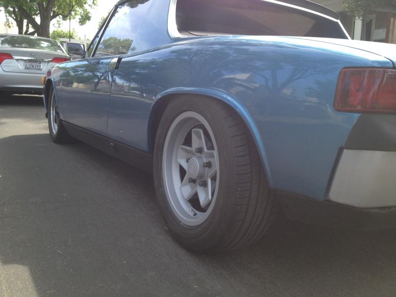

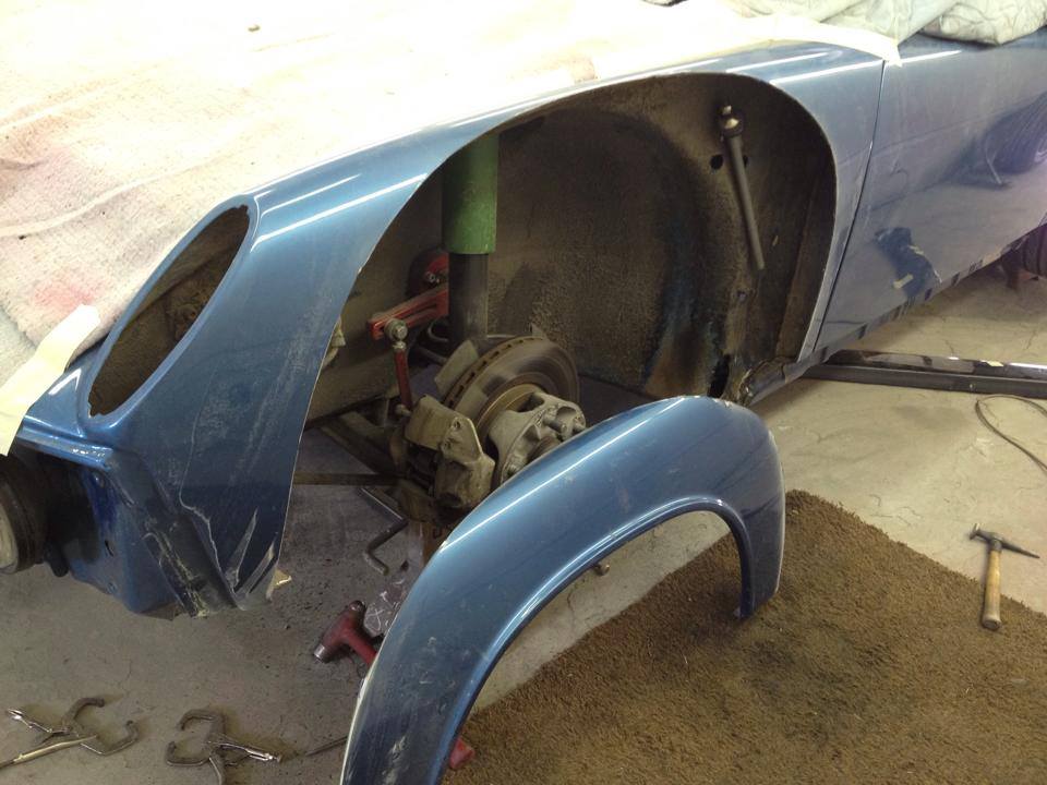

Okay, so I found the pics I took during the 215/60R15 experiments. I'll post them here for two reasons:
-Maybe they'll be helpful to someone else
-The hardest thing to find on the inter webs were (any) pictures of the tires I was interested in ON a 914, or even an early 911.
So, pardon the amount of pics, but here goes the first trial with the 215/60R15 P6000:
horizontally-opposed
Okay, so there was hope, or at least a little. The tire would physically fit inside the well, but there wasn't much room.
Next step was to try to locate it perfectly in there on a wheel—and I knew a 15x6 was both too narrow for a 215mm tire and unlikely to place it where it needed to be. So I borrowed a 911R wheel from a friend, which adds an inch to the inside and allows you to space the wheel as you need to. If you want to fit maximum tire under the back of a narrow 914, these are the best factory wheels for that purpose. I used washers instead of spacers to keep things easy—knowing I could have custom spacers made later if things looked good.
So, here goes...
In any event, those images show just how tight things were. The brake lines, in particular, were an issue. I'd want to look at rerouting them.
In the end, though, it was clear to me that both sides wanted to have the rear fenders pulled or flared, and more spacer. Not being interested in that, it was back to Square One: Finding a good high-performance 15-inch tire. There aren't a lot of choices, and there are even fewer places to get useful feedback—or photos—of what they're like on 914s. So a lot of my research would be funded out of my own pocket. Hopefully, it proves helpful to you, though I am under no illusion that my interests will match everyone else's (maybe that's why I couldn't find what I was looking for! idea.gif )
By 2012-2013, it was time for fresh tires. A lot of time on TireRack suggested that a set of Dunlop SP Sports in 195/65R15 might be a decent pick. Bummer was that they were all-season tires, but I reasoned that they were still probably way grippier than any road tire of the 1970s, and they had a non-alien sidewall design along with a tread pattern that didn't look too modern. Turns out, two people far smarter on hot rods than me recommend them to their customers, too: Rod and Gary Emory. And they were much cheaper than the P6000s. So, I pulled the lever.
Thing is, they embodied the "all-season" tire cliche: They're (kind of) good at everything, but great at nothing. And they didn't move the needle for me aesthetically. I left them in place while testing out the new engine and getting the car running, but they're about to come off.
Lest you think I tried everything, I haven't. Skipped Michelin XWXs for reasons noted in a post above, and a whole host of stuff on TireRack because it looked like a dog's dinner.
I did, however, briefly consider two other options:
1) Hoosier TD 5.00-15 or 205/60R15 Speedster tires, but research suggested they are awful on the street until they're hot (not easy to do on the street, most of the time). Also, I hear the folks at Hoosier won't talk to you if you mention street use. That told me everything I needed to know. The Avons are well proven on the street, and are a tarmac rally tire in addition to a vintage racing tire. You won't get a lot of life out of them, but I figure I'll be replacing them on a time rather than mileage basis. Unless, of course, I just can't keep my rear end out of the seat with those Avons... smile.gif
2. BF Goodrich Radial T/A in 205/60R15: Talk about old-skool. Had been wondering if they were too Trans-Am/Burt Reynolds for a 914, and wondering if they had been updated, but just couldn't get my head around them. Still curious. Will say that the vintage sidewall, vintage tread pattern, and price make them appealing. Maybe even very appealing.
First Hoosier pic is a 5.00-15 tire on a 15x6 wheel, second one is a 5.50-15 on a 15x7R.

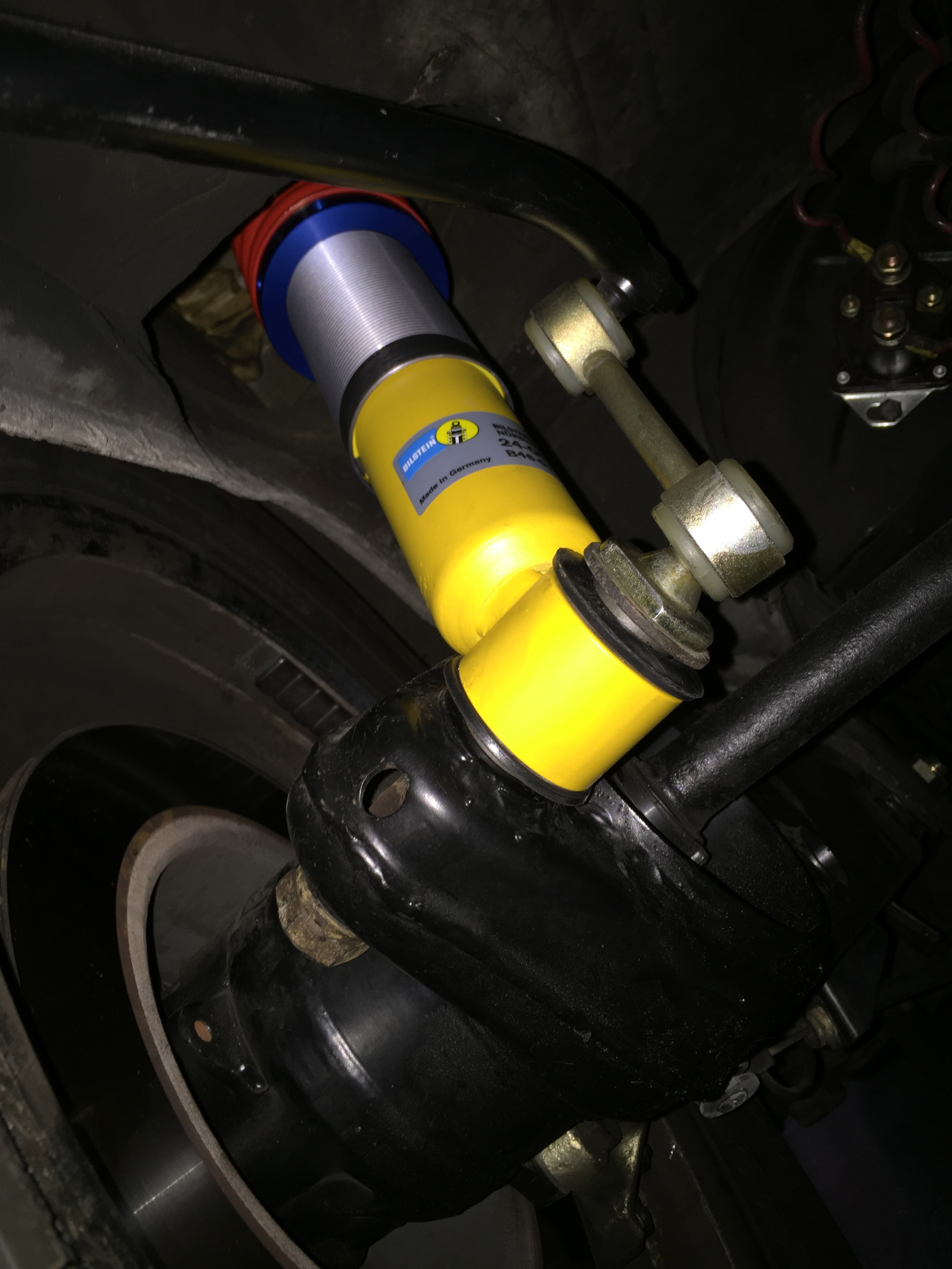

They're next, when the piggy bank recovers.

The car I just picked up has 225 /50 R15's on Fuchs
QUOTE(Matty900 @ Feb 14 2016, 10:20 PM) *
QUOTE(horizontally-opposed @ Jul 16 2014, 04:07 PM) *
Porsche lists the 215/60R15 as an N1 tire approved for 914-6, and I am considering them as they solve the too-small diameter problem I want to avoid. Currently, I'm on 195/65s. I used to run 205/55s and 205/60s, but all of these are too small in diameter.
I know the cars vary, but I was able to run various 205/55s with no rubbing and 205/60 Yoko A008Rs years ago with only a bit of rubbing on the inside (too much negative camber at that time). I'd be running these on 15x6 911 wheels, but may pop to have them turned into 15x7Rs by Weidman and do custom spacers. Big thing is to get a summer performance tire in there with, well, performance—and the right look.
That period look with any kind of performance is getting tough to find. If anyone has 215/60s on a narrow car, and can provide pics, I'd be very thankful!
pete
Wow, interesting.
That's a lot of tire on a 15x5.5-inch wheel. Have the wheels been widened on the inside? Weidman's Wheels does that quite a bit for the 911 crowd, turning 15x6s into 15x7s, and I've seen at least one set of 914 alloys custom widened.
