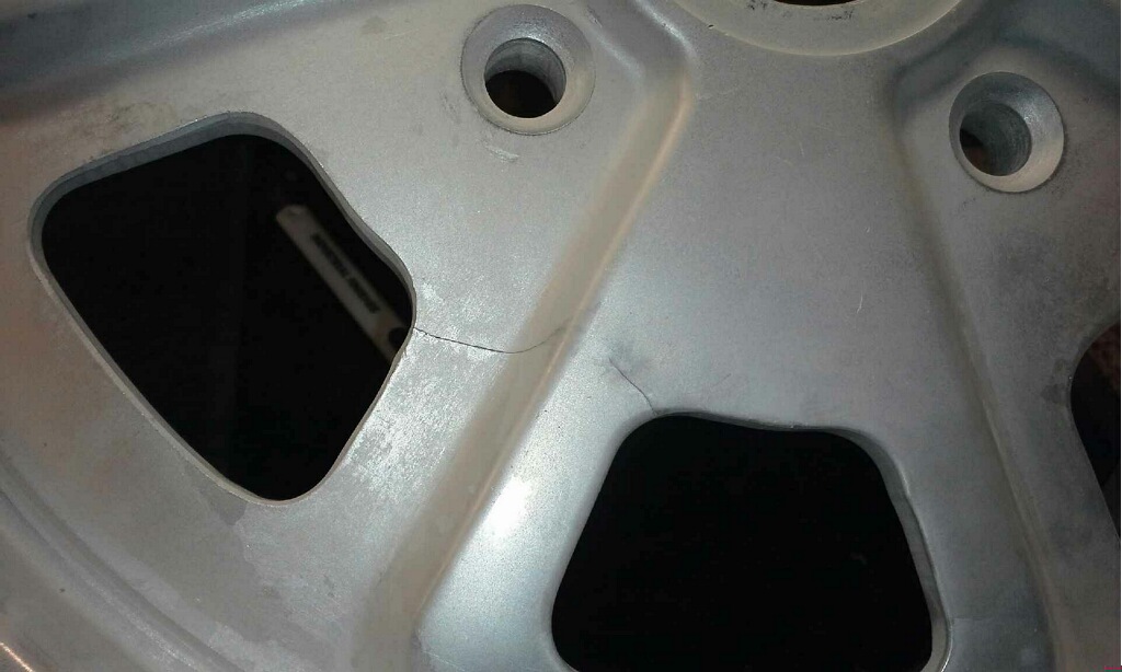

Am having 4 spoke fuchs polished and discovered a crack. Am sending it out to see if it can be safely repaired. Thoughts?Click to view attachment

Probably, but given they can be had for ~ $100, I'd look for another.
Krieger
carr914
Can it be fixed - yes
Would I drive on it - no
Cheaper to buy a new one

gms
I own a wheel repair shop and I would not repair that wheel.
It would cost the same amount to buy a replacement.
Tighten the bolts by hand, not an impact wrench

Buy a new one. Forged wheels have a specific grain structure from the high impact forging process. Welding it will melt the metal and, at a minimum, change the forged grain structure into something weaker.
Not sure if the Fuchs are preciptation hardened to get the strength up (T4, T6) but if they are, applying heat will knock them down to T0 - which is dead soft and easily bent.

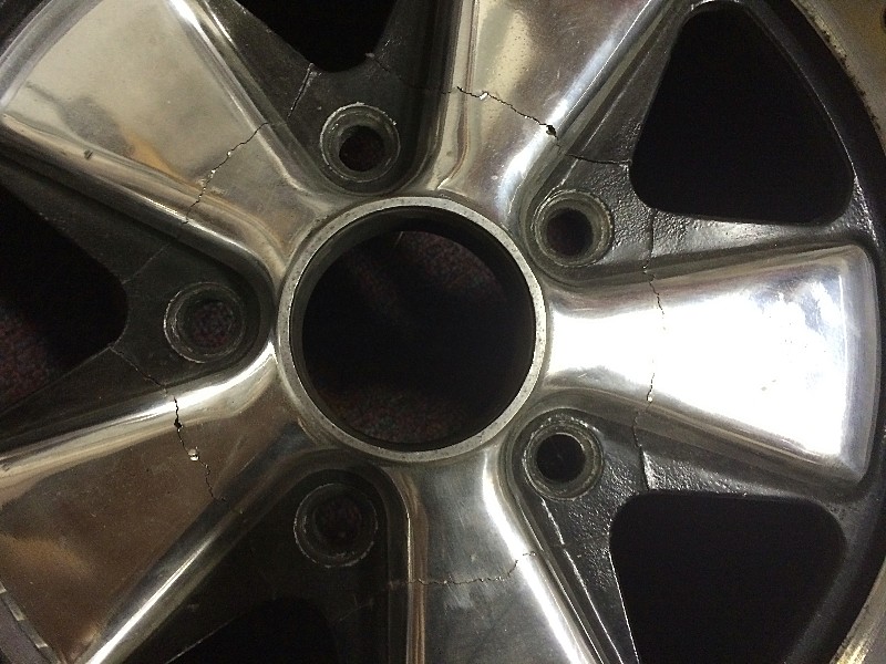

naro914
Good thing you found it now or this could have happened... Found while at speed...on a racetrack....a friend was driving Huey and thought a tire was going down!
YES, check your wheels!!
carr914
DANG!
naro914
Yep...cracked all the way through, but the center area won't come out.
