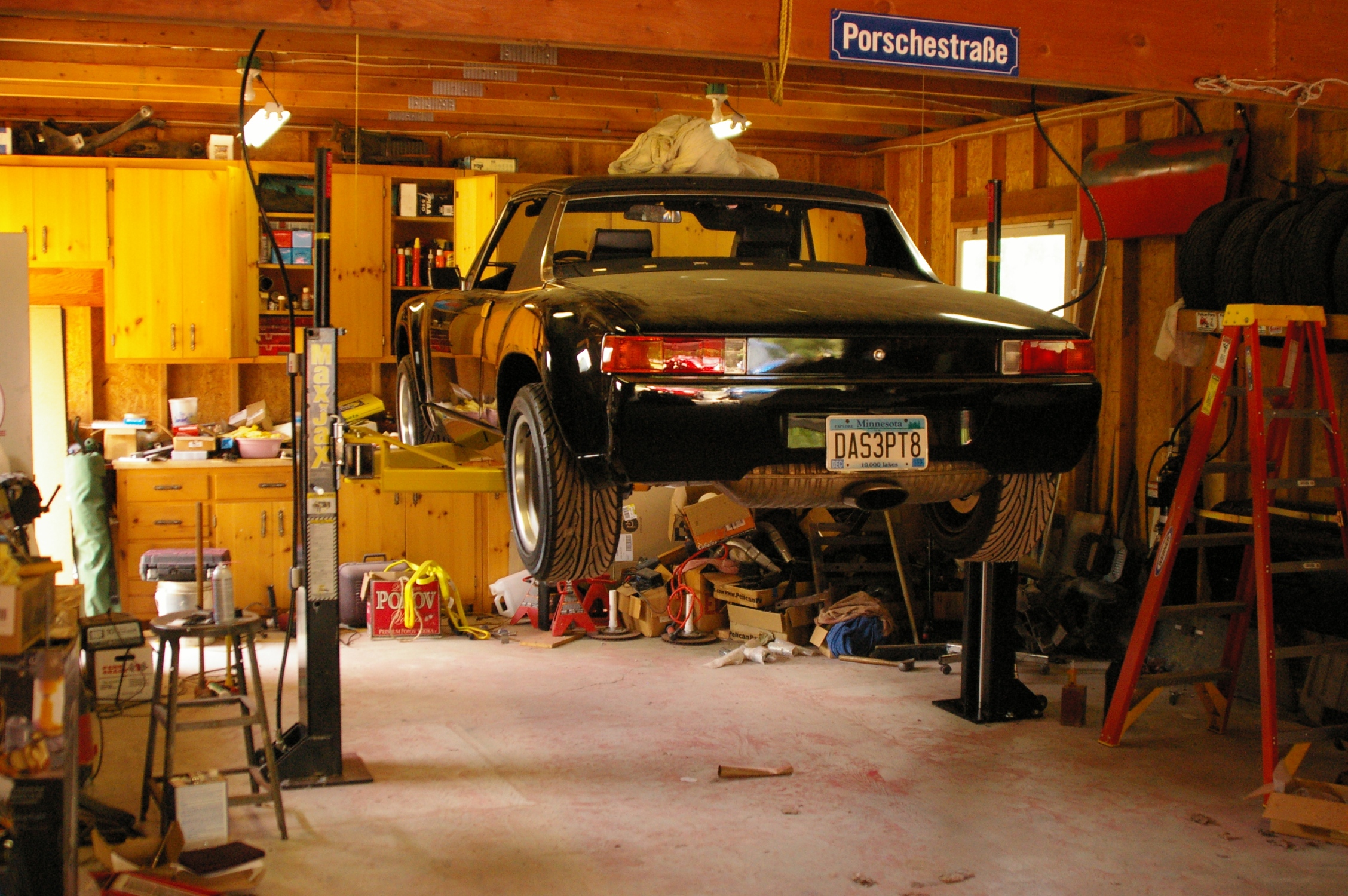

Should have gotten this years ago, no more laying on my back

Sweet. 8' to the joists?
GeorgeRud
Aug 2 2014, 02:41 PM

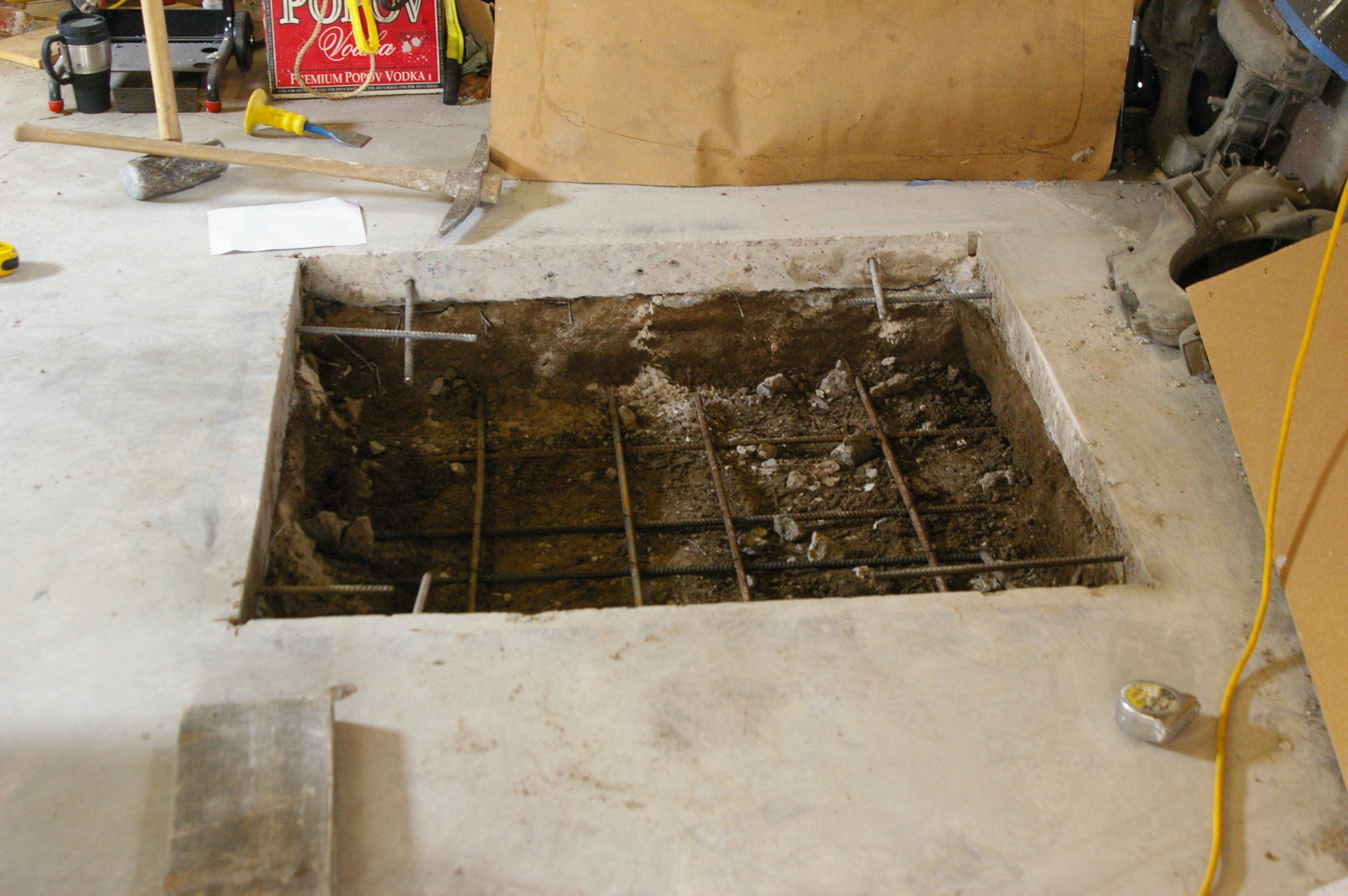

Did you have to reinforce/ rep our the garage floor to a deeper than standard floor slab to mount the lifts?. It looks like there is a different pour by the stands. How high can you get the car off the ground?
I only have a 9 foot ceiling in my garage, but I'd love to get a lift like this.

Yep, I cut out a 4' x 4' pad and dug it out to 10" deep and pinned it to the existing slab, poured 4000 psi concrete. About 48" lift
Click to view attachmentAbout 9' to the joists

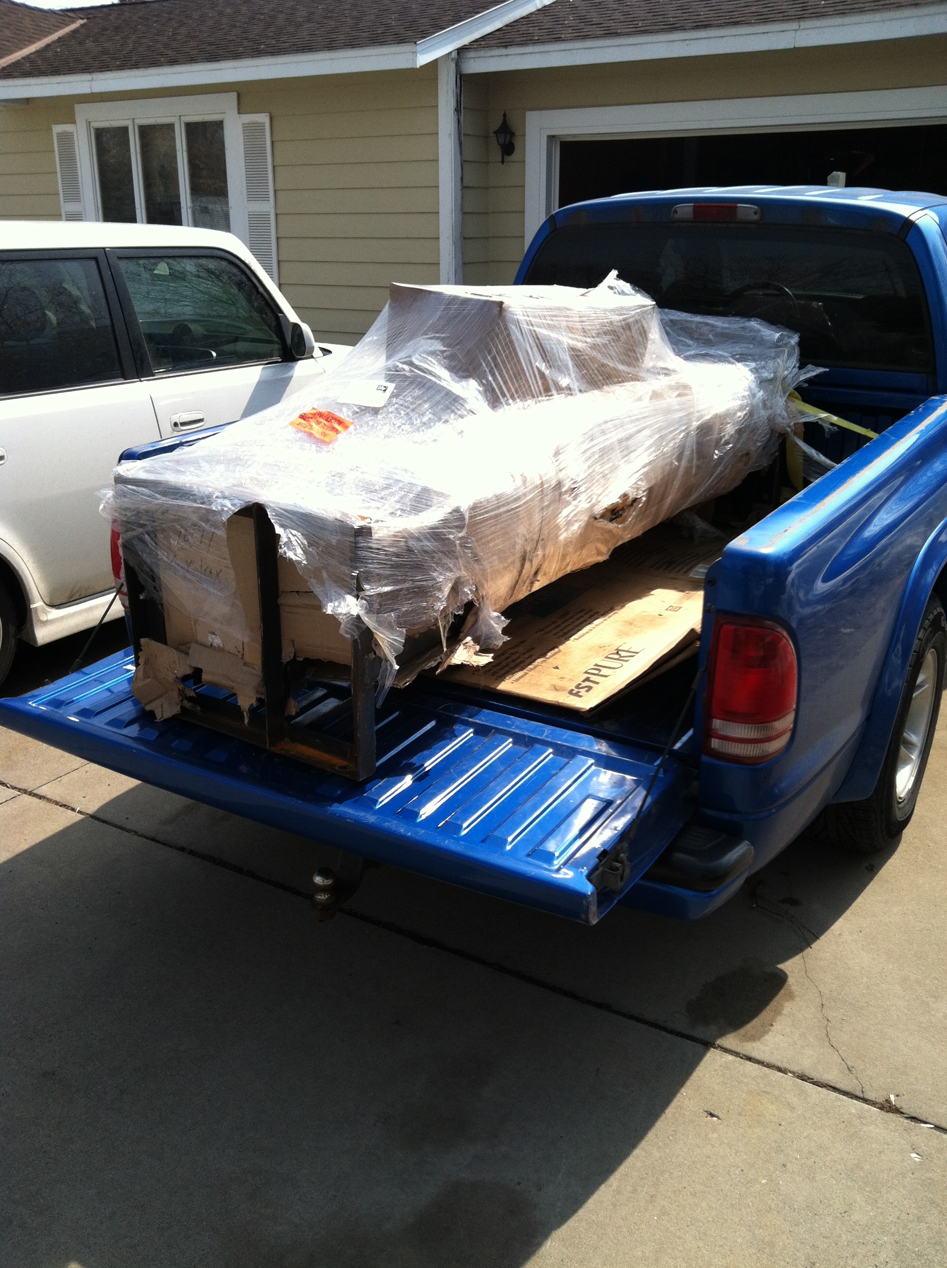

I got it on sale for $2100.00 with free shipping. I picked it up at the local freight company and they put it in the back of my truck. I used a chain hoist back at home to lift it off the truck bed.

You don't really need a slab thicker than most garage floors for a small lift like this, my 2 post 6000lb lift only listed a 4" slab with no rebar as the minimum requirement, of course thicker or with rebar is better.
