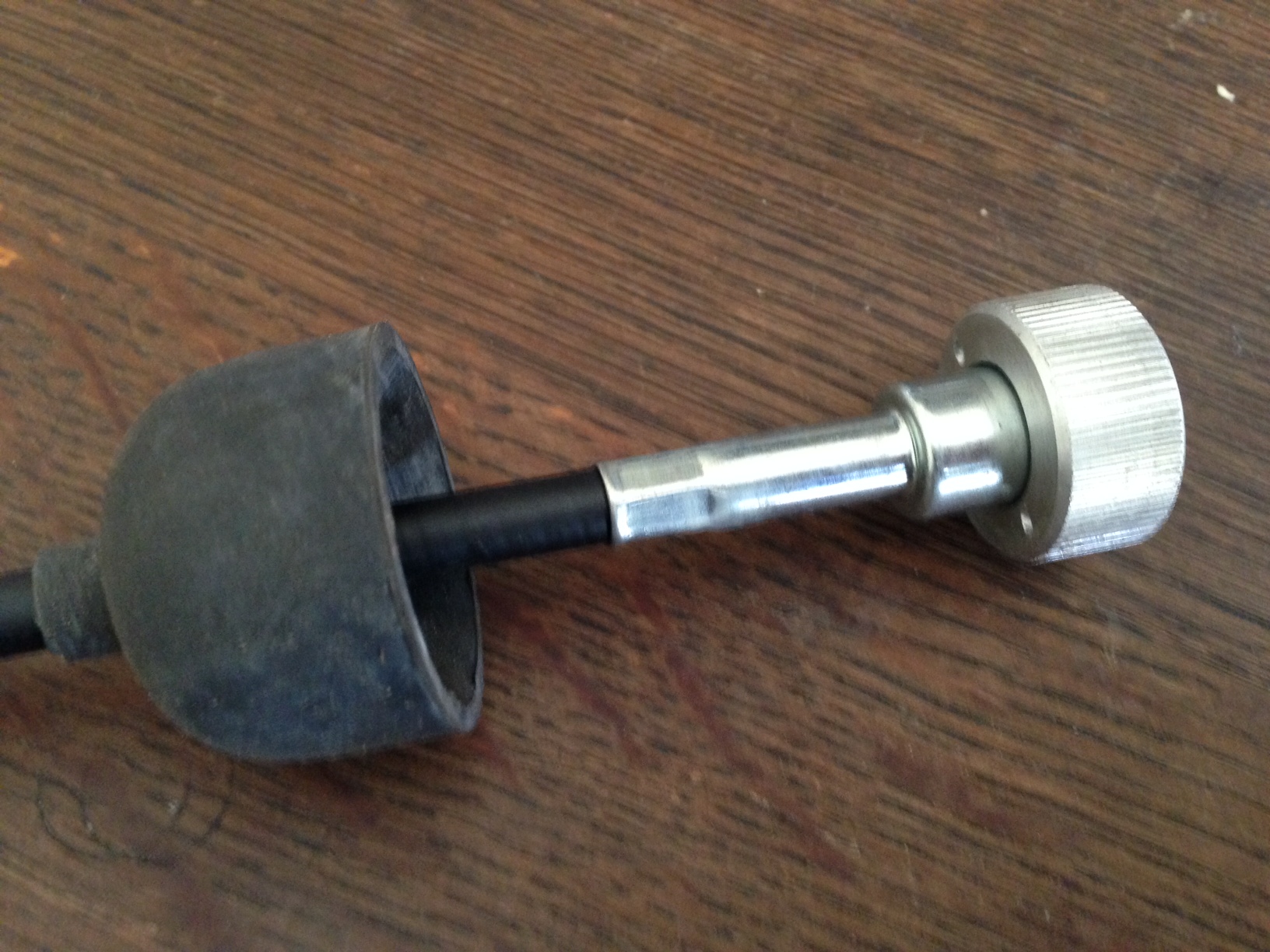

jeffdon
Aug 23 2014, 02:53 PM
Here is a pic of my new speedo cable. This is the tranny end. The boot appears to be on the wrong way. Got this from the bird. Any one else have this issue? I am starting to loose faith in these guys.
Dr Evil
Aug 23 2014, 03:19 PM
How is that on the wrong way? It is supposed to slide over the collar that you screw onto the speedo drive
Aug 23 2014, 03:33 PM
its correct. you'll see when you install.
jeffdon
Aug 23 2014, 03:40 PM
QUOTE(mepstein @ Aug 23 2014, 02:33 PM)
How can it be right? I tried inverting the boot while on the cable, and it looks nothing like the one I just cut off my car. I am pretty sure this got put on wrong at the factory. I see no way of getting it off and re-installing the other way.
Dr Evil
Aug 23 2014, 03:48 PM
Jeff, I am not following you. You dont take it off. You screw the collar onto the speedo drive and then slide the rubber cuff over the collar.
That pic you have is correct. I have no idea what you had, but the pic is correct.

jeffdon
Aug 23 2014, 06:25 PM
QUOTE(Dr Evil @ Aug 23 2014, 02:48 PM)
Isn't this a boot that is to go over the tube in the fire wall?
Aug 23 2014, 06:44 PM
QUOTE(jeffdon @ Aug 23 2014, 08:25 PM)
No. Read above.
jeffdon
Aug 23 2014, 08:05 PM
QUOTE(mepstein @ Aug 23 2014, 05:44 PM)
No. Read above.
Ok, the cable has two boots. On that fits snugly over the end that screws to the speedo. The one in the picture fits well over the angle drive connection, but there is no boot for the tube where the cable goes into the tube in the firewall. That would need to be on the cable already, right?
bluhun
Aug 24 2014, 01:51 AM
QUOTE(jeffdon @ Aug 23 2014, 07:05 PM)
No. Read above.
I have the same issue. The problem is that the boots on the cable were installed incorrectly at the factory, i.e., the boot that should seal at the firewall is down at the speedo angle drive end and the boot that is supposed to slip over the angle drive is at the end that goes through the firewall. At least that is the problem with my cable.
bluhun
Aug 24 2014, 02:05 AM
No. Read above.
The cable is supposed to have two boots, one for the speedometer angle drive, which you have, and another for the speedometer end. It appears that you only have the boot that fits over the speedo angle drive. My cable has both boots but they were put on backwards at the factory. It appears that there's a serious quality control issue at the factory.
bluhun
Aug 24 2014, 02:20 AM
No. Read above.
My observation directly above regarding your cable is incorrect. What you have is the boot that fits over the tube at the firewall, fitted backwards on the cable. What you appear to be missing is the smaller boot that seals at the speedometer angle drive. Sorry for the confusion.
jeffdon
Aug 24 2014, 06:41 AM
QUOTE(bluhun @ Aug 24 2014, 01:20 AM)
No. Read above.
Thats what I thought. So there should be a total of three boots, right?
bluhun
Aug 24 2014, 09:14 PM
QUOTE(jeffdon @ Aug 24 2014, 05:41 AM)
No. Read above.
No, just two boots. The smaller one fits over the speedo angle drive and the large one (the one in your picture) fits at the firewall.

Dr Evil
Sep 5 2014, 06:50 AM
OK, I just replaced my speedo cable with a new Gemo one and now understand the issue that prompted the start of this thread.
See the pics. The old and the new are different. The boot on the firewall end is too small on the new one, and the collar on the gauge end is not captive like on the OE one. Makes for a bit of fun. Best way to install is to put tape on the gauge end just behind the collar to keep the collar from sliding back.

rgalla9146
Sep 6 2014, 08:15 AM
The problem is not with the boots. It's a hardware issue
The GEMO replacement cables don't have a collar on the transmission end to hold the boot.
See photo
The speedo end does not get a boot, only the angle drive and the bulkhead.

rgalla9146
Sep 6 2014, 10:49 AM
Sure, remove the angle drive end from the sheath of the new cable.
DO NOT CUT OR SHORTEN THE SHEATH
Remove the end from the old cable with care to save the end pieces.
Expand the crimped part some way.
Slip the new boots on the the right way.
Slip the old end pieces on.
Find a way to crimp the end on.
Easy
