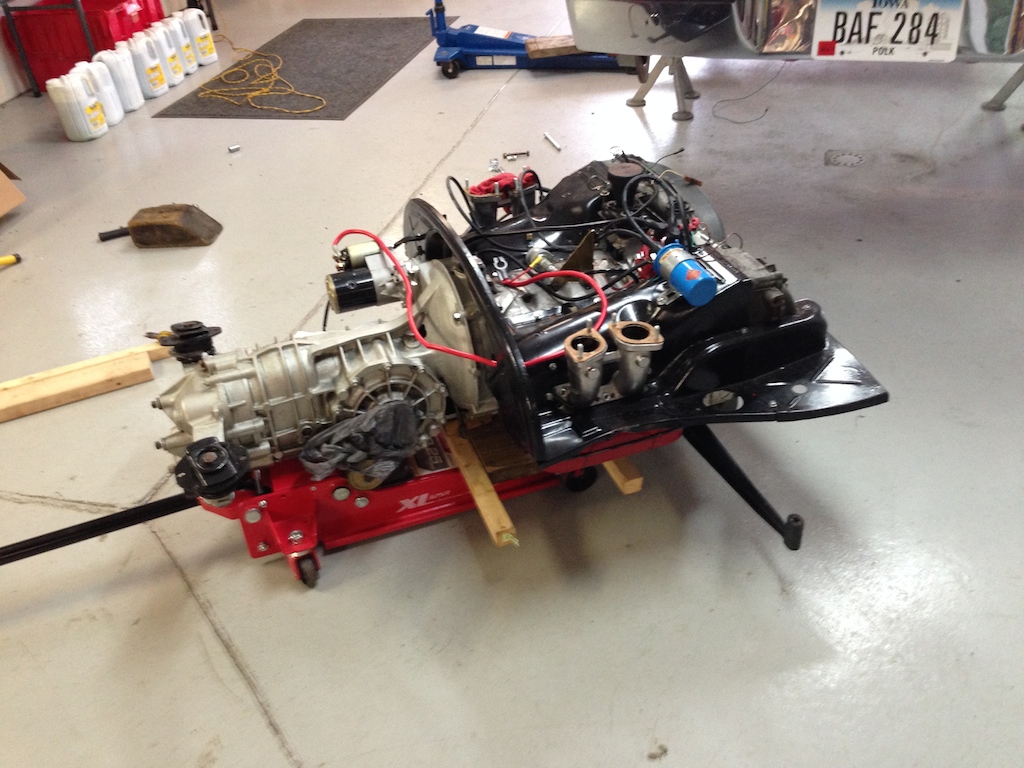

Have the engine back in the car and am looking at breather options. Am running Webers and want an attractive breather with small "K&N" type filter on it. Would like to have at least 2-3 fittings for hoses.
Suggestions?
JmuRiz
Des Moines area huh...nice looking engine/trans/shop/bumper...

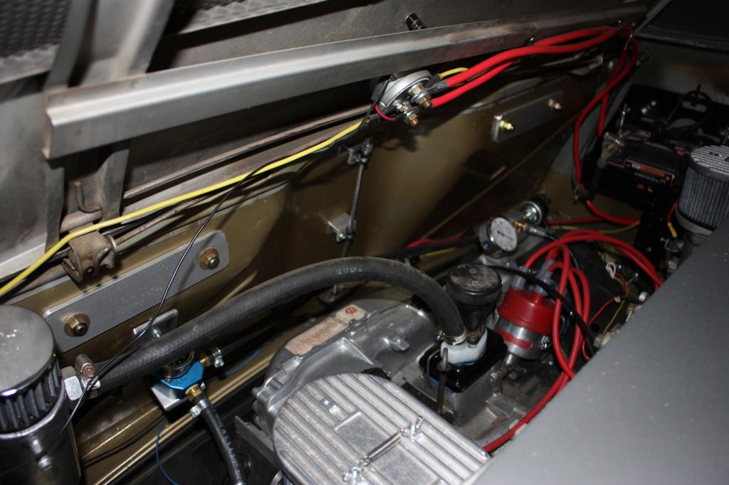

Elliot Cannon
Here's mine.

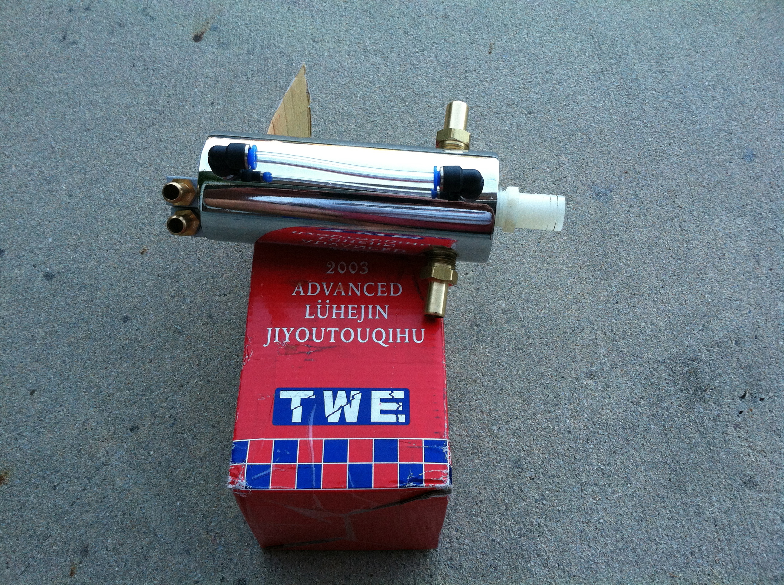

barefoot
I purchased a cheapo Breather from E-bay and modified it for my dual carb app.
I enlarged the bottom drain (with nylon fitting) to go to engine breather box.
Then added two brass nipples down low to connect to head vents. The top 2 nipples will go to the carb air cleaners to vent off oil vapors.
I filled the upper half of the canister with a reticulated foam (open pore) that we use in fuel spray chambers to contain vapors. thus the liquid oil getting to the air cleaners will be minimized. No external vent needed.
This will mount to firewall above engine oil filler

patssle
QUOTE(Elliot Cannon @ Aug 29 2014, 09:25 AM) *
Here's mine.
What type of hose is that?
