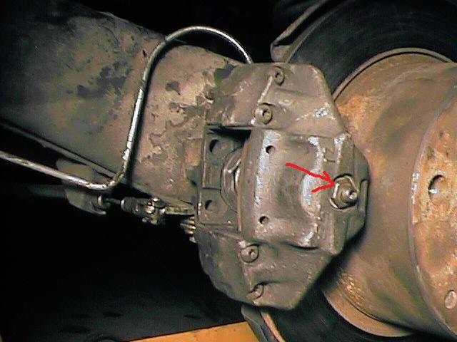

I replaced the rear brake pads. Small problem. The nut that sets the adjuster stripped (see red arrow), and it won't seat. I am thinking either that I will cut off the nut and replace it, or does the adjuster eventually come out, so that I can put in a new one?
Otherwise, the caliper adjusts fine.

I looked at your thread, but I am not sure we have the same issue.
My nut was cross-threaded, and is now stuck on the adjuster.
I think I just need to cut off the nut and hope I can get a new one.

There is a small C clip before the nut that keeps the nut from backing off the adjuster. This C clip needs to come off. You maybe able to back the nut off once you get the C clip off. If you get the nut off then you can look at the adjuster to see if it is stripped and not the nut itself. Have a look at PMB's video on You Tube for more info on the adjuster and nut setup. The nut is thin and not typical to what you would find at Home Depot. Give Eric Shea a call at PMB, he is the master.
If your adjuster is stripped that will require a little more work, maybe a rebuild of the caliper.

No C Clip.
Ugh....
Anyone in SoCal have a spare nut? I will replace it, just need to get this done.

KaptKaos
Local hardware store has 8mm jam nuts. Bought a few and some dremel cut off wheels.

I did get the jam nut off, but the threads on the adjustment are too buggered up. I can't get a replacement on.
So it looks like I need to replace the caliper. Which sucks and wasn't something I was looking forward to doing.
