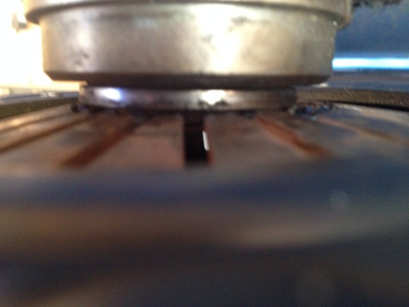

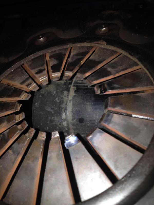

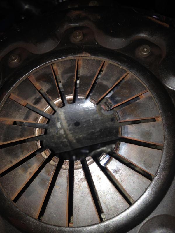

I just tore my car apart to track down my clutch issue. And this is what I found:

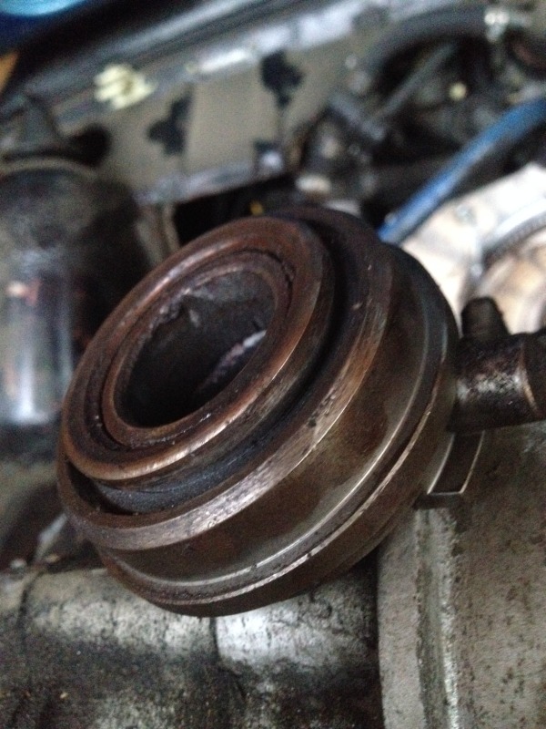

I think I had my clutch cable too tight. And with the pedal fully depressed, I was pushing the Throwout bearing so far that the second step was hitting the pressure plate. But with the clutch any looser, it wouldn't disengage and I couldn't get it into gear.
So it was basically impossible to adjust the clutch.
I've heard that maybe my pivot bolt needs to be shimmed.
I've also heard that some KEP V8 kits have incorrect geometry in them, causing you to have to shim the pivot bolt or modify the fork.
Anyone have that problem with Subaru KEP kits, or has anyone seen this type of pressure plate damage before? I'm about to order new parts, but I just want to understand the problem so it doesn't happen again.
Thanks for your help!

Clearly a self machining process started. I would first ask if the through out bearing seized? Maybe you are sitting still too long and not driving your car? Maybe that KEP pressure plate is a POS? Maybe you have the wrong bearing?

Great questions, thanks! The bearing is not seized, and I'm pretty sure it's the correct one. Can you tell if it's correct from that picture? It's old and a little noisy, but fine otherwise.
This whole clutch setup was installed in the car when I bought it, and it seemed to work fine for about 5000 miles. But recently, the car would sometimes grind slightly going into reverse but only when the engine was warmed up. So I tightened the cable, thinking maybe it had stretched. And I think that's what caused this major 'self machining' issue. I drove the car maybe 100 miles that way before the clutch got much worse and I parked it.
I had a difficult time with the clutch adjustment, which is why I ended up over tightening. I would tighten the cable, then turn on the car in neutral and try to put it in gear. It would grind, so I tightened it more. I repeated this several times until it got to the point that when I pushed the clutch pedal all the way down (with the pedal stop unscrewed all the way) the clutch made a strange noise. I should also mention that the free play at the top of the pedal motion was long gone. There was zero free play at that point.
In hindsight, I think the noise was the 'self machining' occurring. And I think it was caused by the second step of the throwout bearing, which doesn't rotate with the pressure plate BTW, to hit the pressure plate when it was overextended.

I'd say KEP will have the best answer, but it's odd that only seven of the diaphragm fingers on one side were damaged and not all of them, all the way around. Do those fingers still function normally, the same as the undamaged ones, when you, for example, step on them to mimic the action of the throw-out bearing? Does the spring diaphragm function normally and equally all around? Reason I ask is to know if the diaphragm is still intact or if it cracked, which might explain the unbalanced damage.
You're right, it's odd that one half of the fingers were cut through while the other half were untouched (at the larger diameter wear pattern). I will step on the pressure plate tonight and check to see if half of it was broken. that would explain the wear coming from one side only, because the plate would have to be spinning around with a high side and a low side in order to get that damage, right?
