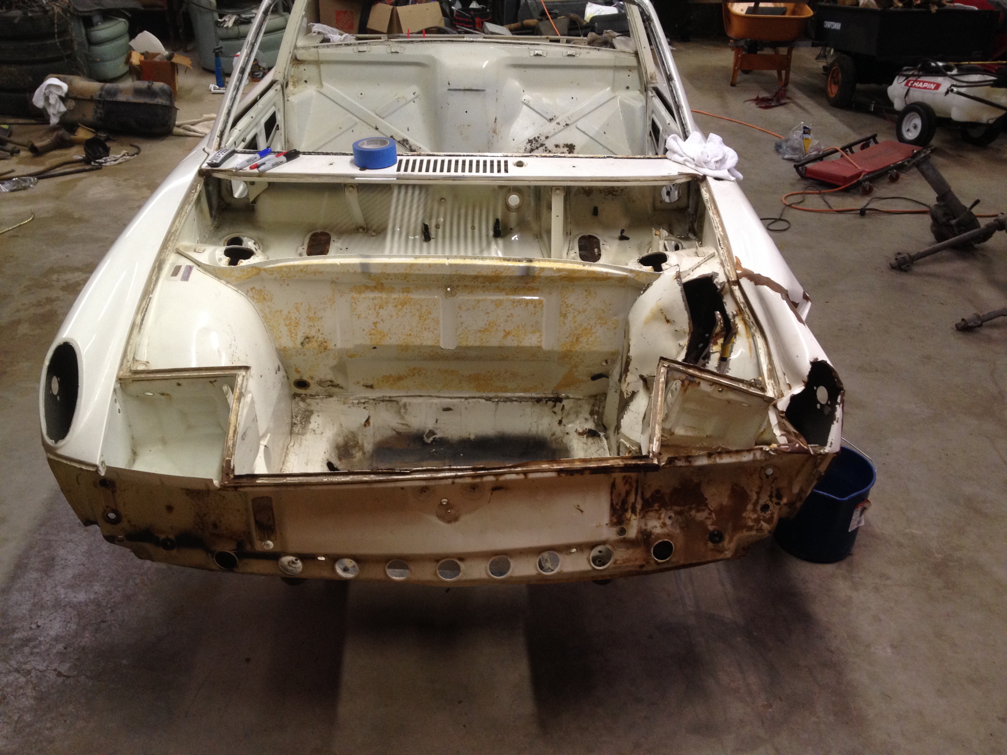

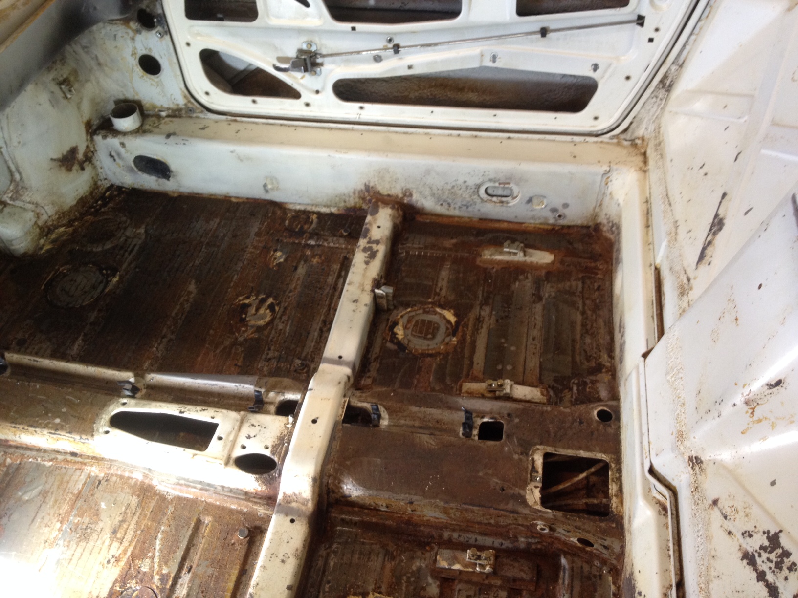

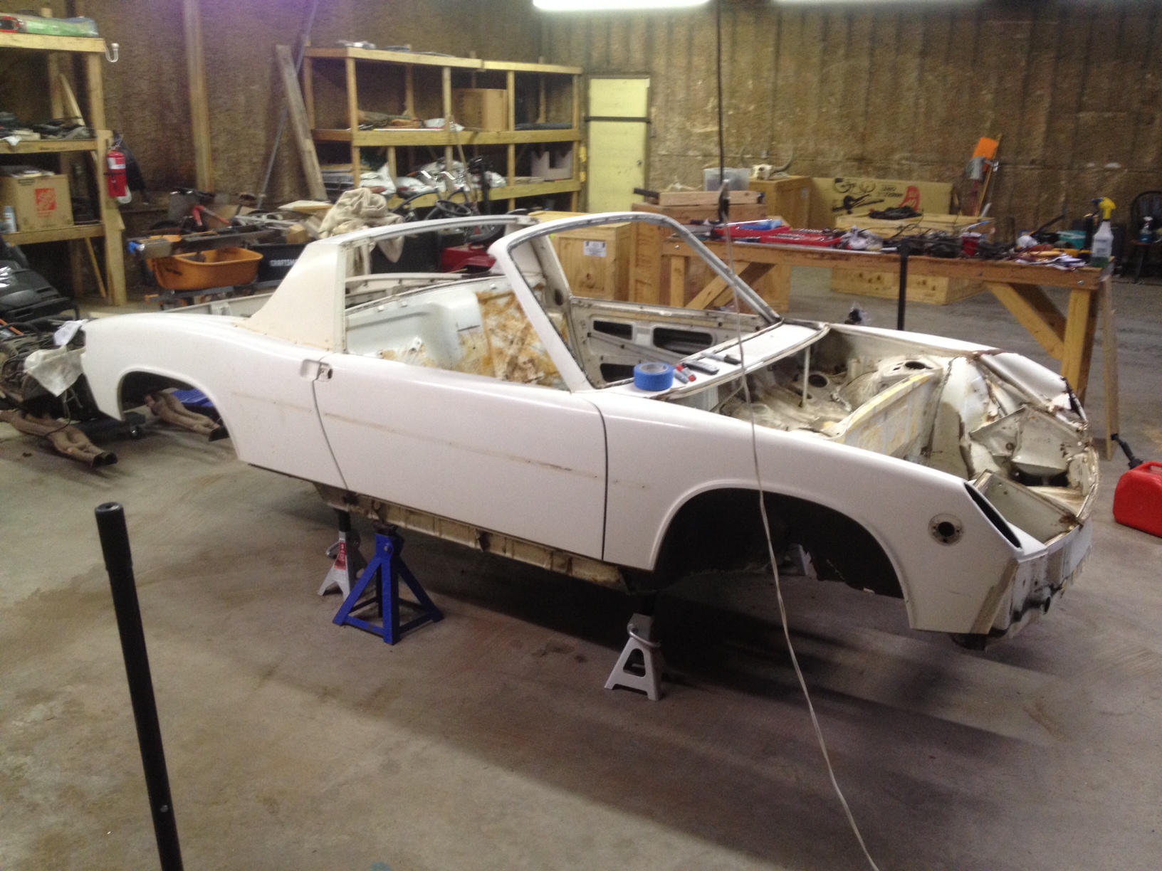

Now, since I promised I wouldn't spend any money on this restoration until I knew what I was in for, I've spent the last two weeks doing free things. I got the car down to just the body shell:

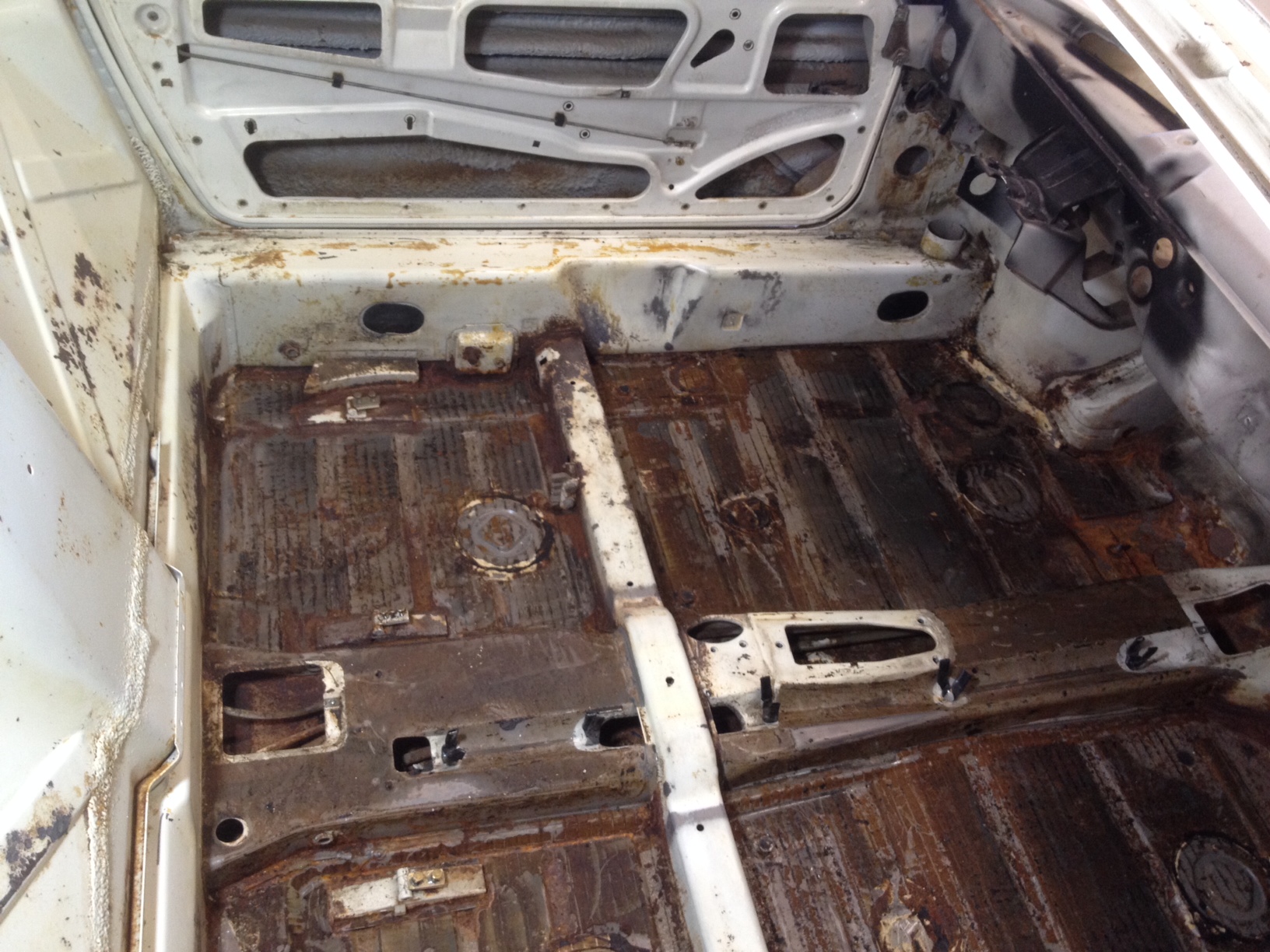

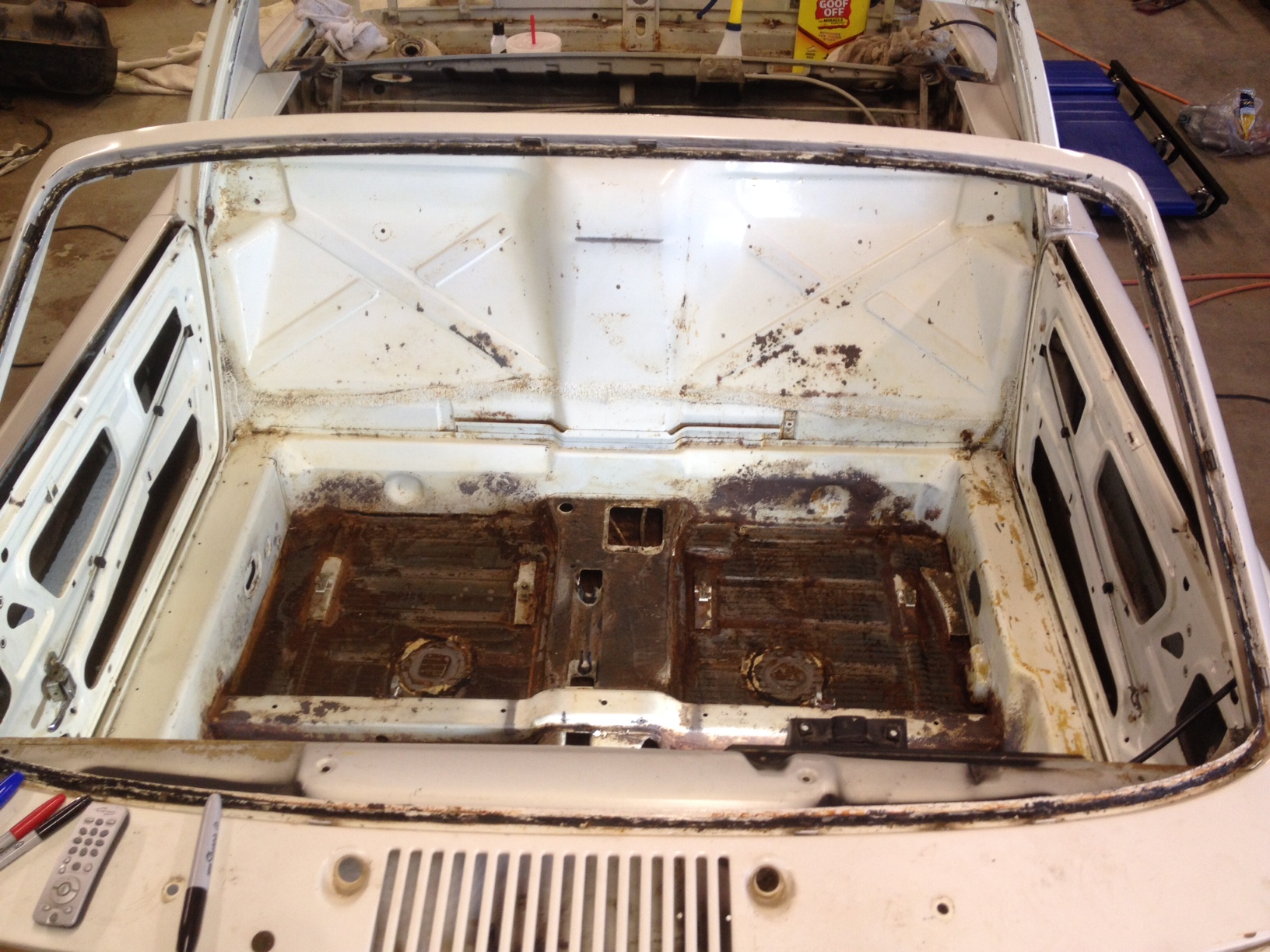

And completed what I hope is the WORST job about restoring a 914 - removing the tar mats and trim adhesive from the interior:

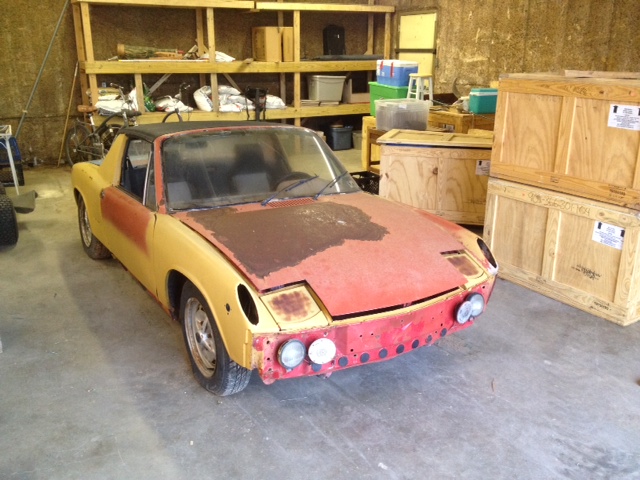

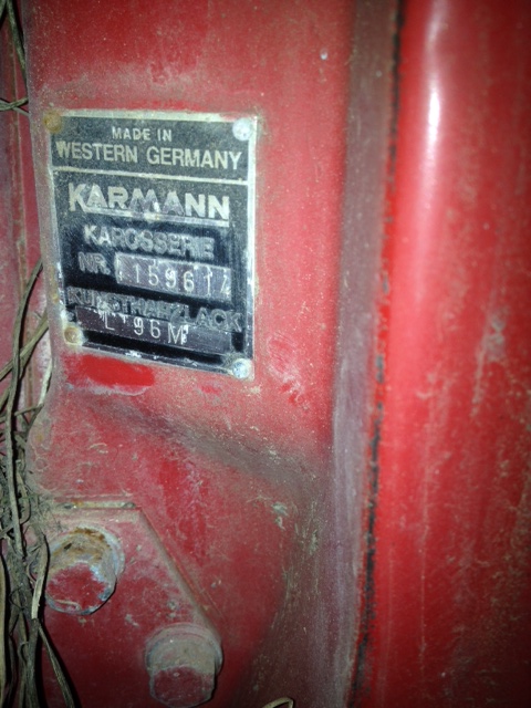

Had the opportunity to pick up the parts car this afternoon:
She's pretty rough, and was originally Marathon Blue Metallic:

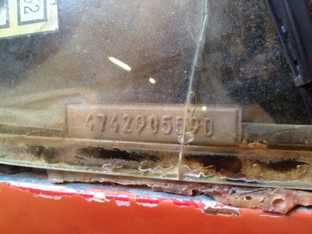

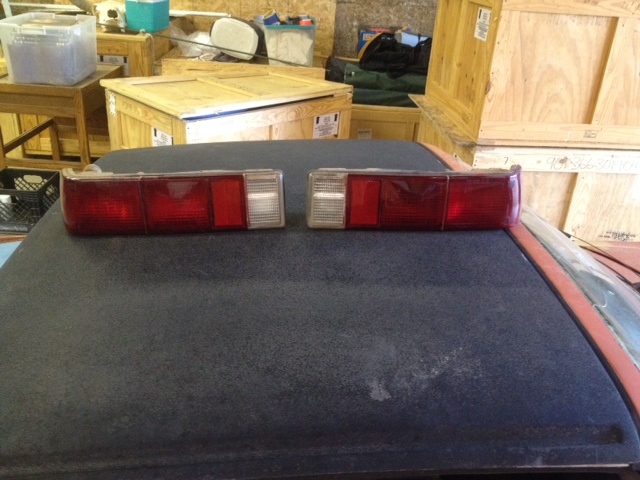

One nice surprise was finding these in the trunk:

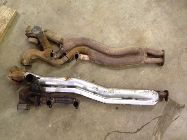

It's a '74, and I think a 1.7. The intake setup is a kind of goofy custom job, but the heat exchangers look relatively new. Will 1.7 heat exchangers work on a 2.0?

Yes they will fit but the restriction costs you some HP.
poorsche914
Are the heat exchangers stock or stainless steel?
If SS, then they work same as the 2.0 version and are no more or less restrictive.
They will bolt up fine to a 2.0 engine but you will also need to use the 1.7 muffler and mounting bar.
BeatNavy
QUOTE(RobW @ Sep 16 2014, 10:17 AM) *
agree.gif Seriously. I'm jealous.
Group buys? I haven't been around too much longer than you but it is my impression that few, if any of them, are critical to where you are right now in the restore process. If you find you end up needing something, just put a WTB on the classified and you'll probably have little trouble getting it (unless it's an original interior light lens or something). There are tons of people here willing to help find things.
Nice job on the tarboards and adhesive. Yes, that job SUCKS.
CptTripps
That's a nice looking tub!
agree.gif with everyone else. That garage is insane.

Looks like a good starting point for sure!, are my eyes playing tricks on me or does the left side front have some accident damage? cant tell from the picture-
on the group buy thing they do come and go, i would get what you think you need the most. at times you will se something you know you will need and just cant pass up based on price. when i got my SS HE's i only pain $200! they were like new! but are the 1.7/1.8's - since i was ordering my muffler(triad) (i have a 2.0 motor) i was able to get a great deal on the H.E.'s and got the muffler and hanger that match it. The exhaust ports on the motors are all the same so you can put the 1.7-8 on a 2.0 just hve to match up the proper muffler and hanger - since mineis a 75 and those are horrible- they were leaking bad and rusted out, i tore those off and backdated to the 74 variety. much better IMHO. you mght be able to trade with someone if you want the 2.0's, but certainly can keep what you have.

Here's what the right-side heat exchangers from each car look like (parts car exchanger is the lower, shiny one):
I guess the big difference is the number of pipes to the muffler. The resto car had an original Dansk 'hotdog'.

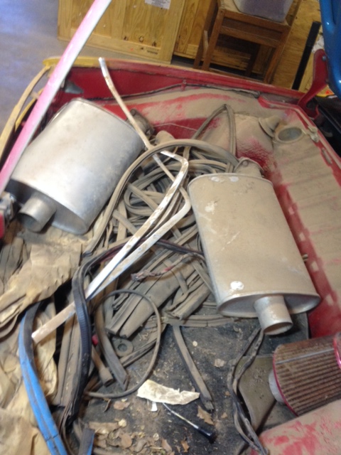

These two mufflers are in the trunk of the parts car (along with a bunch of other items I haven't sorted through):

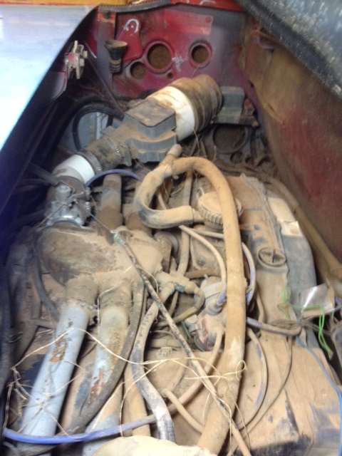

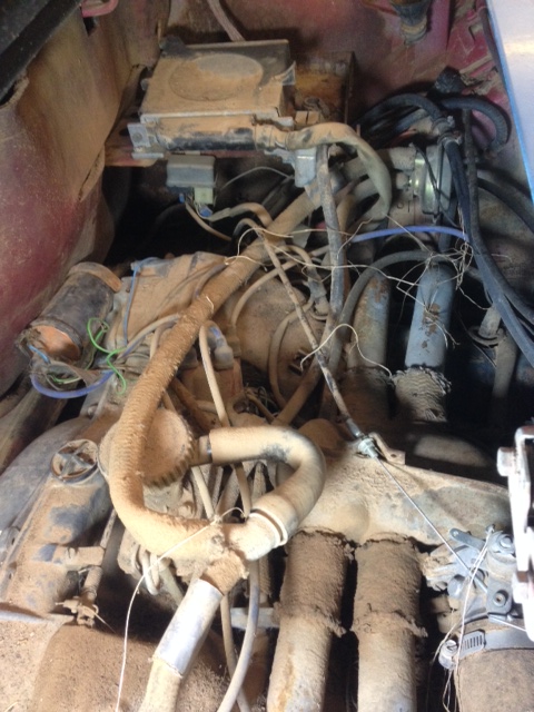

And here are a couple of the engine compartment on the parts car. I don't recognize the set-up here:
I don't think I'll have much need for heat or defrost since I'd tend to drive the car in pleasant weather, and I'm in the Texas Panhandle anyhow. I'm not sure I really have a need for nice heat exchangers, particularly if I'd wind up loosing horsepower. Thoughts?

And no, your eyes are not playing tricks:
The collision damage is why the last owner bought this car and then the parts car. He never got around to starting, so I happened on the cars while trolling Craigslist one fateful night. The pair were cheap enough it was really just 'why the heck not' money. Plus it'll keep me out of trouble (idle hands and all).
