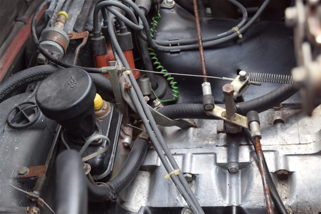

eman 928
Here are a few pics of the car i'm looking atClick to view attachment Click to view attachmentClick to view attachmentClick to view attachment[attachmentid=467
399
eman 928
One moreClick to view attachment
bandjoey

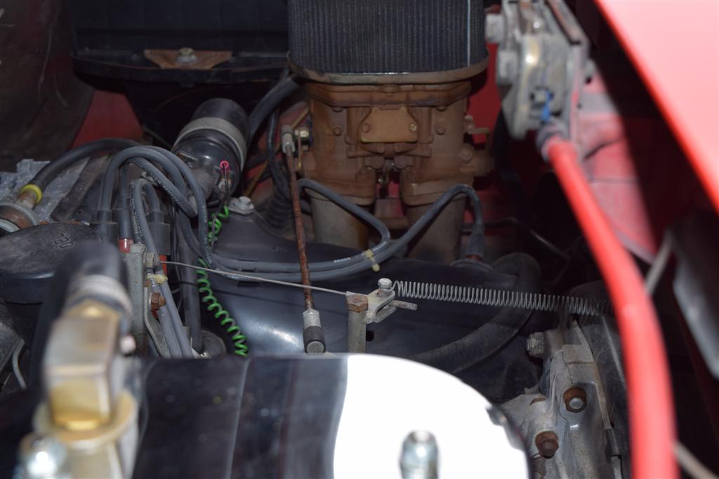

Unless corrected by an expert (i'm not!) The Carbs look like serious gasket gas leakage - brown stains all down the sides. Figure rebuilds into the price.
experts? is it a danger to drive the car with carb gaskets leaking out?
eman 928
QUOTE(bandjoey @ Sep 18 2014, 10:15 AM) *
Thanks, Bill. I might start a new thread about the carbs just in case the experts don't click on this thread.

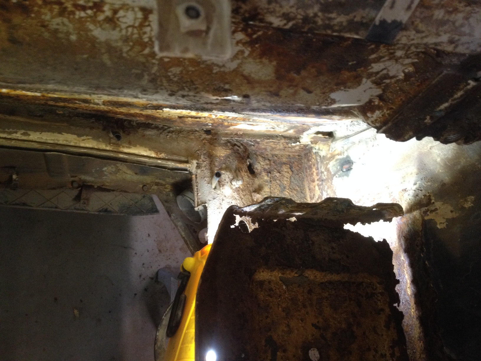

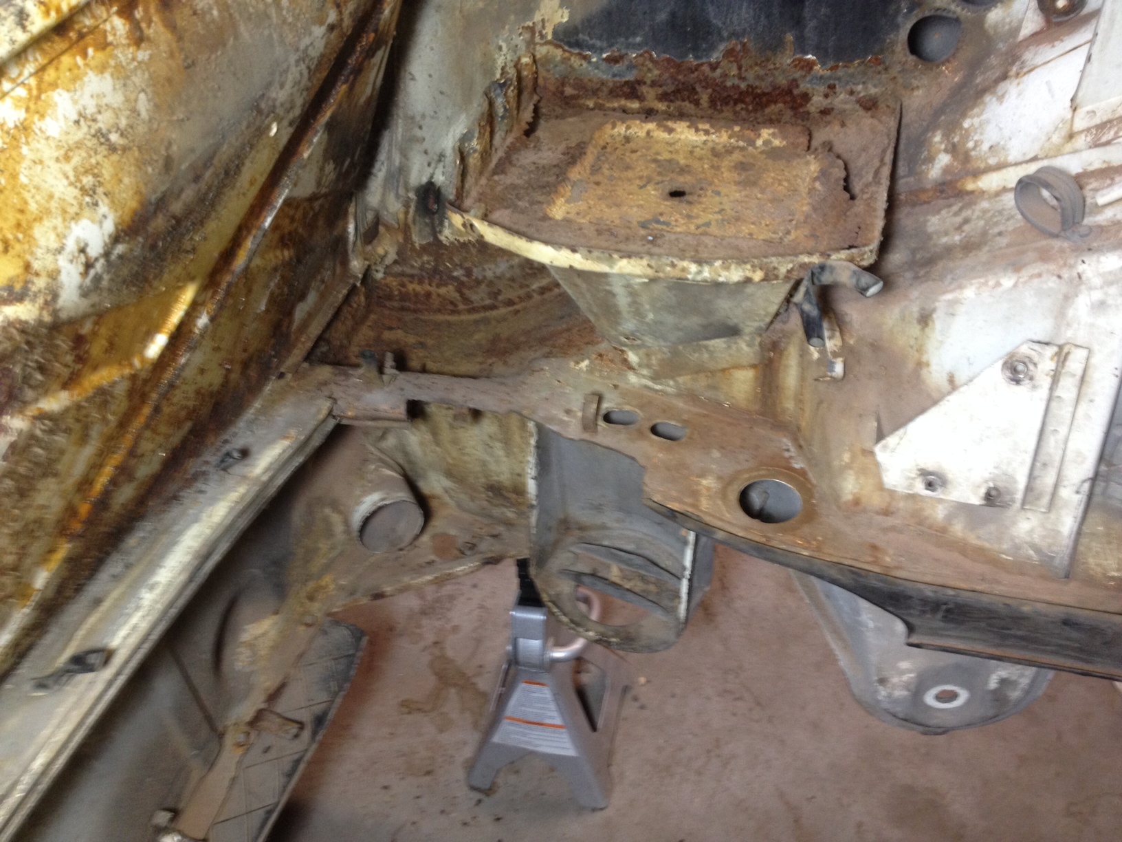

cn2800
Since I happen to have the engine out for a moment, I can clarify - This photo is taken of the engine compartment from the driver's side, looking right:
You can easily pick out the crusty battery tray. Below it is the inverted square cone of the battery tray support. Just in front of the base of the support (towards the front of the car) you can see a sort of ski slope-looking top of the longitudinal structural member. That's where you need to look. Here it is from above:
You can see how this longitudinal member forms a little pit at the bottom with the attached crossmember. There's a drain hole there, but it is easily blocked with leaves or dirt. You get the triple-whammy of water pooling, dirt to hold the water, and all the battery acid/byproduct shenannegoats. It can be a real mess.

914work
QUOTE(cn2800 @ Sep 18 2014, 03:24 PM) *
Great Pic & description ....AKA "THE HELL HOLE"

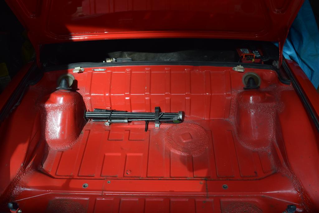

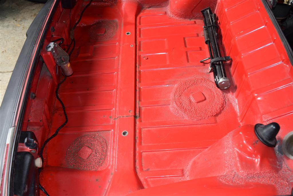

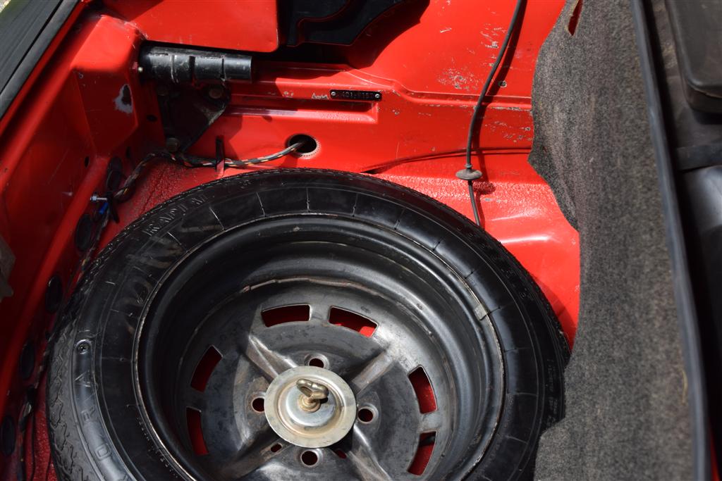

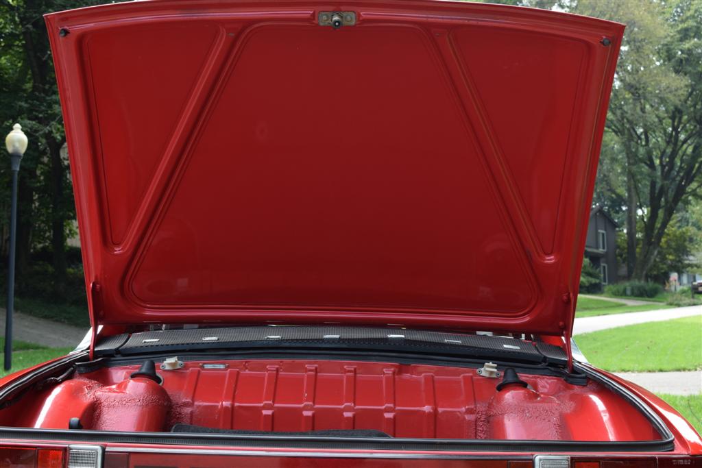

eman 928
Pics of trunkClick to view attachment Click to view attachment
