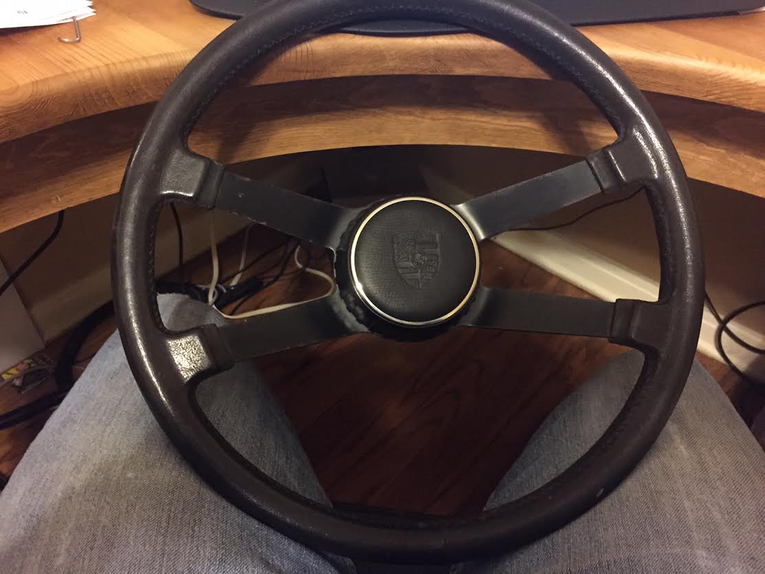

Is it possible to use a 912 hockey puck horn button on my 914 steering wheel?
Thanks
David
Oct 4 2014, 02:46 PM
yes. twists right on (an early car). Needs the parts from the horn pad to make the horn work on a mid or late car. I love the look.

I would like to see some pictures of this done please. Is this like the look of the original 914-6 GT cars...I am interested in something like that for my car using the original wheel.
Johny Blackstain
Oct 5 2014, 09:36 AM
Harpo
Oct 5 2014, 09:41 AM
Original but yet a substantial improvement to the original all at the same time.

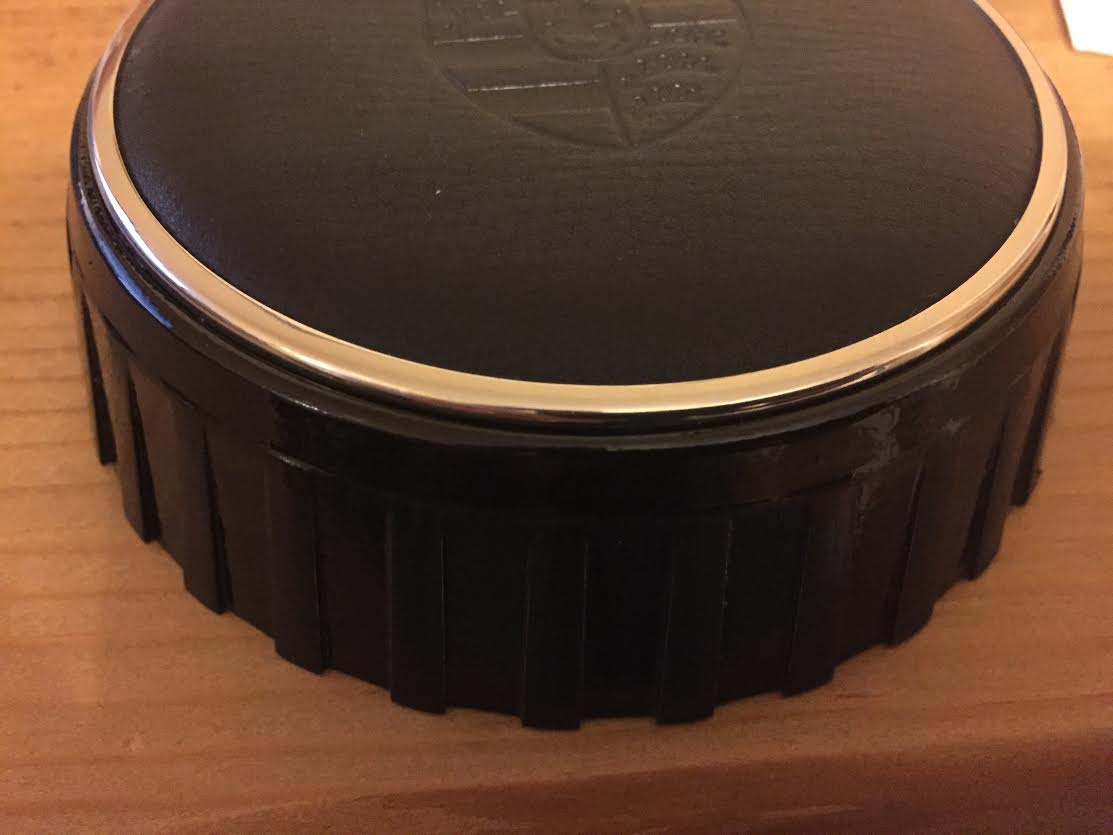

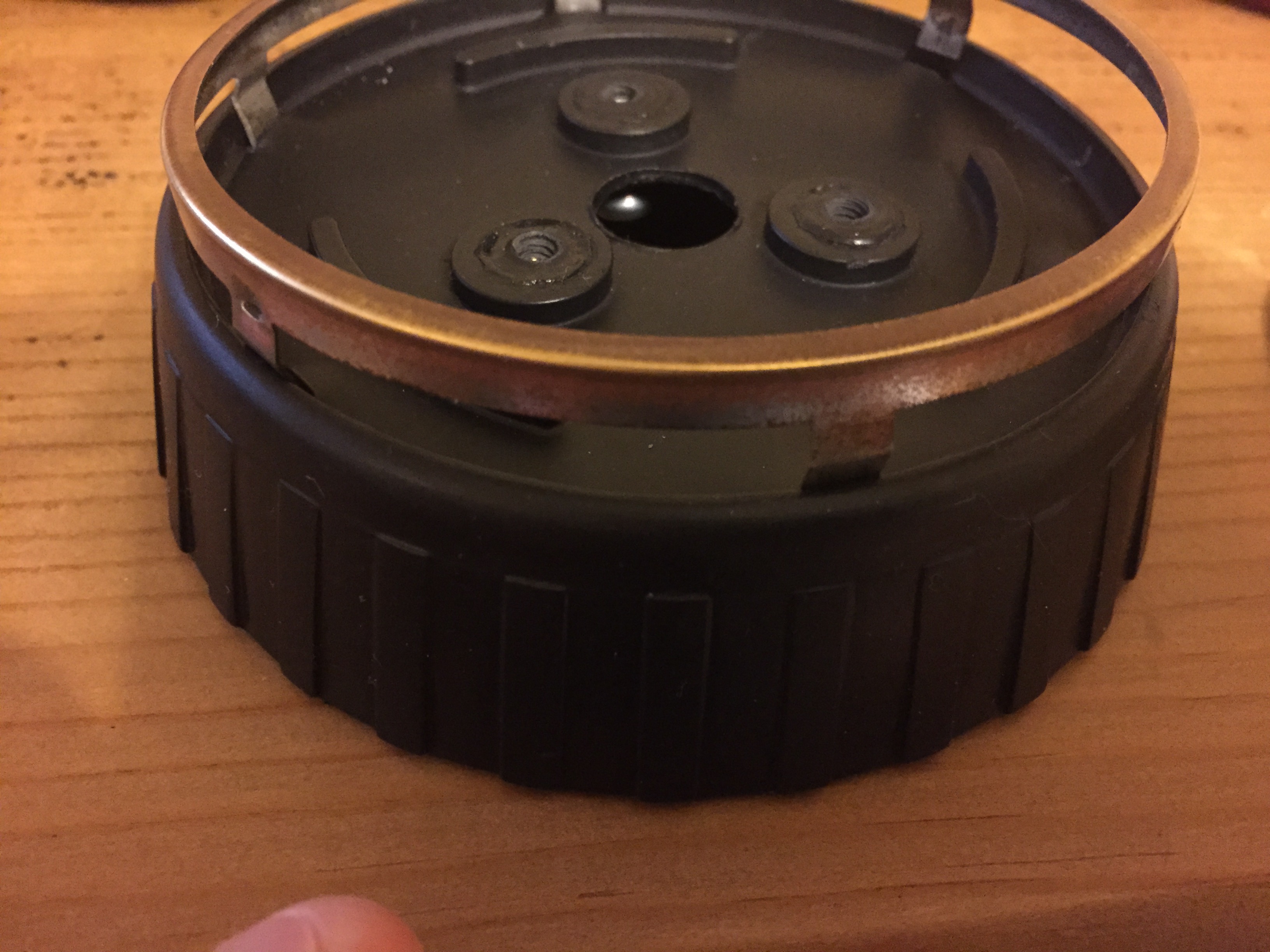

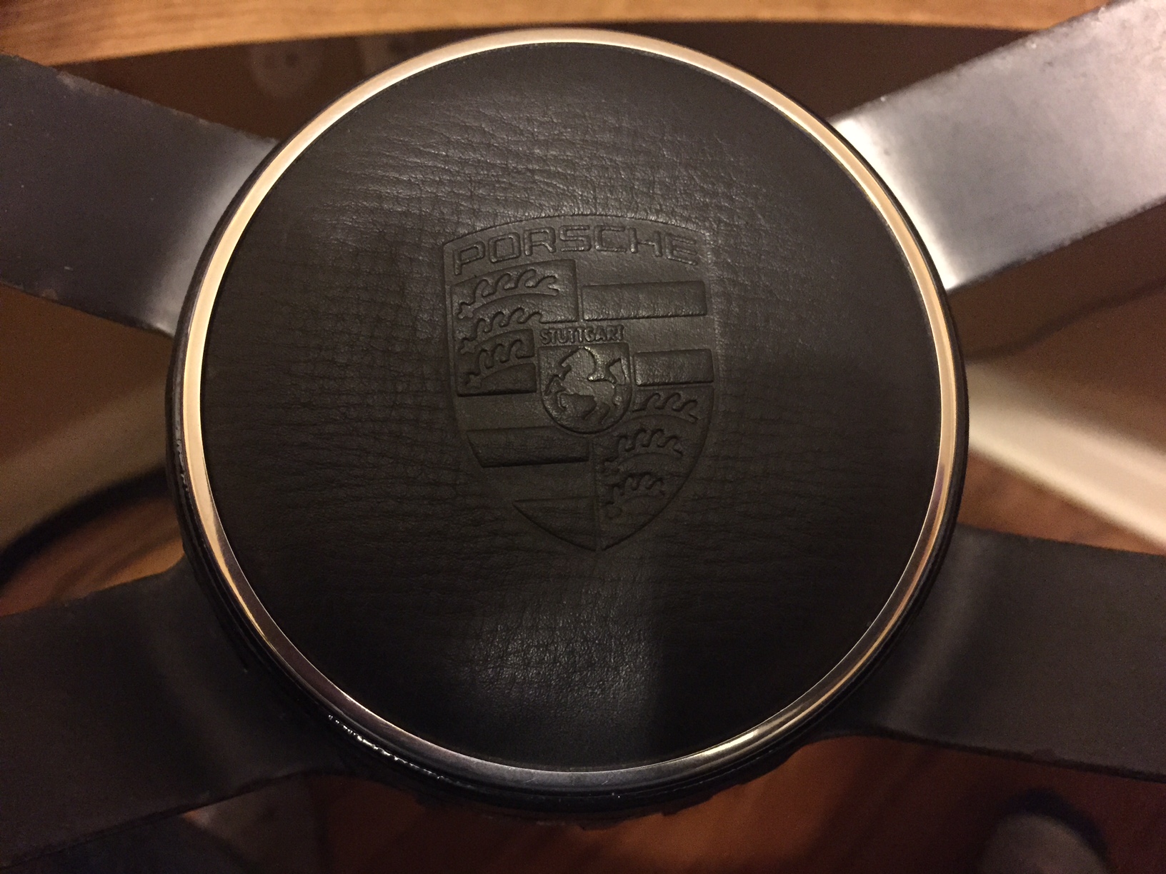

I ended up having the base made out of aluminum. I was going to anodize it black but I didn't want it to be that shiny so I painted it black and sanded it instead.
Click to view attachment Click to view attachment

Can you give me more details about your aluminum baseplate. I want one.
nsr-jamie
Nov 16 2014, 09:39 PM
Yes, this is the look I want for my car. I love it...so where can I find the parts to do it, my wheel is a 72 model. I get the puck or cup from an auction somewhere from a 912?? Are there any repros out there?

I purchased a very rough horn button off the samba. However is was in such bad shape I also purchased a new stainless steel ring and new leather patch off EBAY. I got the base from Mickey.
I put it all together but was not entirely happy with the way it turned out. So I had my brother draw it up so it could be turned on a lathe. The ridges around the perimeter has to be done on a CNC. This is the first one that I got back. I have a second one being made by a different source so we will how that turns out
I do have the original ring that needs to be rechromed, a new ebay leather patch and the base from Mickey that I will be posting for sale if anyone is interested.
I will post the drawing up if anyone wants to make their own base.
