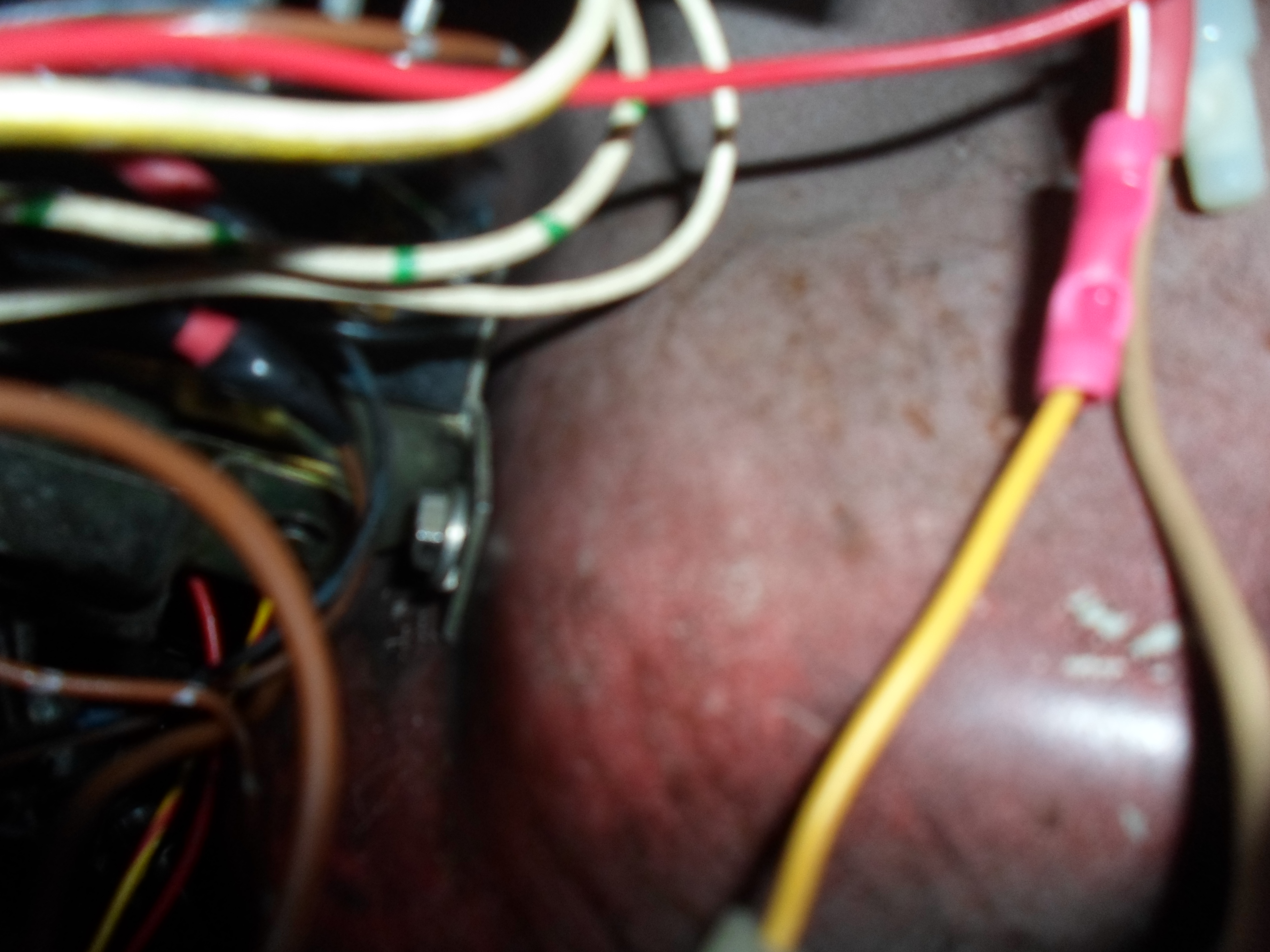

Can someone kindly tell me how I remove the climate control assembly from the dash? I've seen pictures of it out but I can't find any references to how it was done. I've got the bezel part way out but it seems to be stuck on something and if I pry any harder on it I'm afraid I will permanently bend it. I can't see under the dash if there's anything hold that and the actual control assembly in place or if it's supposed to "pop" out.

There's a bolt at the back holding it to the body sheet metal.

Cool, thanks Paul. Where is it in general? I've looked around and don't see the bugger.

Gotta get your head really in there!!! Here's a pic:

Thanks Paul! I finally see the SOB! I was looking in the wrong spot. I figured it would be on the dash sheet metal, but it's hooked up to the far wall (but you knew that already smile.gif ).
