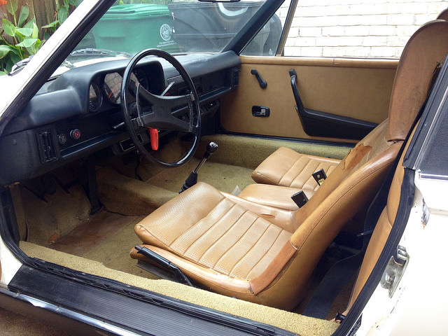

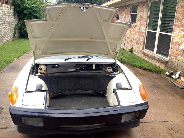

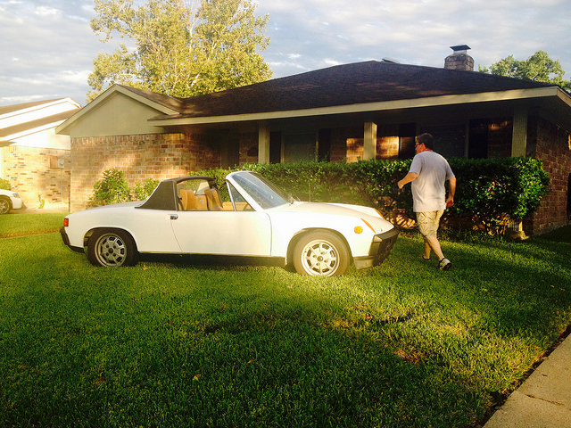

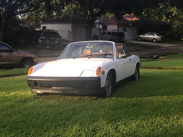

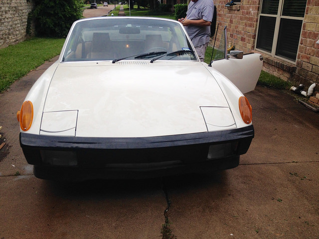

Thank god you bought it before I did! How can I explain buying two in one week to my wife...
Looks like a good one. Congrats and good luck!

Looks like you got a good car to work with have fun
7TPorsh
Oct 16 2014, 04:15 PM
1976? You sure? Older bumpers.
pilothyer
Oct 16 2014, 04:35 PM
Looks to be pretty nice and for a 76 the bumper backdate has been done for you too.
