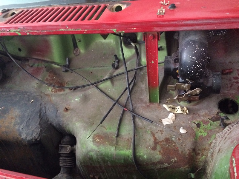

I've made a start on removing the hacked up loom & vacuuming all the loose rust out. Its better than expected (as I bought the car only from pictures)
it needs;
new hell holes
back of floorpan & bottom of firewall
boot
and that's about it - the rest of it looks (at this stage) like only surface rust - the suspension consoles are solid as is the majority of the front boot - again, only surface rust there ...
the windscreen will come out next to get access to pull out the dash so I can continue to remove the loom.
i'll be making up a new loom for it.

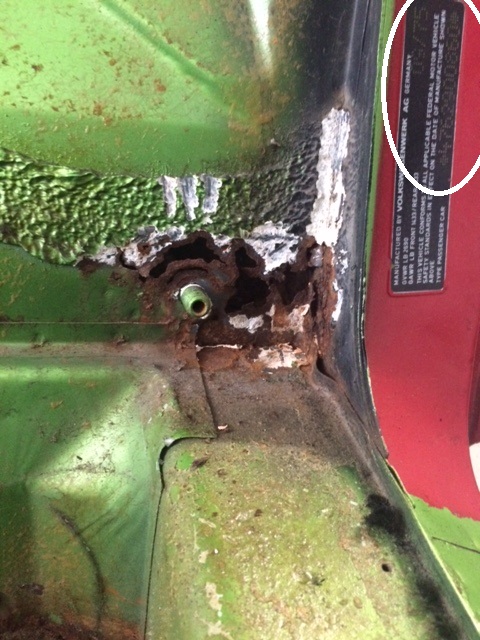

and yes, it looks like it was a US car - has the tag on the windshield frame & the side repeaters.

Chris H.
Is your car titled as a 1975? Because it looks like it's a '76.
Which explains the color thing. It didn't look like a '75 color but lime green was '76 only. Now that we know it's a '76, it's most likely lime green after all (similar to viper green).

Chris H.
It's the VIN number that tells you what model year it is.
It starts with:
47 is the model number for the car
6 is the model year
Your car, although built in 1975, is a 1976 model. If you take a look at the members VIN numbers you'll see that to be the case with a few exceptions (like Kent's).
barrym
