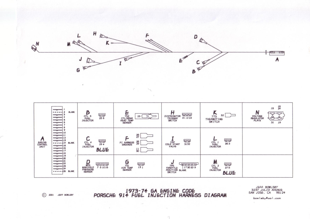

I know there have been several threads in the past about this and they all seem to say the same thing. Something along the lines of, "oil temp wire runs along front of engine, up through the tins and plugs in to a connection near the oil cooler." I'm thinking I'm missing something totally obvious but I can't, for the life of me, find where the oil temp sensor plugs in.
I've looked at these two wiring diagrams but they don't show anywhere for the oil temp sensor.
IPB Image
IPB Image
Can anyone help me?! This damn thing is driving me mad.

Thanks guys. I had been looking at the ecu and relay harnesses the whole time. Found it finally. I'm pretty sure I would have found it much earlier if someone hadn't cut the wire with about an inch left sticking out of the loom...
