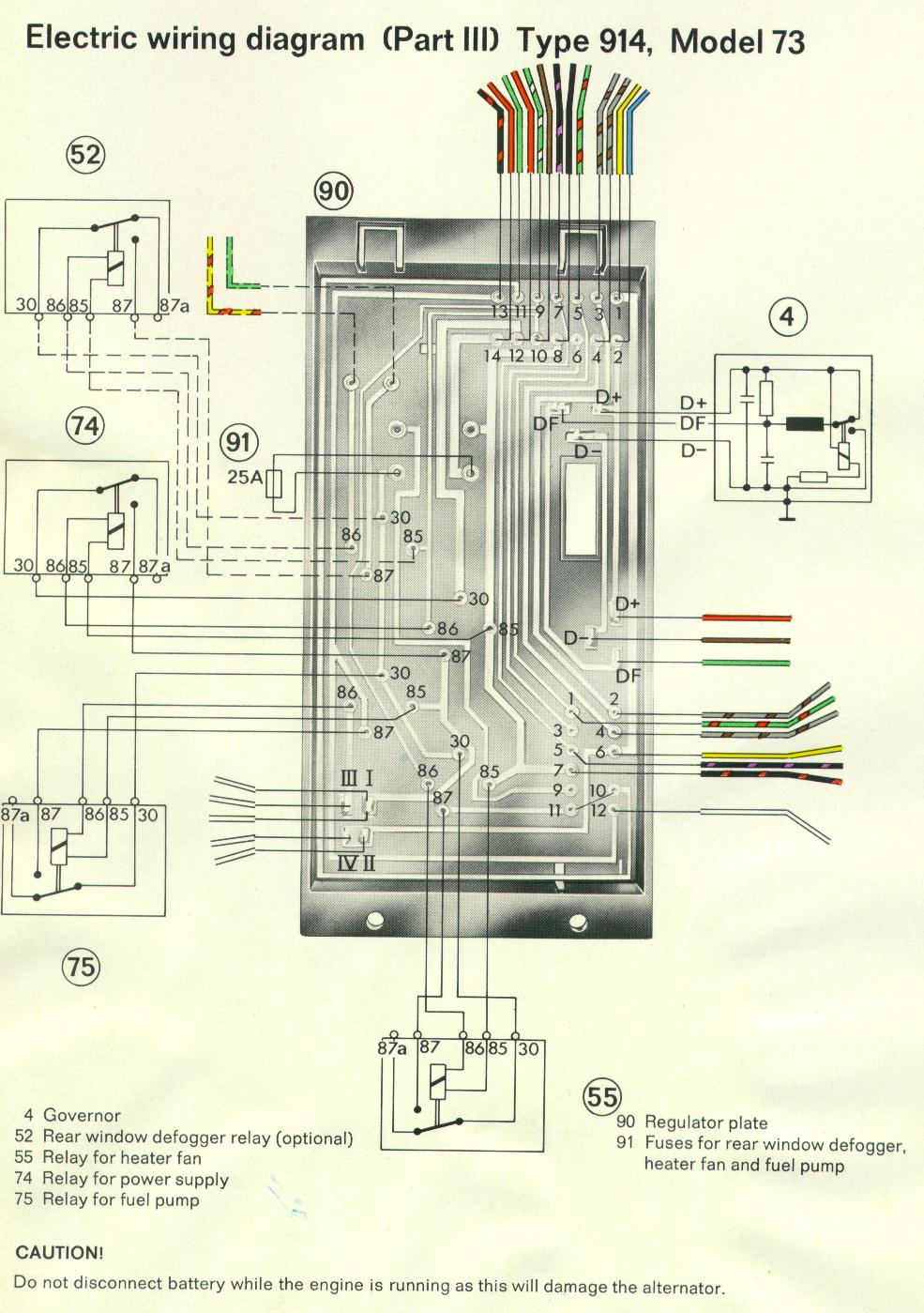

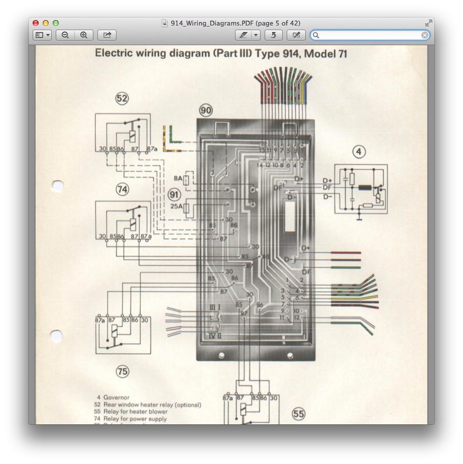

The 71 relay board:
The 73 relay board (should be identical for 73+) :
IPB Image
Check the wiring diagrams (on Pelican, or in Haynes) to make sure what each wire does. The color coding should be pretty consistent, but you want to make certain.
